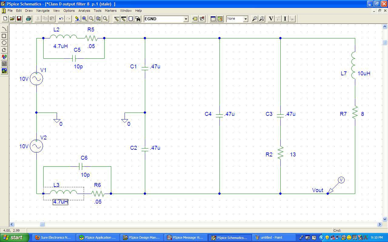

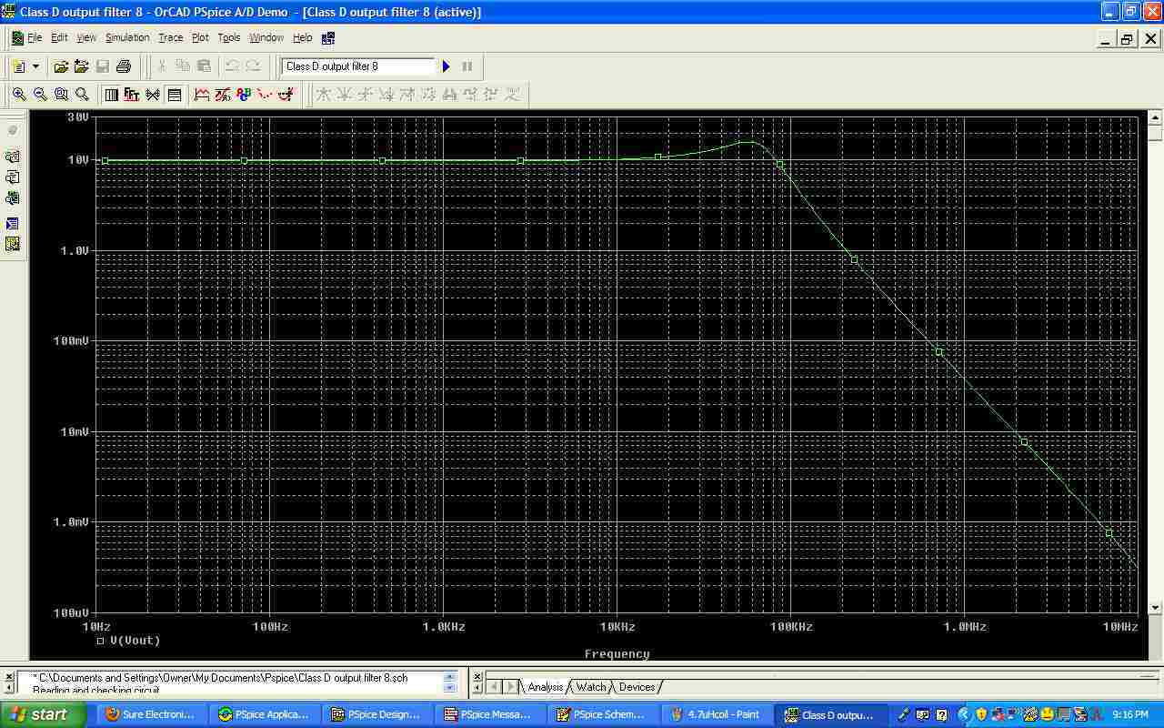

I have replaced everything. I think I may end up using these coils instead of the air cores as they sound very close when using a smaller value such as the 4.7uH and have zero RFI emmisions and are easier to install as they are the same size as the stock coils.
http://www.we-online.de/katalog/media/pdf/7447709004.pdf
I have 6.8, 4.7, and 3.5 to play with. The 6.8 are definitely more opaque than a 7uH air core but the 4.7 and 3.5 are in the same ball park in transparency.
I'm still trying to decide if the 3.5 is more transparent but starting to get a little too hot in the high treble.
Of course, I am using the price/performance champion Dayton Foil capacitors.
Parts-Express.com:*Dayton DFFC-0.47 0.47uF 400V By-Pass Capacitor | polypropylene capacitor polypropylene PAC PA low pass foil film and foil dayton capacitor caps cap ac 47uf .47uf
I tried .22uf for the common cap but went back to .47uf all around as it sounds better and will be cheaper to order a larger number of caps all the same. I use 2-5 of these paralleled for the input cap as well. I've tried tens of different mid priced caps over the years and these are clearly in a class by themselves as the most transparent.
Here are the circuit and simulation.
