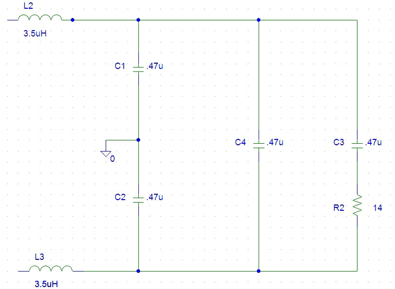

yes I saw it, but a bit complex, how about just swap inductor to 4.7uH (or 3.9uH as you suggested), and replace all caps to 470nf, then add Zobal (470uf and 15R)
Sorry about the confusion. That is correct. Just the two coils and the three caps plus the Zobel per channel. All of the caps are the same at .47uf. The other components in the schematic are "virtual" and are just for the simulation to model better. I will post a schematic of just the actual components when I get a chance to change it. The large Dayton caps fit underneath the board and the zobel is on the top.

Schematic for output mod
Here is the schematic for the output mod. The 3.5uH coils will give amazing transparency but the difference between transparent and glare is 1 ohm at a time in the zobel. Using the 3.9 or 4.7 coils will be more forgiving.

a question about the coil, if such a low value 3.5uH is used for those tiny hi perm shield coil, than perhaps the same low value on those high quality high perm coil would give even better result. eg. MPP core with 125 perm.

I think I am done with coils. Done with amps! Done with my source (modified DCX2496). Time now to move on to the speakers. Active cross, constant directivity, dipole array, 4 way.
