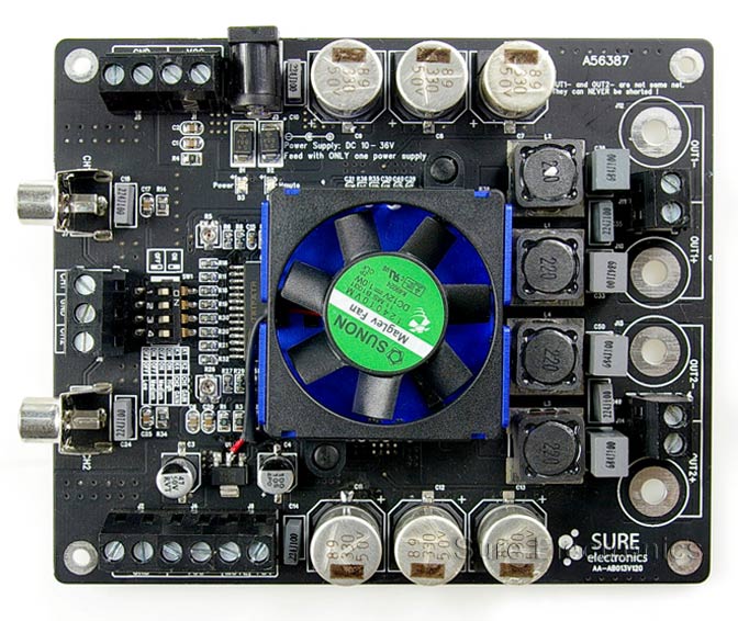

i'm giving serious consideration to the sures then. i love the look of the black SYMMETRICAL motherboard with blue capacitors (?) as i plan on mounting it under plexiglass with LED or cold cathode lighting. i might go the UV route too as i was looking into LED PC fans for a tail light, but translucent hot pink sounds better and would look cool on the black & blue amp.
i'd rather use the screw connectors as the wires will be going straight to to speakers and the banana plugs would get in the way of the 80mm exhaust fan i'm planning on. from what i understand, i could wire it directly into the amp's 5v mute terminals without needing another set of batteries just for the fan. is that correct? i'd rather undervolt a fan for quieter operation anyways.
i'd like to run it with 24v of li-on batteries as that would mean i could use 4 x 3v per side underneath lightweight 92dB pyle outdoor speakers. i'm thinking of putting the batteries under plexi too and probably adding some blue EL wire stripes between the speakers and batteries.

You probably should tap 12v off the batteries for the fan so the LEDs get full brightness. I don't think the noise will be a problem on a bicycle. It's a bit different than lisening in a quiet room.
If you do go 5v with the fan, you connect to the 5v and Gnd terminals (same Gnd as the 24v), not the Mute. They're already there with screw connectors, just hook it up, no soldering.
My storage caps (round) are silver and my signal caps (retangular) are gray. Sorry. I think some people's upgraded signal caps are blue.

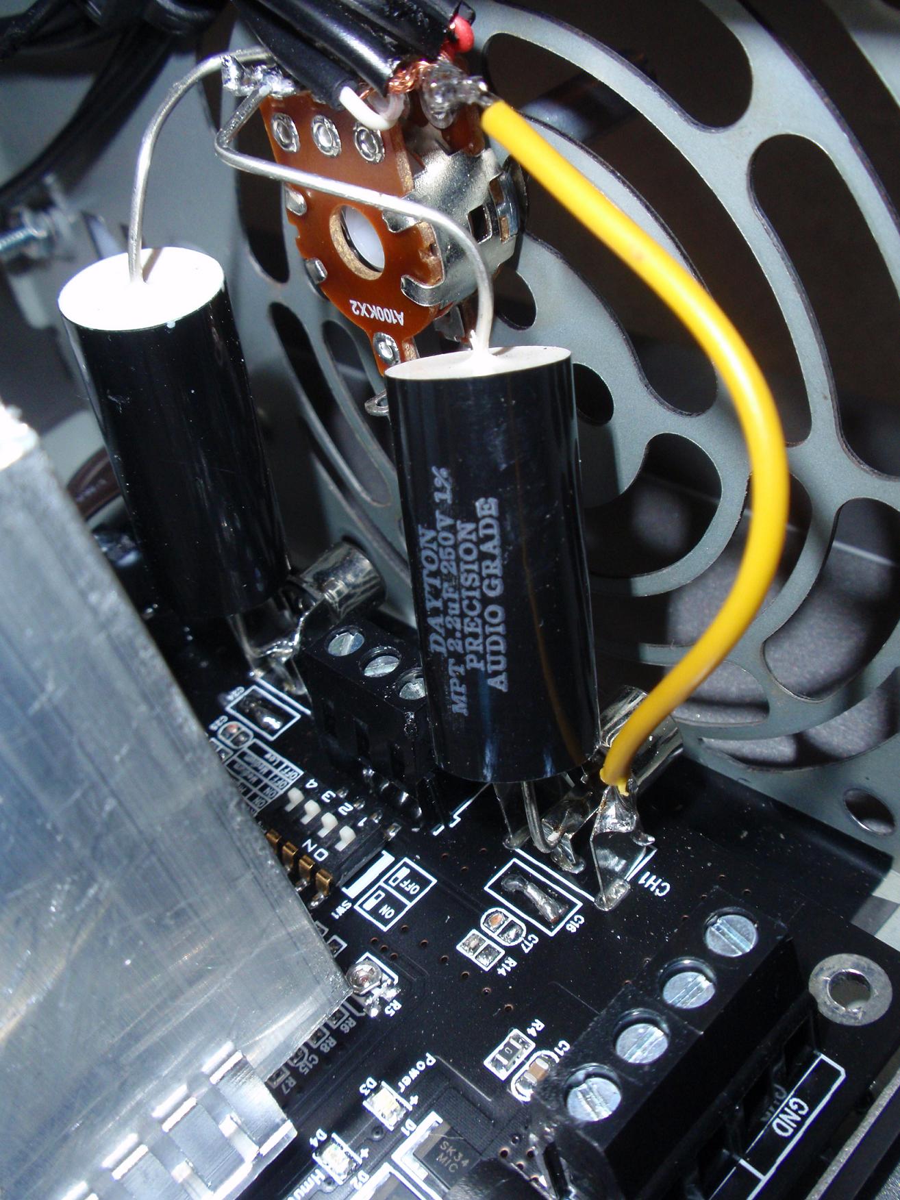

3. Now all the components to modify the circuit had arrived. I changed the following:
a. input caps to Sonic caps, 2.2uF in parallel with 0.1uF, removed the existing caps(1.0uF and 0.1uF) as specified by Audio1st and also the input 22K resistor. More importantly the input suppressor? located underneath the board, this suppressor must be removed for the unit to work properly.
b. removed all the 6 power caps(220uF each) there were very light indeed, replaced them with panasonic 2*1500uF(one in each rail) used by Audiosector.
c. Used a 50k pot from gigaworks similar to the one ordered by Col. It was a SMD resistors connected and make it into a audio log pot.
The bottom line is it sounded like a different amp., very clean and open airy, throws a large sound stage. I own many amps before, inclu. chipamp(LM3886 and 3875) and tubes and solid state. This one sounded very good indeed comparable if not better. If I add up the costs, it will not be over US$100 parts incl. Sure unit, battery, caps and pot. A bargain.

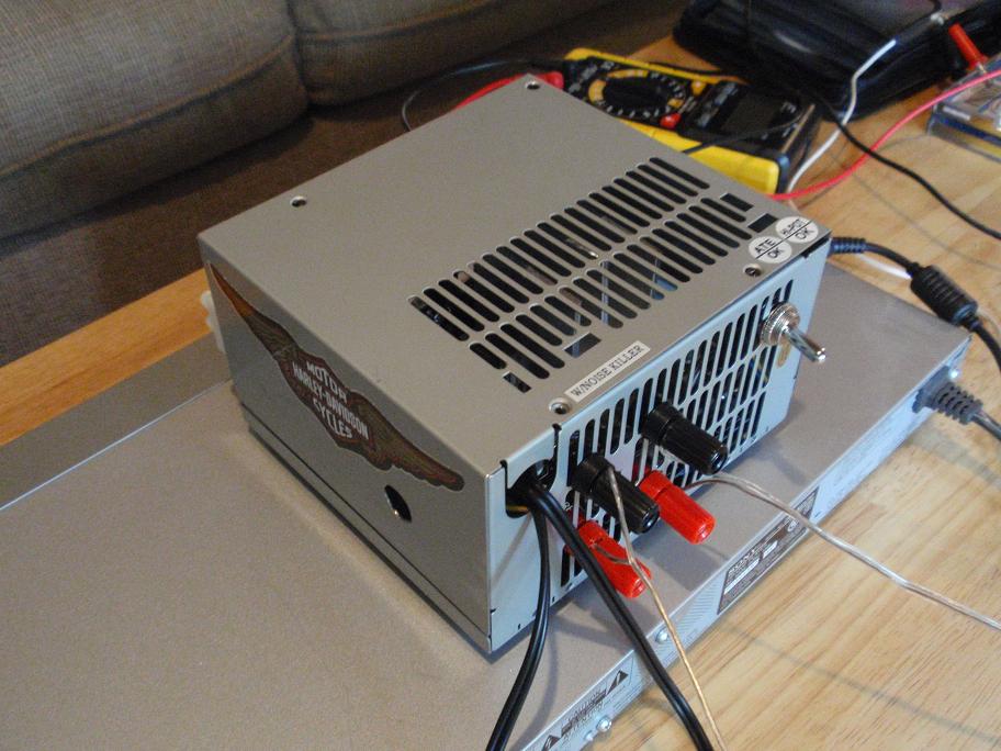

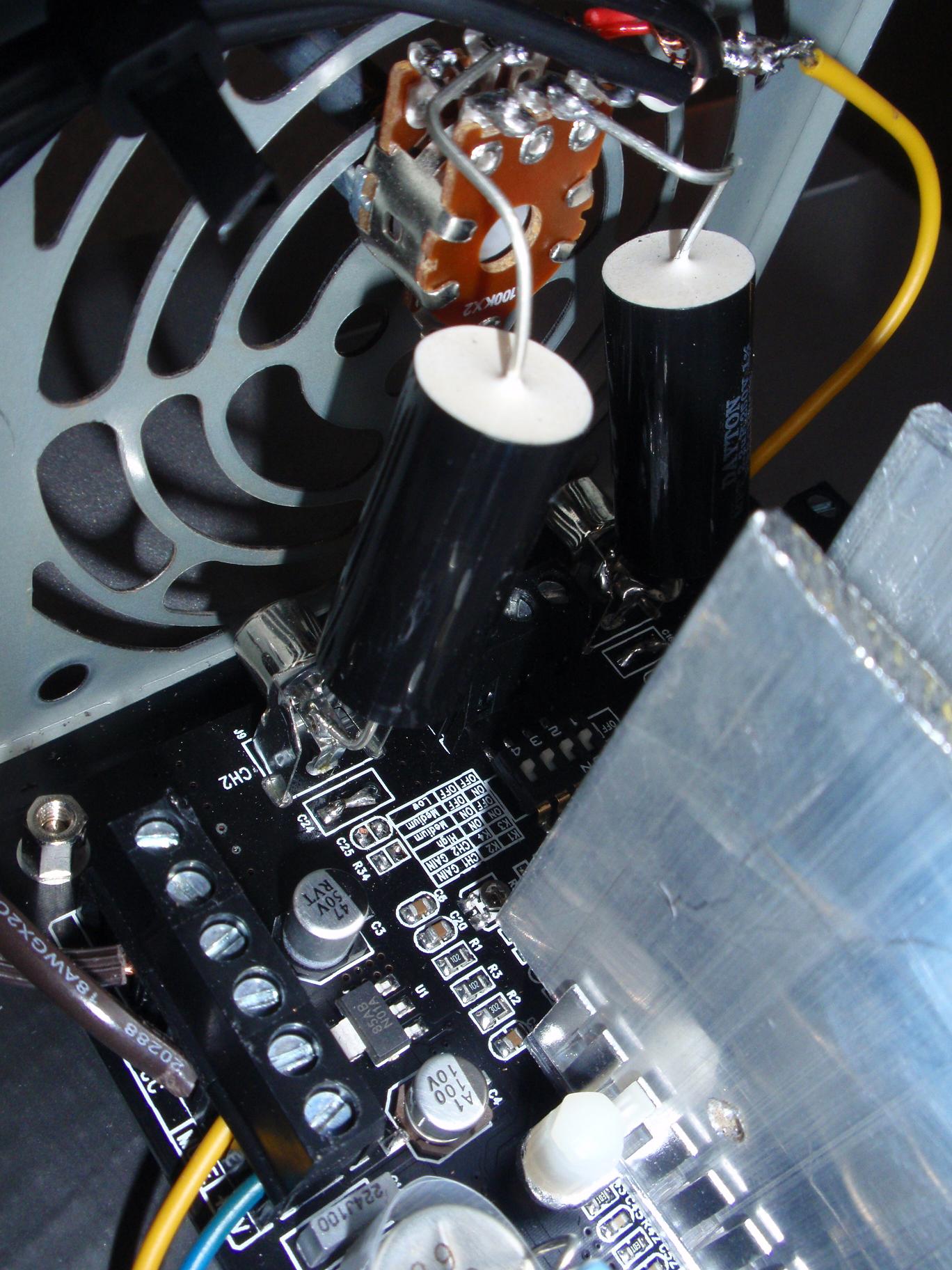

I made the mods and used an old PC power supply as case. I'm VERY happy. :cloud9:
Question: The only issue is that it plays very loud (if I turn the pot it plays even louder! 😛 ). I'm using a Radioshack 100k stereo pot. The 4 switches are set to low. Would I need to add more resistance?
Update: I added photos to show more of the detail of the input side. It's very loud, but very nice detail with my cheapy sony dvd player. I'm currently using a discman to have better attenuation.
