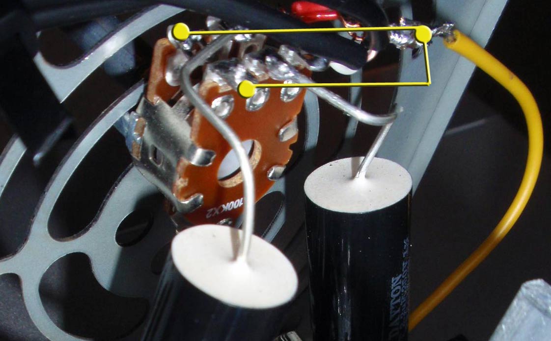

Hello nrg2009.
I can't see a ground connection to your pot, the middle terminals connect to the input caps, the end terminals connect to input, (source) and the other end terminals should connect to ground.
Audio1st,
You may be right! I used the yellow wire to ground. On the incoming wires I tied the grounds together (L+R), and I connected the yellow wire to the board on the ground of one channel. Is that what hosed me? I should clean up the soldering on the pot and make it more permanent.
Thanks!
Audio1st,
No, the voltage did not drop at all. I had tried it with 13.8V, 15V, 17.7V power supplies, measured the voltage at each terminals and it was fine.
Only when I added a power cap to any of the terminals (screw-in, power rails and even off board by the power switch). As soon as it powered up with an extra power cap, I would loose channel one (no power at all). Removed the cap and everything was fine again.
I am baffled!
Even tried to remove and bridge D1 and D2 (voltage protection caps, i think), no luck!
Any ideas?
