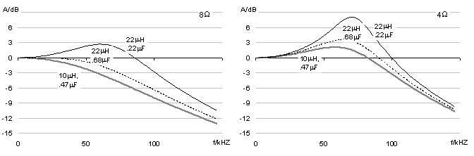

PS, would changing the 680nF output caps to 220nF caps work?
Did some more pondering.
Don't mistake me for an expert, but I looked up the properties of a LC-lowpass. You can determine the transmission of such a filter as a function of R, L and C.
Now, the output stage of the tripath circuit differs from a simple LC-lowpass and I am not able (for now...) to determine the transmission of such an array. Certainly the resistance, inductance and capacitance of the speakers play a role in the performance of the output.
Attached you find a graph that displays the transmission in dB over the frequency for a simple LC-lowpass. It becomes clear that depending on the resistance the choice of L and C can be better or poorer even if you hit the same cutoff frequency.
I plan to use my amp with 4 Ohm speakers btw.

One thing that I find intriguing is that DIY'ers always quote the Tripath reference documents as if they are some carved in stone statement from god that must be adhered too. Truth be known they are only an estimate set of values that are to be used as a default to improve from. What if the Sure Electronics designer was aware of this and had taken that into consideration in their design? Maybe they had improved on the reference documents and all these mods referring back to them are just a digression.
col.
Of course Col is right. Tripath’s data is not carved in stone. These are all compromises to balance various factors. Tripath tells you what you need and gives you a solution that will work. It’s not the only solution possible. For example, when you read the Tripath info about the output filters on the spec sheets for different Tripath chips, they talk about the same problem, but even Tripath comes up with difference solutions on different datasheets.
The Tripath chips, like all switched amplifiers generate a lot of electrical switching noise, most of it above 100kHz. While this is well above the audible range, it can modulate with other frequencies to make audible distortion. Plus, it just isn’t good to send the noise along to speakers sucking up watts and heating your voice coils. So, Tripath recommends a second order filter at around 80kHz.
We’re lucky with Tripath because their switching frequency, while variable, is usually above 100kHz, which is higher than some of the other class D amps. The higher frequency means we can use a simple second order filter that is cheap and doesn’t harm the sound much.
On different datasheets Tripath recommends LC combinations of 10uH/.47uF and 15uH/.22uF. Sure, apparently, used 22uH/.47uH. These give the following filter points:
10uH/.47uF = 73,412.76 Hz
15uH/.22uF = 87,611.99 Hz
22uH/.47uF = 41,148.57 Hz
I replaced the Sure 22uH coils with 10uH, but I have not yet replaced the caps. That means I’m currently running with a filter point of:
This is one of Tripath's recommended combinations. But when I replace the caps, I’ll use .33uF instead, which gives me a filter point of:
10uH/.33uF = 87,611.99 Hz
That’s the same value I’d get if I had used 15uH/.22uF.
All of these combinations work just fine. Sure may have chosen a lower frequency to filter out a little more noise, at the risk of rolling off the top end of the audio spectrum a little – a very little, less than 2dB at 20kHz for 4 ohm speakers and effectively none for 8 ohm speakers. And remember, we're talking about the tweeter here. Even if your tweeter is 4 ohms, chances are your crossover has a resister on the tweeter bringing its effective impedance near 8 ohms, maybe more.
Since I’m using a 4 ohm tweeter without a crossover (I have an active crossover), I’m pushing my filters up a little higher. But only for the psychology of it, since I can’t hear anything above 16kHz anyway.
So Col’s right: don’t get crazy over the output filters. What Sure did works just fine. I didn’t replace my coils to move my filter point, I did it to get better quality coils. Upgrading the coils gave me a chance to play with the filter frequency, but that was a fun side effect, not the reason to do it.

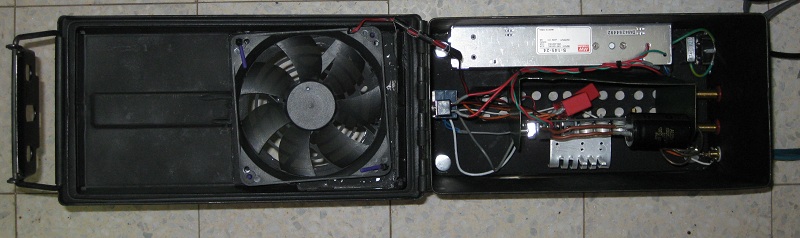

Yeah, same here. I am really impressed with this little 2*100W. I had one of the old 4*100W, you can read about it here:
http://www.diyaudio.com/forums/showthread.php?threadid=111147&perpage=25&pagenumber=1
my 4*100W build:
http://minirig.org.au/2008/03/15/minirig-sure-electronics-class-d-4x100w-amp-project/
the 4*100W was an amazing little amp too but it had misgivings, mainly the noise floor was very high. I ended up replacing it with a 41hz TAA4100.
I think Sure Electronics have learned a lot since they started producing these little modules and their knowledge has culminated into the 2*100W. I particularly like the fact that you can basically look around the house pick up any old DC power supply over 12v, plug it on and it works! But not only does it work it produces excellent sound with no hiss 😀
Hats off to Sure Electronics.
