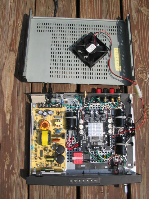

I did some changes on the cooling on my setup...
I removed the extra fins on the heatsink, mounted a 12V fan (running at 5V) on the lid of the case, blowing directly to the chips. The temp on the chips have dropped down to room temperature.
