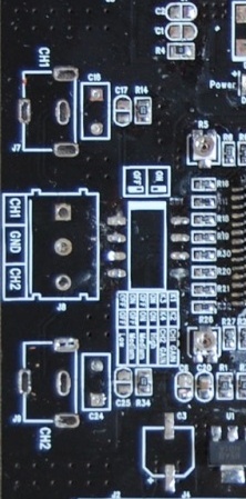

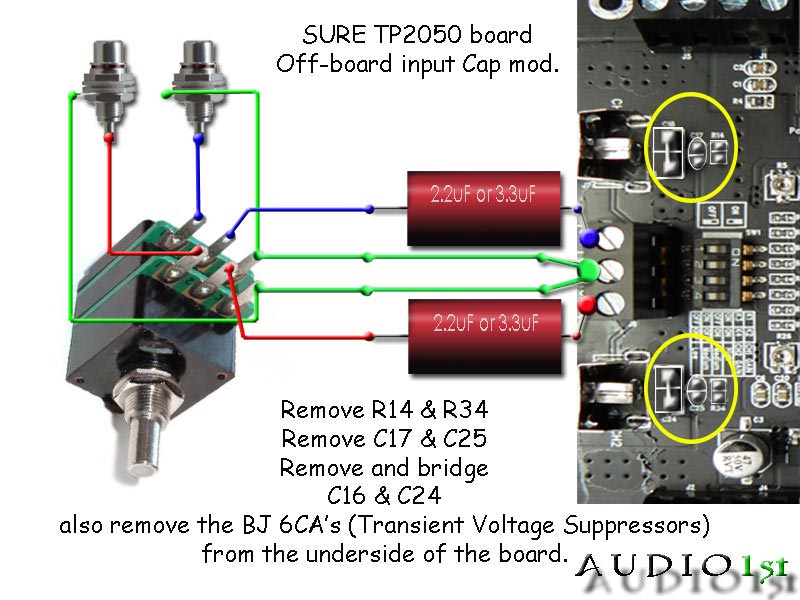

Could anyone (may be Audio1st) confirm this for me, please...
In order for me to use the input caps off board (as in the Sure T2024 board picture), I need to remove C16 and C24 and bridge them, C17 and C25, and finally R14 and R34 then connect the input caps between the pot terminals and the screw-in input terminals (CH1/GND/CH2). Of course I am talking about the TK2050 board using the T2024 pix as references.
What about the two caps under the board?
I have read the threads and still am a little confusing.
Thanks in advance.

Gychang,
If you are working on the Sure 2024 board, you'd better off using the attached diagram. BTW, go to the Sure 2024 thread, there are tons of info on this subject.
Picture...courtesy of Audio1st.

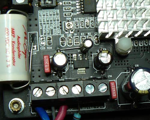

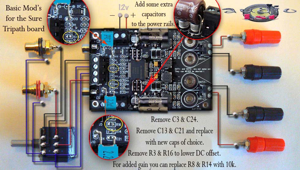

Audio1st,
Per your picture, you have replaced C3 and C4 with newer caps, could you tell me the values of these caps? I measured the voltage and found out that C4 was only about 5V.
Are these mods recommended?
Thanks.
Cheric
Hi Cheric
I just went mad and changed all the electrolytic's for the same value Panasonic FC or FM. Because I did everything at once, I have no idea what effect each individual cap had on the final sound.
I am a bit lazy and didn't want to keep taking it apart and changing one bit at a time..
C4 is after the 5v regulator so I used 100uf/25v and C3 is before the reg so 33uF/50v, not the same as in the SURE pdf, just what I had in the parts box.
Something I tried that made it sound worse was adding a 680nF/10r Zobel across the output, this caused a lift in treble output, settled for 220nF/10r, all fine again.
Having used it for a while now I am still blown away with every CD I haven't previously heard through this amp.😀
