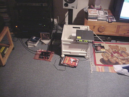

At the moment I am listening to the Sure Electronics amp board.
The board is connected as is, so no housing and using my Delta Elektronika ES 030-5 (switching) power supply.
Noise or hiss are on my Dynaudio’s no problem, its not as quite as it can be, but at the listening position its no problem. I started directly with my best disc in all ways, Arcadi Volodos Etudes Tableaux – Live in Carnegie Hall (solo classical piano on Sony), and this is good. Soundstage is there, drive is there, the ‘live’ noises can be heard and it goes loud and is not nasty or harsh at all. This piano recording a very dynamic and my Dynaudio’s are good company, at least if they are in good company. And they are, that’s for Sure.
I do know how this recording can sound and what’s missing is the full body of the piano that is ‘normally’ there. But if you would have nothing to compare, I would have nothing to say. Bass is also a little underdone in terms of what can be done.
I believe a good sounding amp with power and good soundstage. It maybe fails a little in colours and body in the above mentioned setup. For Sure I going to look now for sme decent power supply and housing.
Wim
Attached photo is taken with my mobile phone with not too much light.
