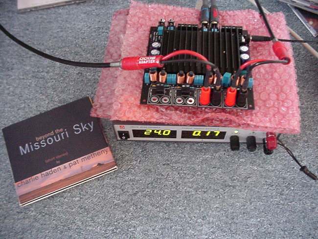

Some better photo of my listening test set up.
You don't hear me say this is the best amp I had in my set, because it is not, but despite of its lack of good measure results, it sounds very confincing.
Wim
Attached a better photo of how I listen to it now days, a fancy case is on its way.
