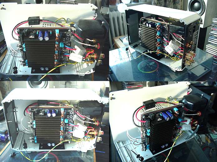

So my “Sure D” is working and playing now for some long time. Because it does have potential I did made it complete using a housing and power supply.
The power supply is a Mean Well SP-100-24. I am using 2 channels so this 100W 24V will do to my opinion. I am using 84 dB sensitive Dynaudio speakers and it works great, it goes in living room loud if necessary.
The SP means that the switching power supply is ‘running’ at 67 kHz and not like the S model as can been found on Ebay at 23 kHz. It worries me that this 23 kHz is so close to the audio range. This carrier frequency will also be available on the 24 DC voltage, even it is low amplitude. I have no idea if terms of sounds it matters. I had some left-over SP supplies from work, these were use to upgrade some medical equipment because the original ones ‘died’ after a year of use.
The noise still worries me. At 1 W I can measure only -42 dB and that is low. In the late evenings I can hear the noise on my sitting position, this nees atetntion some how. In the past I had some serious hum problems in my amps, but this noise seems from the amp itself and can’t be eliminated. Next week I will try replace some caps on the board, and see of this will bring something. In a test setup on my workbench I can’t get it good either, I did try 3 different PSUs including a normal non-switching high performance lab PSU.
Using this SP-100-24 I measure 50W into 5 ohm at 0.3% distortion. After this it will clip very quick in its PSU limits.

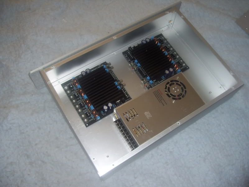

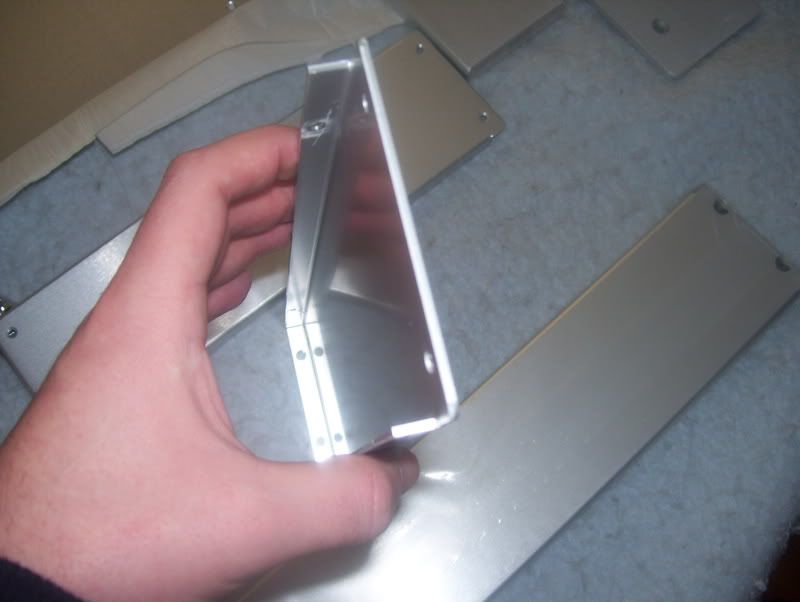

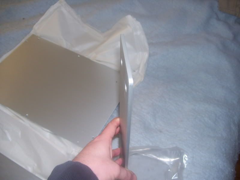

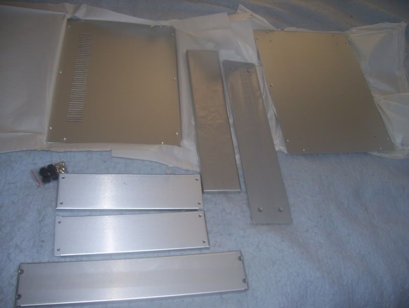

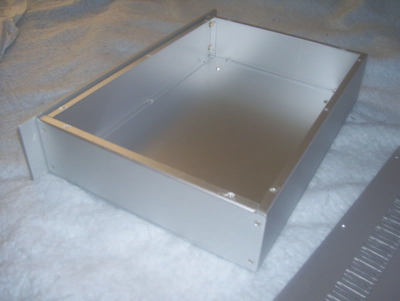

So I was finally able to pick the chassis up from the Post Office and I'm impressed. everything was wrapped up, only one scratch on a panel and i can live with that (its on the bottom anyway). Very easy to put together, all the hardware was included (no instructions, but pretty simple to figure out. The panels are pretty thick and all the threads were good. I was very pleases how thick the front plate was, very nice. I figured I'd throw some pics of the setup.
Here is everything that was in the package. I was slightly confused why there were 7 panels....
this is a side shot showing the thickness of one of the side panels. all the panels, other than the front piece, were this thick. you should also be able to see the threaded nuts that are in place.
this is the front panel. very impressive (well, at least to me).
everything but the top assembled. as you can see, the front panel is just for "dress" and bolts to another panel behind it.

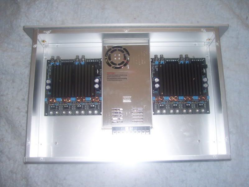

and now everything temporarily in place. i'm trying to see how to layout things inside. any recommendations?

SQ Kid said:and now everything temporarily in place. i'm trying to see how to layout things inside. any recommendations?
I would position the SMPS in a way that you can cut out holes for ventilation, it's going to need some airflow definitely.
Unless you plan on adding fans to the chassis itself, then you can probably position it whichever way you want.
If that was me though I'd be taking apart that SMPS, do away with the fan and mount all the heat-dissipating components of the SMPS on a heat sink at the back of the chassis. But that's just me, I like to avoid fans where possible.

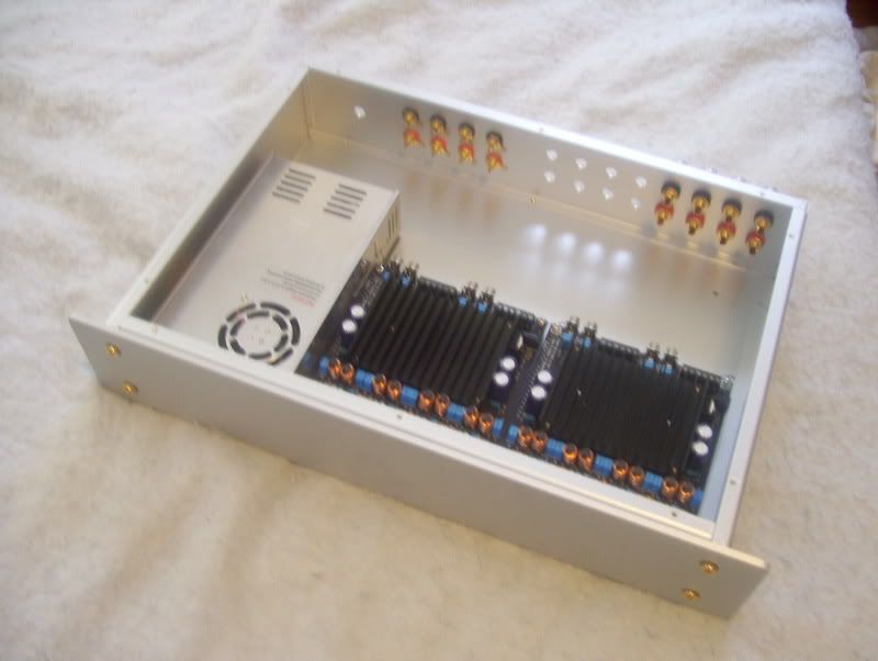

Would it be terribly detrimental to the amplfier if it were placed in a sealed case? The amp will be fed 19v, and be running 4ohms on two channels, and 8ohms on the other two channels.

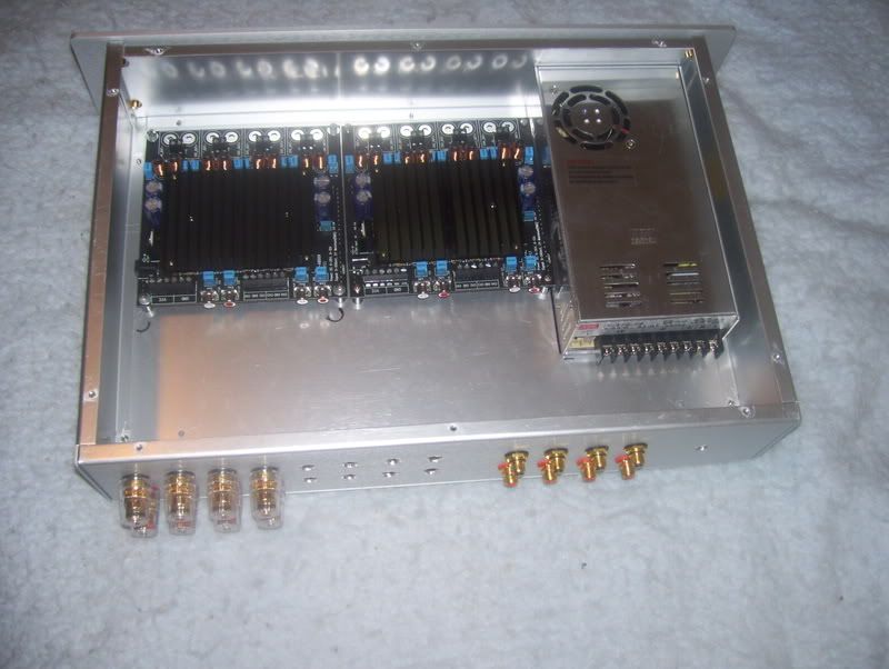

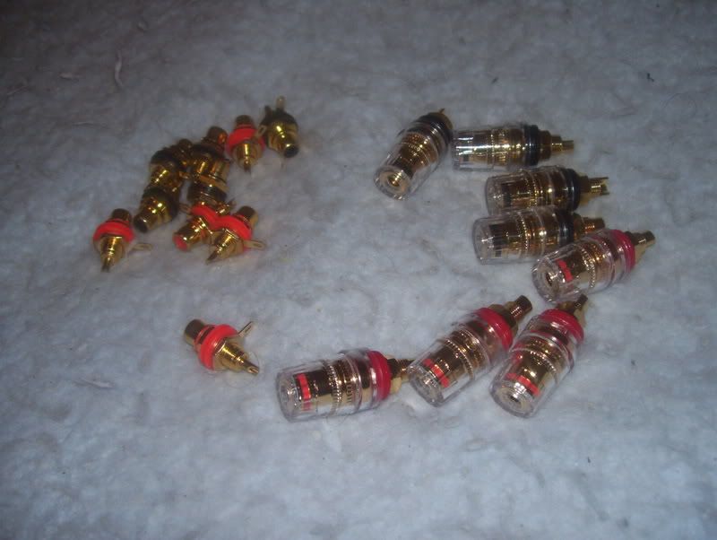

just a slight update. got most of this thing put together. just waiting for the other half of the binding posts (as i ordered only half as many as i needed) and need to solder all the connections. almost there....

SQ Kid: Looking good - where did you get them RCA's from?
EDIT: I'm tempted to replace the zobel resistors also all as I've already had one smoking
Mike: the rca's and binding posts came from ebay seller cnso138. couldn't be happier with his products, shipping time, and costs.
