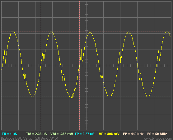

Also, about the output ripple, the voltage seems consistent with what you measured, but it's at 440kHz (see pic).
