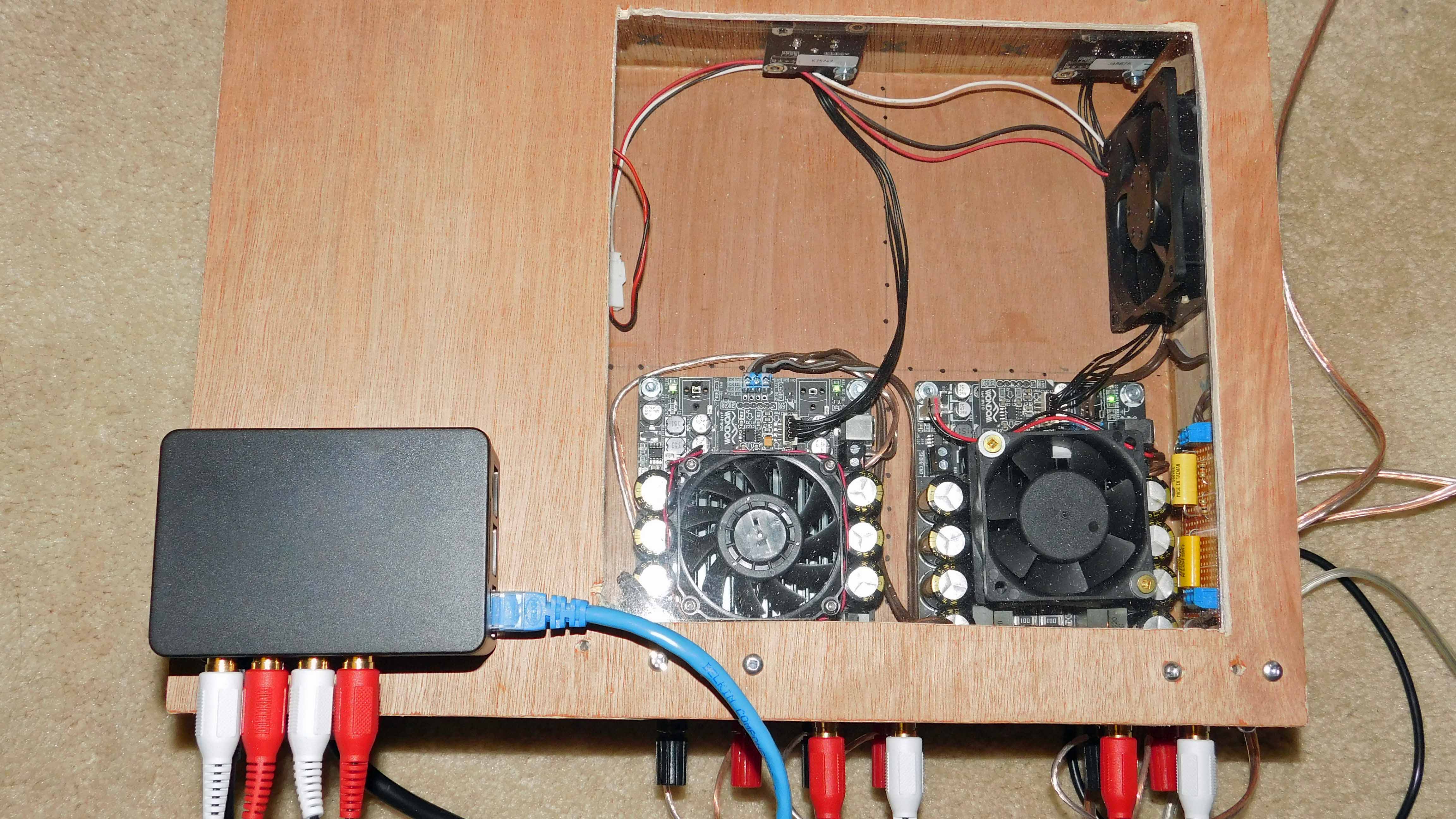

Take a metal square/rectangle - 2 or 3mm thickness - and place it below the AMP board.
Through all 4 holes, with metal screws make a good contact between the board and the metal plane.
Then, make a good contact between the ground - from the main AC plug - and the metal plane, with a metal screw.
Thanks.
Unfortunately it didn't solve the problem.
If RCA input shorted, there is no buzz anymore
With preamp connected it buzz immediately, even if the preamp is powered off.
If ONE channel input is shorted and the other connected to the preamp, no buzz.
Maybe a ground loop issue 😕
The preamp has no connection to earth.
My suggestion. Leave the amp connected like you had in post#322. Just connect the MW power supply +/-ve to the sure amp, do not connect the AC safety gnd to the amp. I use 2 Sure amps and connect them like this and there is no buzz. I also have them line sourced from a non-grounded floating source like you describe.
If you had an EMI/RFI problem then maybe a ground plane under the amp might help. It's very unlikely you have this issue. Your amp seems to be quiet when you short the inputs.
It does appear you have a leakage current between the signal and power paths.
- test#1 : connect your preamp line outs, and unplug the power to the preamp, to see if you have buzz
- test#2 : plug the preamp plug (2-prong) in the "other" position ( rotate 180deg) to swap the line-neutral to the preamp to see if you still get buzz. The 3 prong ac safety gnd is "closest" to neutral, sometimes line and neutral get reversed in 2 prong systems. It does not effect functionality at all, but sometimes the internal power supply return is inadvertently capacitively coupled to one of those ac lines.
- test#3 : try disconnecting the MW AC safety ground (make sure it doesn't touch anything). Both unit's output power supplies will "float" and will reference their inputs to the common signal ground.
Third suggestion is the first one i would try - I forget it in my previous post.
Thanks a lot guys 🙂
Buzz almost gone with power supply AC earth disconnected.
Now buzz is low but still there, it may be because of the layout and lack of shielding. Hope it will be totally gone in a proper enclosure.

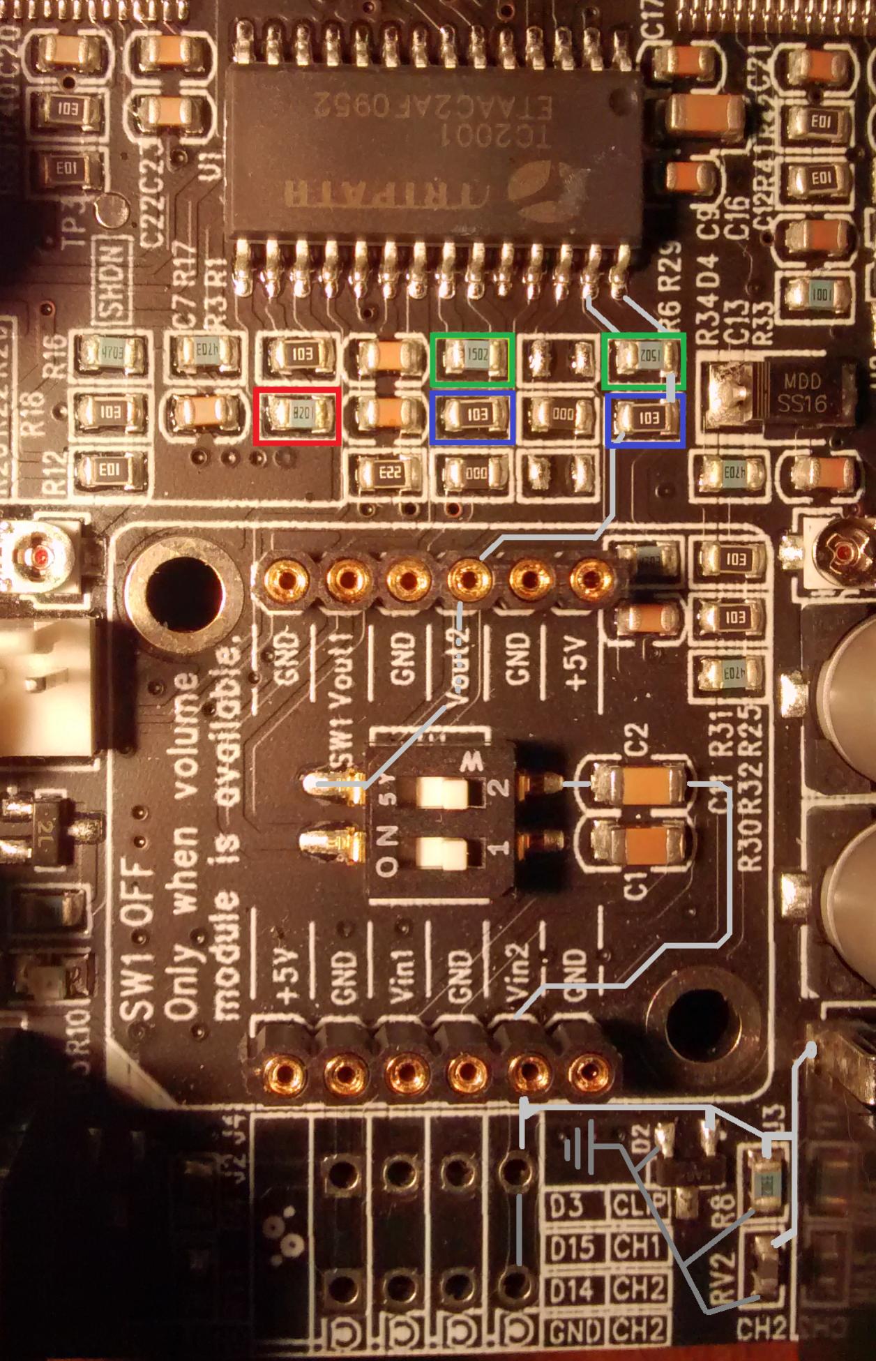

Before modifying the board. You said earlier that you have output noise even with the inputs shorted to gnd. Did you try this without your additional caps (ie. stock form).? There is always the possibility the amp actually has a problem.
One picture is worth more than 1000 words 🙂
I marked gray line signal path from RCA connector up to TC2001 chip. Signal feed across resistor R8 (33k), RV2 (???) and diode D2 (smd code 5A6, look like Zener diode 5V6)- all connected parallel. Later in series by capacitor C2 and by DIP Switch (if ON) , to resistor 10k (in blue rectangular). From resistor, on input internal opamp. Resistor15k(in green rectangular) is feedback resistor for opamp.
If dip switch is OFF and we have installed caps between Vin and Vout sockets, then signal passing only by additional caps.
Resistor marked in red, 8,2k is reference resistor. According to datasheet, should be 8,25k 1%. I don't know, how critical is this element.
I bought my board directly from PartsExpress. Full symbol is: AA-AB32313V100. Maybe these good sounding boards have different revision 😉
