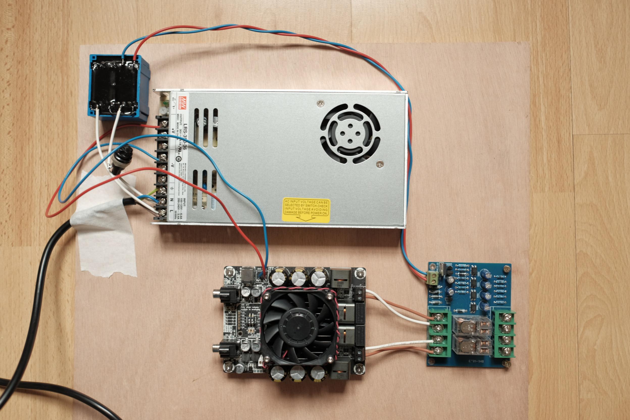

I have received this AA-AB32313 board and tested it on a piece of wood.
But there is a quite loud BUZZZ (both 15" driver and horn) 🙁
Did I miss something regarding wiring? inputs are connected to a -dead silent-rotel preamp.
Do I have to connect (red arrow) this hole to earth?

Definitely yes.
Thanks.
Unfortunately it didn't solve the problem.
If RCA input shorted, there is no buzz anymore
With preamp connected it buzz immediately, even if the preamp is powered off.
If ONE channel input is shorted and the other connected to the preamp, no buzz.
Maybe a ground loop issue 😕
The preamp has no connection to earth.
