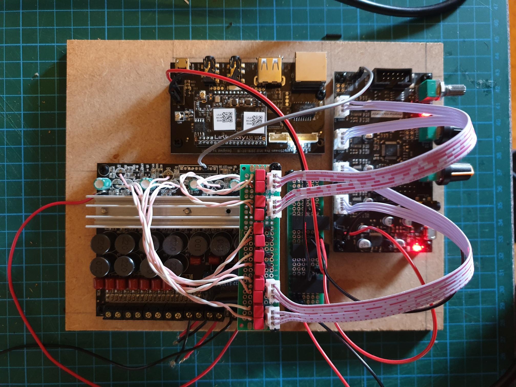

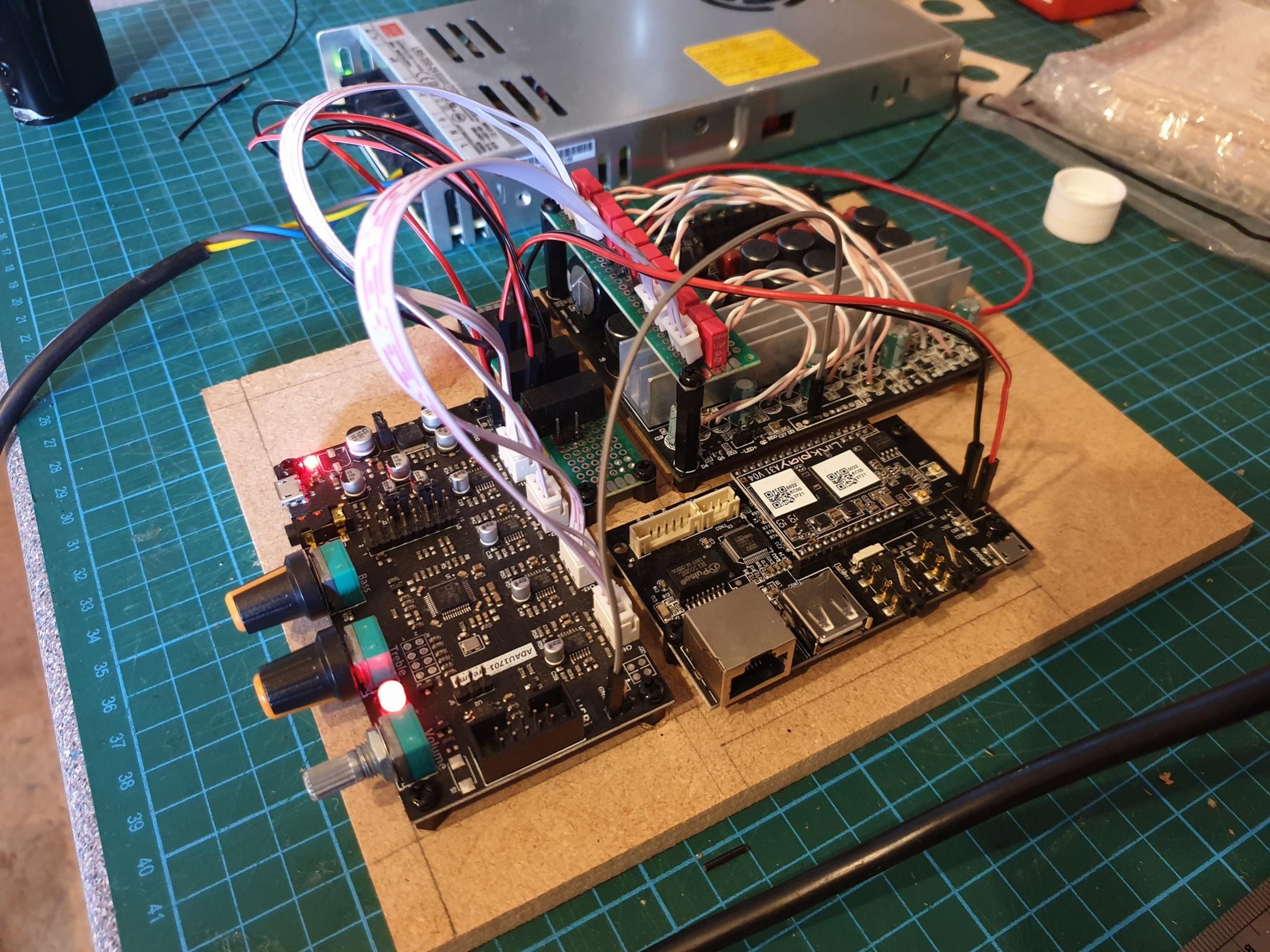

Attached is my 3E DSP board project so far.

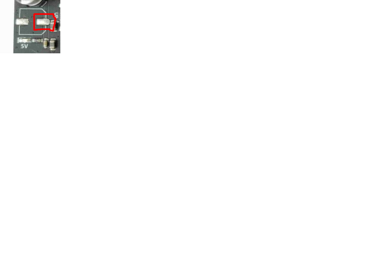

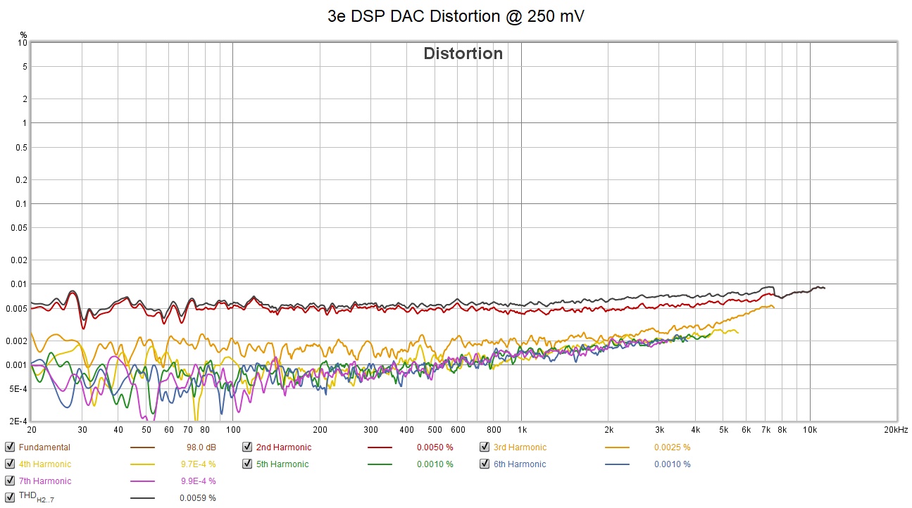

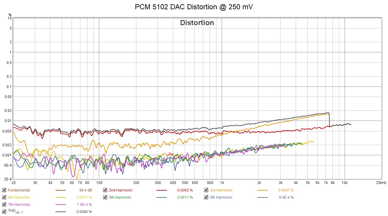

You could work around the problem by using THIS PCM5102 DAC. It would add additional D/A (DAC) and A/D steps (3e DSP), but would probably still sound better than the Arylic analog out. I’ve successfully used that DAC to provide two additional output channels to the 3e DSP. And the DAC’s distortion levels match the 3e DACs.
At first I ran into the problem of where to find 5 VDC to power the DAC. After poking around a bit I found a source of 5 VDC on the DSP unit. It's an un-populated capacitor footprint just above the 5V LED on the DSP. The DAC only requires 40 mA. I contacted 3e Audio about using the 5 VDC from the DSP and they said no problem.

For the hardware connections: My previous post (#16) shows where to get the DAC 5 VDC. I attached a diagram showing where the other connections (BCLK, LRCLK and Data) are found on the DSP’s J5 connector. You can also get the ground from any of the even numbered J5 pins. I used pin-to-pin jumpers in my initial test.
