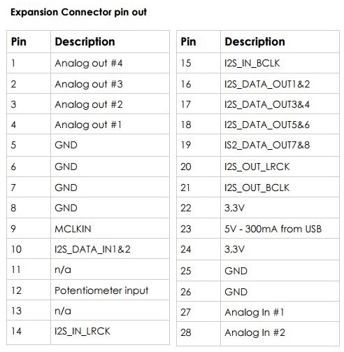

I have an old minidsp 2x4 I will use first. No clockchange, resampling 44.1 to 48 kHz in software.
After reading your installation instructions about wiring I hope it will function with this board also.
Wireing Raspberry to ADAU1701 :
Pin 12 (PCM_CLK) - MP5 und MP11 ( 14 and 20 ) (MiniDSP)
Pin 35 (PCM_FS) - MP4 und MP10 (15 and 21)
Pin 40 (PCM_DOUT) - MP0 (oder MP1, MP2, MP3) (10 ? )
Pin 39 (GND) - any GND-Pin ( )
I wrote the connection number for minidsp in the table ( ) Is this correct?
Why is the signal loopbacked actually?
In my case the raspberry runs as slave (dsp is the clock master). If you want to use airplay (fixed to 44,1 kHz without the opinion of resampling in the alsa subsystem) you have to provide clocks for 44,1 kHz.I have an old minidsp 2x4 I will use first. No clockchange, resampling 44.1 to 48 kHz in software.
I think that should be ok.I wrote the connection number for minidsp in the table ( ) Is this correct?
The signal is not loopbacked, but the clocks are. That is the way it has to be connected if the dsp is the clock master for an input (see adau1701 datasheet for more info).Why is the signal loopbacked actually?
