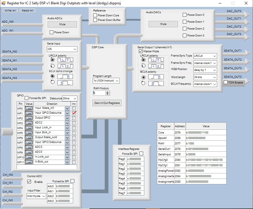

Graham –
Note for those using the 3e Audio SigmaStudio source code:
You’ll notice that MP6 and MP7 are configured as “Input GPIO Debounce”, MP8 is configured as “Aux_ADC_3” (the treble pot) and MP9 is configured as “Aux_ADC_2” (the volume pot). So all four Sdata_out GPIO pins seem to be in use. The MP6 and MP7 pins may be used by the “Auto Source Selection” and “Auto Mute” blocks. It’s hard to tell since the source code for those blocks aren’t supplied. I sent an e-mail to 3e Audio about the subject today.
Next we need to add to the digital outputs to the SigmaStudio schematic. Go to that tab and drag the “output” control (found in the “IO” section) onto the schematic. From the control’s drop down list choose “DIG0. Repeat and select “DIG1”. These are the SDATA_0 Left and Right channels respectively. After that you connect those outputs just like a DAC output.

OK, I have tested output on a mixer with gain adjustment. Still distorted.
I created a new project file in Sigma Studio with just input and digi output and your settings with the same result.
Also, in either the 3E Sigma project file or mine a volume control in the schematic has no effect to the digi output
Perhaps a defective DAC board or maybe I've got some connections wrong? It is only 3 cables to attach plus VCC and ground to and from the 3E board. As I say, I'm new to this I2S lark so it's a bit confusing to debug.

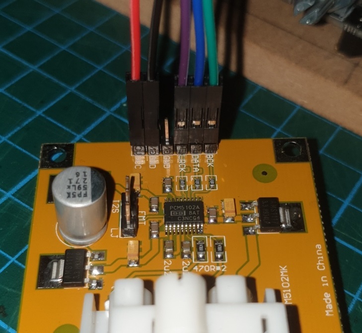

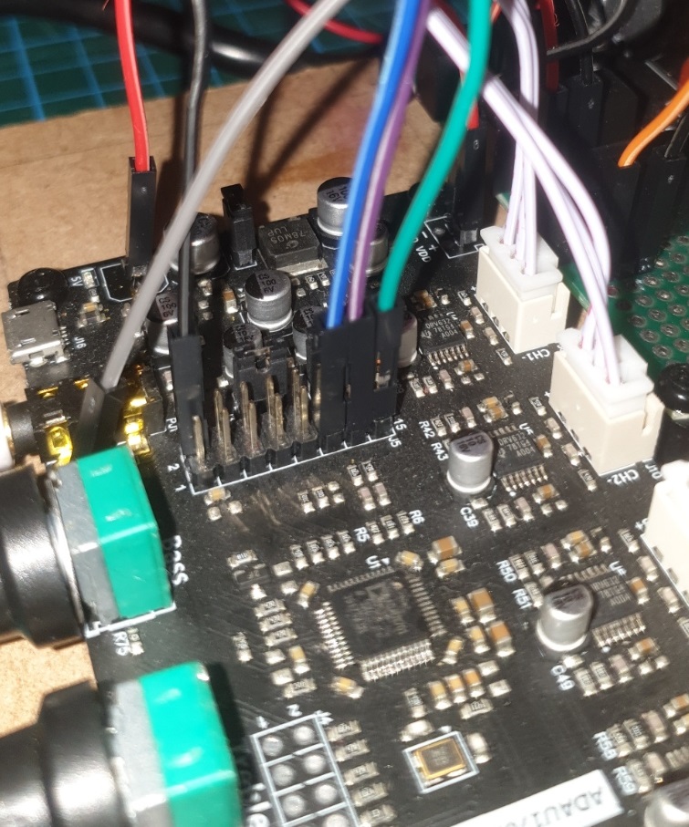

Here are my connections:
Bclk (bck) to pin 15 - Green
Lrclk (lrck) to pin 13 - Purple
Sdata0 (data) to pin 11 - Blue
VCC and ground from empty capacitor pad and ground to the second row on J5. Hmmmmm.

Call off the search!
Right, so I was looking through the datasheet and searched for FMT which is a three pin jumper selection on the DAC board. The board wasn't supplied with a jumper so I thought nothing of it before as I tried bridging various combinations of those pins whilst audio was playing to no avail. What I didn't do is bridge them then restart the whole system!
I guess the DAC needs to be rebooted with this selection made rather than during operation!
I feel bad, I should have noticed this sooner! 🙂
Man, I'm so hyped! Thanks Ed!

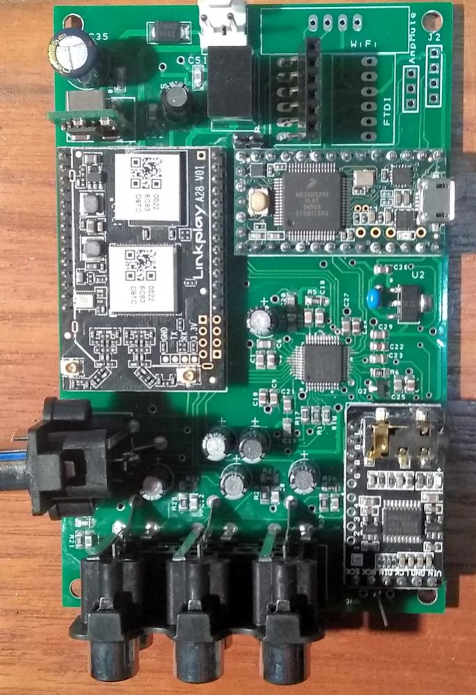

An update on this board...
I figured out how to use these A28/A31 Linkplay boards. They are usually slaves to an A/D converter, which provides the I2S clock. But then they are masters to the DAC and the SPDIF transmitter. So, you need to provide a 2.822MHz clock if you don't have the A/D converter. Once I provided a suitable clock, the chip outputted audio from Spotify and my cell phone via DLNA to my ADAU1701. I used this same clock for the ADAU1701 with PLL mode = 00, which the chip used to run at 45MHz.
So it looks like this board will work OK, once I add an oscillator to provide the sample clock. I've got a 3.072MHz oscillator on order, which should allow the ADAU1701 to run at a 48KHz sample rate.
Unfortunately, you can't use one of those low-cost ADAU1701 boards because you need to provide your own clock and you need to change the PLLmode to use a 3.072MHz reference rather than the 12.288 oscillator that is typically used. That means you need to solder all of those SMD parts for the custom ADAU1701 circuit. And for me that means I need Knob Creek or higher to make these boards. I'd prefer to buy a completed module for the ADAU1701 circuitry, but there doesn't seem to be anyway to get there with this design. Thank goodness liquor stores are still considered an "essential service" in Virginia during this COVID-19 crisis.
