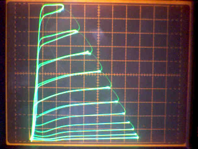

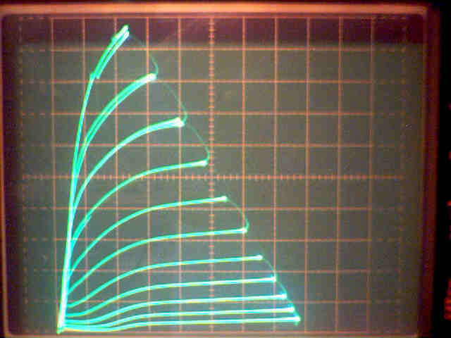

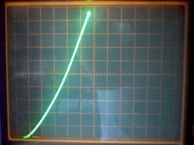

Did the amp have GNFB? This is the worst case of tube hysteresis I have seen yet in the tracer. I would think it would sound baaaad. But, as you can see from the curves, the problem shows up mainly at high power.

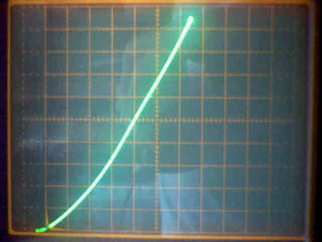

I just tried decreasing the filament voltage down to 3 V and then increasing it up to 10 V, but the hysteresis problem just stays put. The earlier problematic 29GK6 apparently cured itself after sitting cold on the bench for a few hours. Since g3 here is internally attached to the cathode, I can't try applying some positive voltage to g3 to heat that up.

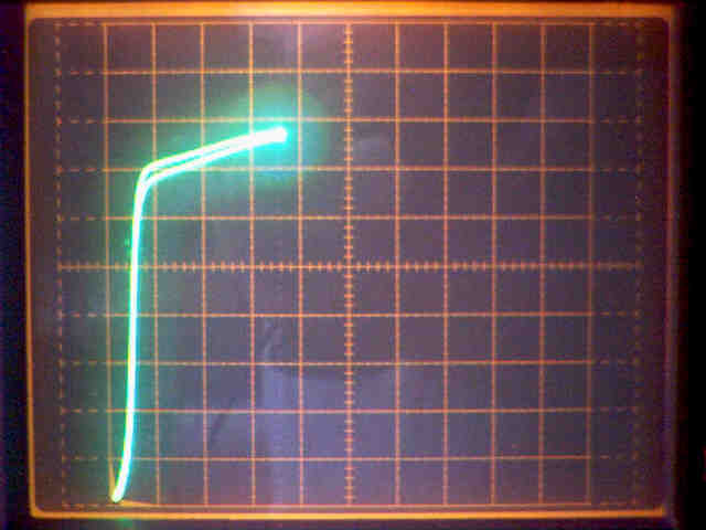

Just tried a magnet on the tube. It sure messes up the curves while its near. But I couldn't make any change to the hysteresis problem, tube just goes back to the same when the magnet is removed.

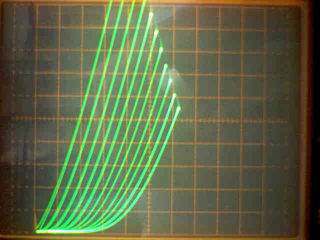

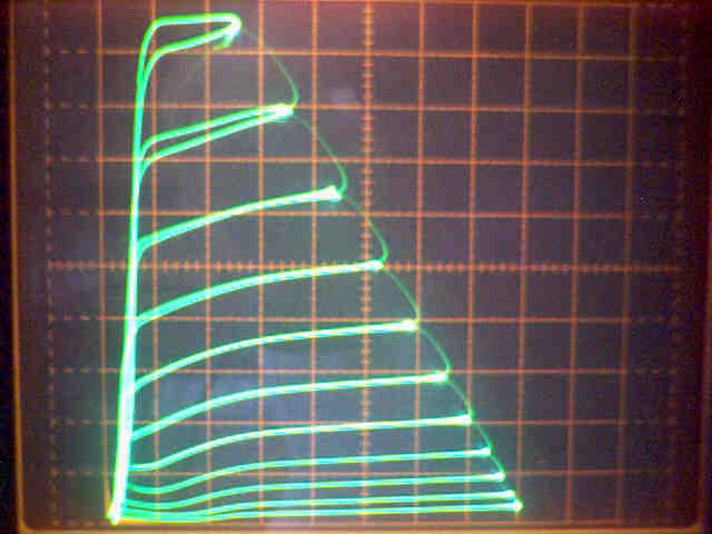

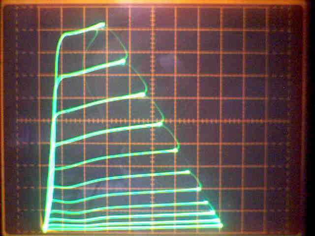

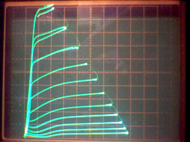

Well, been running that hysteretic tube for about an hour in the tracer. Here are before and after pictures. Seems to have improved a little. The apparent increase in hysteresis seen in the lower middle traces is just due to the camera shutter timing versus the tracer display timing (camera missed it in the earlier picture).
I have found a large clue to the mystery. The hysteresis affected curves begin near and above the g1 = 0 V level. I should have checked the biasing offset more carefully, (the 6P1P requires higher g2 voltages to avoid positive g1 curves than most of the tubes I have been testing). So you probably didn't run into this condition while testing in your amplifier. Here are some curves with g2 up at 183 V. The second set is with g1 forced to 0 V for reference (all else the same). Note the hysteresis begins near the 0 V g1 curve in the 1st set.
Still, mysterious why some tubes do the hysteresis thing and others don't. Also, no improvement in the 4400 tube overnight obviously. The g1 lead wires on the tester do not have stopper resistors on them, but do have a string of a dozen or so ferrite beads. The g2 lead wire has a 180 Ohm stopper and a string of ferrite beads. Both sides the same nominally. Swapping tubes around, the Hysteresis problem followed the tube and not the leads.
I'll run another set of pentode curves for both 6P1P tubes next with 0 V for g1 at the max curve.

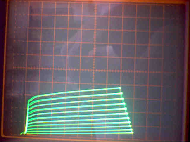

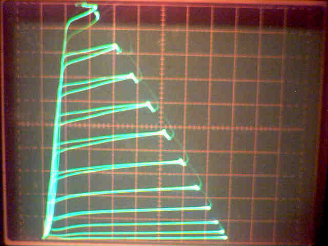

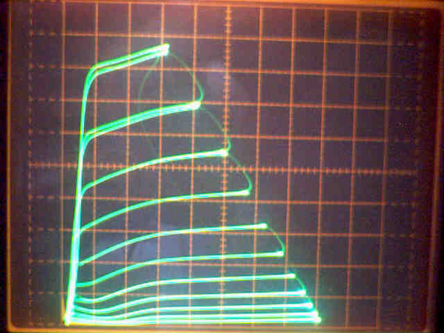

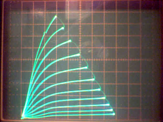

1st plot here is the same as the above plot, but with a 1K Ohm stopper resistor added to the g1 lead. Not much difference I would say. Scale for all plots are 50 V/div horiz., 10 mA/div vert., 2.5 V steps on g1. The 2nd and 3rd plots here are set up so that the top curve is for g1 at 0V.
Plot1: 4400 tube with 1 K stopper on g1, 183 V on g2, 2.5 V steps g1
Plot2: 4400 tube, 200V on g2, top curve at g1 = 0 V, 2.5 V steps g1
Plot3: 3950 tube, 200V on g2, top curve at g1 = 0 V, 2.5 V steps g1

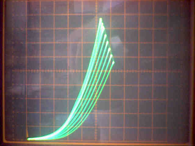

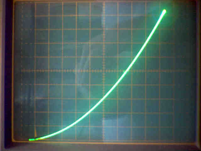

The hysteresis effect on the tube curves is quite similar to what I have seen before when varying the g3 voltage. Ie, I could make one curve (rising Vp say) with a certain g3 voltage and the other curve (dropping Vp) with another g3 voltage. The 6P1P however has the g3 attached internally to the cathode. So no playing with that here. But my earlier suspicion of an effective dielectric coating on g3 (maybe absorbed gas film) could account for the effects seen.

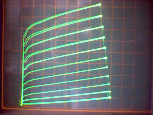

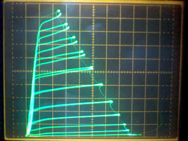

Just for fun, here are some curve sets for the 6P1P 4400 tube without and with an applied magnetic field. This was done with a fairly strong ferrite refrigerator magnet. Surprisingly, the effects shape does not change much with direction of field, just the magnitude of the effect (ie, same rounding of curves). Greatest effect was with the field axial along the tube length.
Interestingly, the magnet gets rid of the hysteresis effect while it is applied (comes back after removal of the magnet). Although, the curves are pulled out of the region where this occured before without the magnet, so maybe not so surprising really. The avg. screen current goes up from 6 mA to 9mA with the magnet applied. The drooped curve shapes look similar to putting a large resistor in the g2 circuit or putting a non optimal negative voltage on g3 for some tubes. Maybe interesting for modifying the harmonic structure of the tube gain. But looks like g2 dissipation must go up substantially.
Repeated application of the magnet does not seem to leave any permanent effect on the tube, although it is apparent that the tube is constructed with magnetic materials from its attractive force. Maybe the internal temp is too high to allow any permanent magnetizing effect.
edit: added 3rd image with half magnet effect
G2 normally hides in the shadow of G1. But you put a magnetic field axially.
Doesn't this shift the apparent shadow? Maybe why G2 current changes?
Maybe this is useful when running positive G1? I worry G2 might be in focus
of A2 beams rather than shadow... Shifting the pattern might correct this?
I've never Xrayd 1P, so I don't know if grids even have such an alignment.
If shadowing is random, then I'm baffled what makes the current change?

Hi Ken,
The 6P1Pev has slots you can see thru, so I just checked it with a magnifying glass and it definately has aligned grids g1 and g2. g3 is a beam former plate. Being a beam tube, my theory of a g3 gas dielectric coating seems unlikely here (shouldn't have much effect). Can't see any obvious differences between the two tubes either except that the hysteretic one has its grid alignment off just a hair, the other is spot on.
I would imagine that the magnetic field is curving the grid wire beamlets to hit g2 wires here as you suggested. Doesn't seem likely to me that one could correct for a positive g1 this way. The shadow grid tubes (6GU5, 6FG5, 6FS5 ) have another aligned negative grid betwwen g1 and the usual "g2" that guards "g2". These tubes used a high gm frame grid for g1 which couldn't be aligned with "g2". I'm not aware of any power tubes that had this feature though, but should work for a positive g1 I would think.

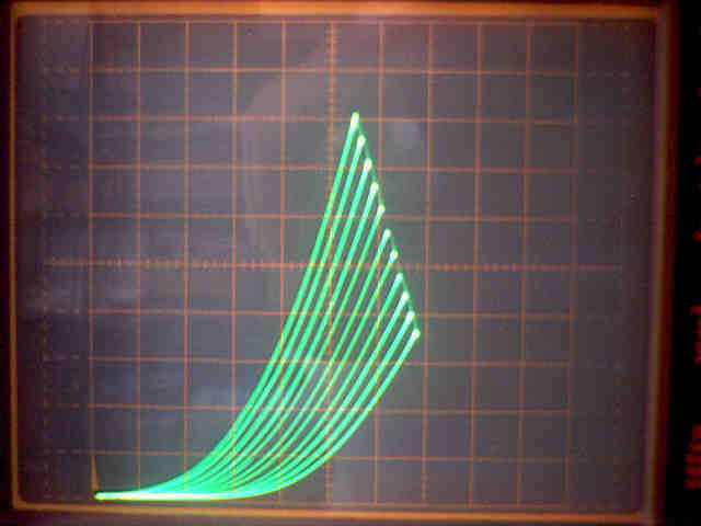

As TubeSteve says, 6P1P appears to be identical in specs to a 6AQ5, which has a g2/g1 Mu of 9.5. So I rigged up the 6P1P 4400 (hysteretic) with g2,g1/Mu drive using a 1K Ohm resistor from g2 to g1, and a 100 Ohm resistor from g1 to cathode. Drive on g2 at 5.3 V/step.
Plot1: g2,g1/Mu, 50 V/div horiz., 5 ma/div vert., 5.3 V steps
Plot2: g2 only, ditto, g1 at 0 V
Plot3: g2 only, but changed to 2 mA/div vert.
Seems to still have hysteresis in g2,g1/Mu mode. Still a bit in g2 drive only too. Plot 1 versus Plot2 verifies that each grid is doing half the control.

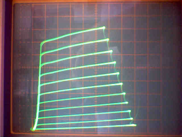

I tried a simple axially symmetric rectifier tube, 19Y3, in a magnetic field from a stack of strong toroid magnets here. They are stacked about 4 inches high and slipped over the tube for the axial case. Perpendicular case has the tube stuck to the end face. Scale for plots is 2 V/div horiz. and 10 mA/div vert.
Plot1: no field
Plot2: axial field case
Plot3: perpendicular case
I tried both directions of the magnetic field for the axial case, and they were the same as expected. Also tried both polarity fields for the perp. case, and the same result.
Looks like an axial field works well for increasing the plate resistance.
Should be interesting to try this on an axial sym. triode to see if it affects the Mu or not.
Edit: added earlier plots as plot 4 and 5 here of the 6P1P in normal g1 drive mode for comparison with the previous g2,g1/Mu and g2 plots shown above. Plot4 has 100 V on g2 and Plot5 has 200 V on g2.
