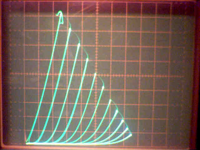

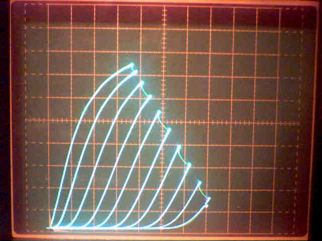

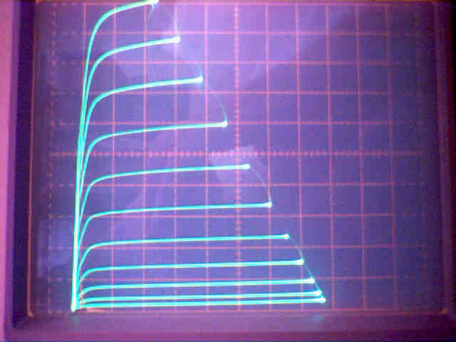

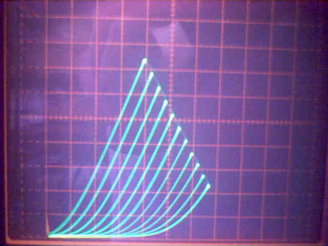

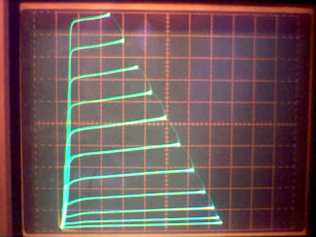

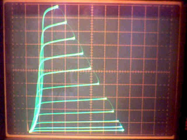

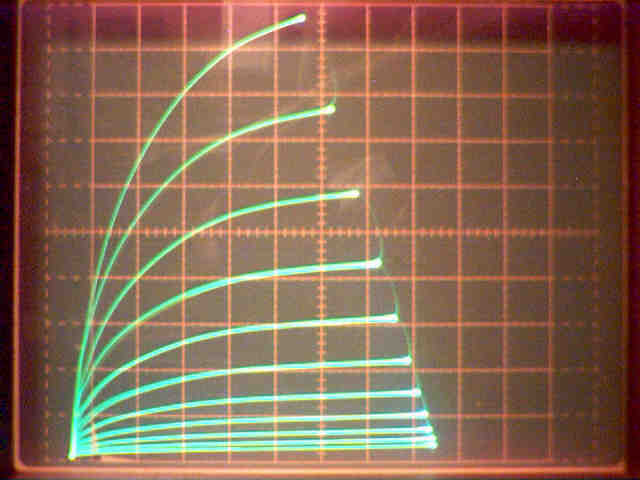

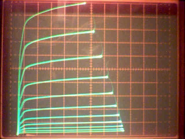

Here is the 6F12P actual triode and then the pentode as triode again. My data sheet shows g3 attached to cathode internally.
Plot1: actual triode: 2 mA/div vert., 50 V/div horiz., .27 V steps on g1
Plot2: pentode config as triode: 2 mA/div vert., 50 v/div horiz., .27 V steps
on g1
on g1

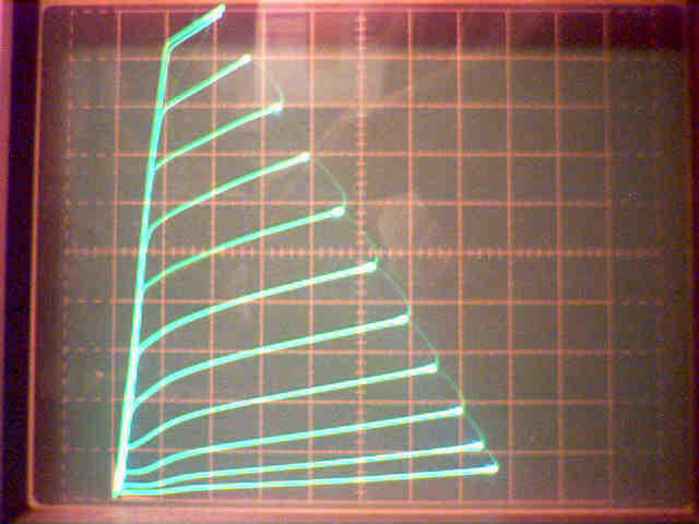

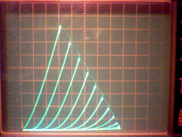

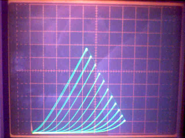

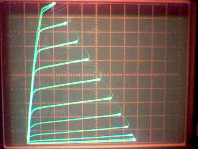

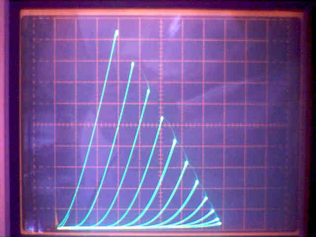

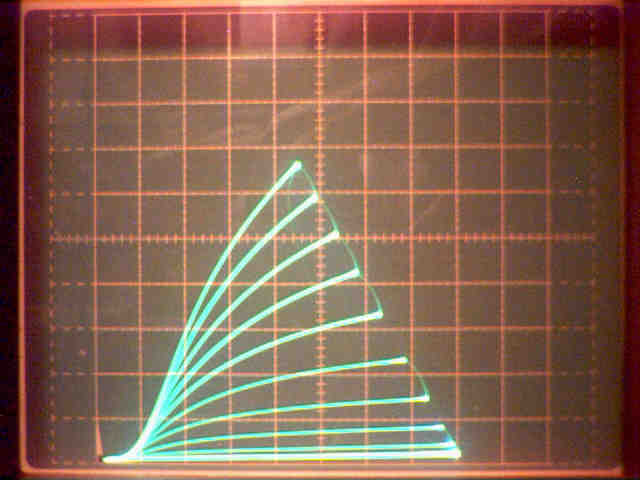

Here is 6485/6AH6WA, got these cheap on sale at $0.50 each
Plot1: pentode: 2 mA/div vert., 50V/div horiz., 100 V on g2, .27 V steps on
g1, 0 V on g3
Plot2: pentode: ditto, except +15V on g3
Plot3: triode config.: ditto, except 1.4 V steps on g1 and g3 = 0
g1, 0 V on g3

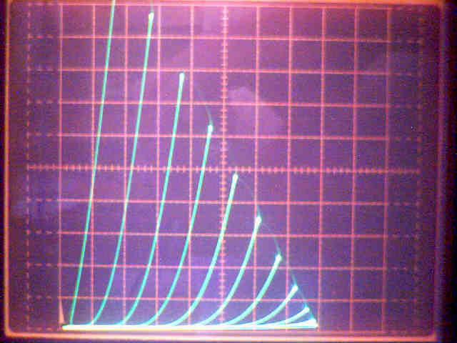

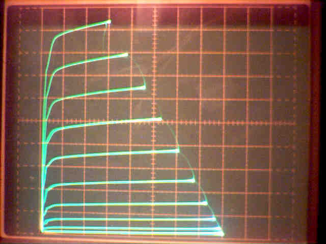

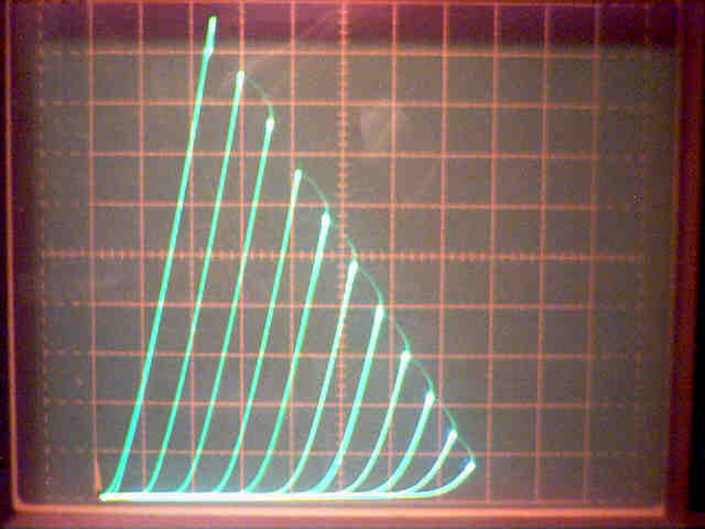

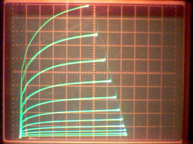

Here is the high gm 12HL7
Plot1: pentode: 10 mA/div vert., 50 V/div. horiz., g2 100V, g1 steps .55V,
g3 0V
Plot2: triode config.: ditto, except 1.4V steps on g1
g3 0V

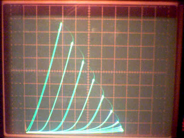

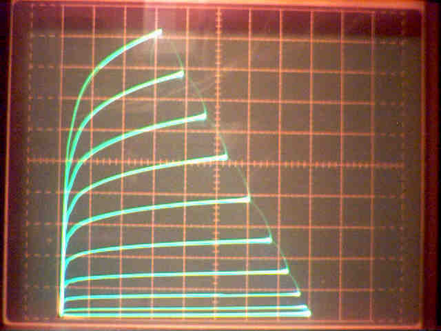

Here is the high gm 12HG7
Plot1: pentode: 10 mA/div vert., 50 V/div horiz., g2 100V, .24 V steps on g1
g3 0V (not much effect on beamers usually)
Plot2: triode config. ditto, 1.4V steps on g1
Good tube! 😉

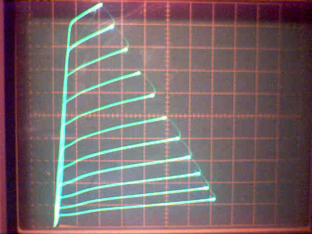

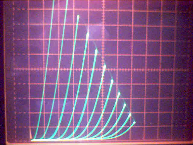

6BN11 is a beam pentode, which won't have much useful g3 effect. But here is what happens with 0V, -50V and +50V on g3:
(50V/div horiz., 2 mA/div vert., 90 V on g2, 0.27 V steps on g1)
A 6BV11 dual pentode has large g3 effects, but its quite a different tube. (like dual 6GY6)

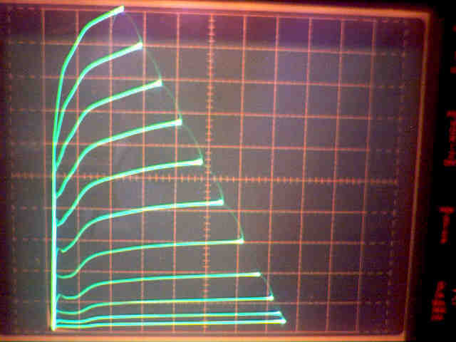

"6BV11 is good for that, in other regards, it looks like a less desirable choice for audio use, judging from the linearity of its plate curves. "
Well, these dual control, or other multigrid control types are intended for use with a small signal, usually in the RF of IF of a receiver. They can be made linear over large signals if the g3 is adjusted positive enough (and gm about doubles over the data sheet value). But the g3 gain control effect reduces the high current low plate voltage end of the curves the most. Natural 2nd harmonic getting knocked out and 3rd and other odd harmonics growing big.
For more gm and watts, the 6LE8, demo'd earlier, works similarly.
for all plots: 50 V/div horiz., 2 mA/div vert., g2 at 100V, 0.55 V steps on g1
Plot1: 6BV11 with g3 at 0V
Plot2: 6BV11 with g3 at +2V
Plot3: 6BV11 with g3 at +8V
Plot4: 6BV11 with g3 at -2V
