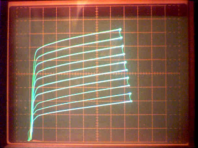

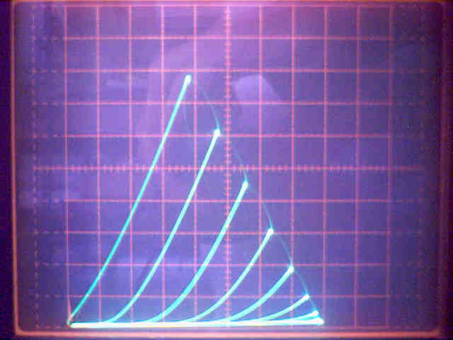

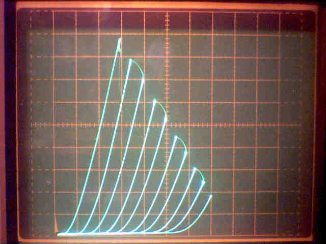

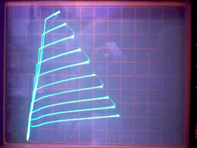

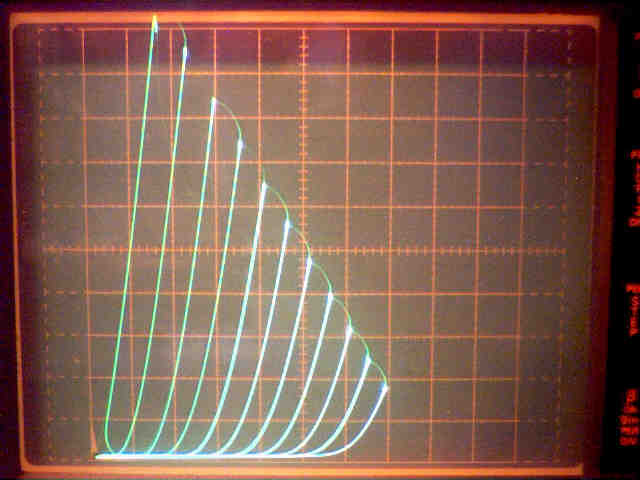

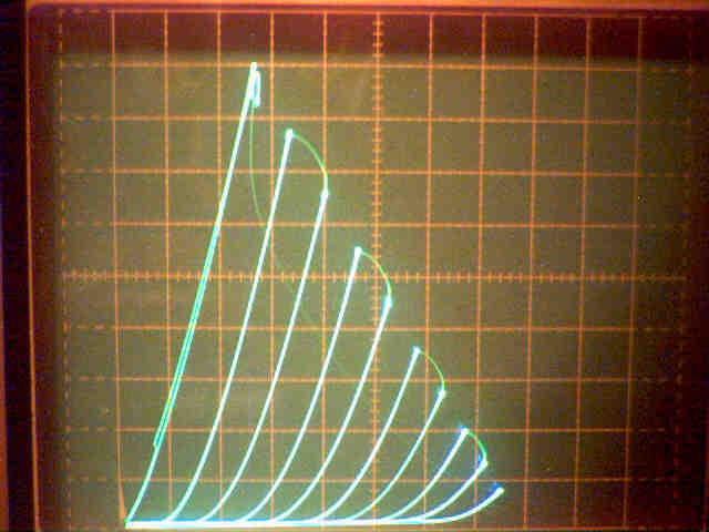

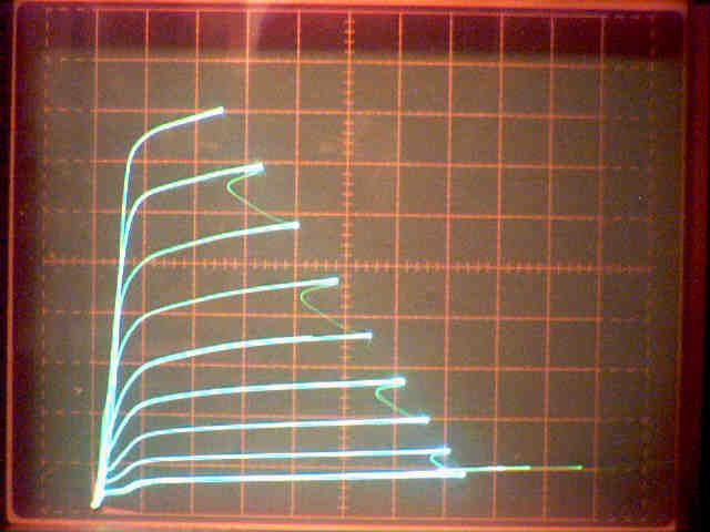

Here is 12L6 in triode mode with an optional resistor in the g2 connection to plate. 10 mA/div vert. , 50V/div horiz., 5.5 V/div steps on g1.
Plot 1: no g2 resistor, direct g2 to plate conn.
Plot 2: 10K Ohm g2 resistor to plate
Hi Don;
I forgot to ship you sockets fro GU-50 and ECF200/201...
Looks like 6L6GC is very nice in SE triode! I did not think of usage it such a way, but... 😉
Also, 5763 will work nice in LTP driver, with G3 to ground (negative in respect to cathodes).

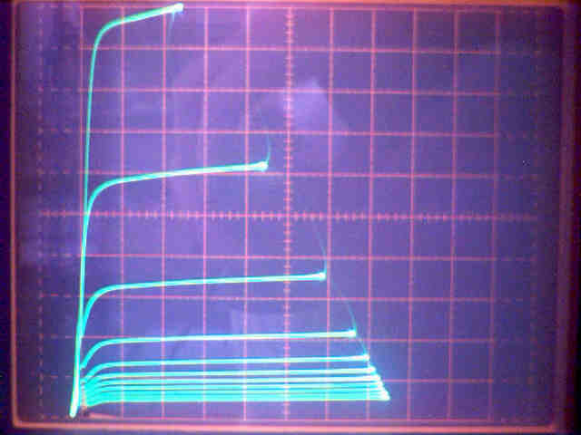

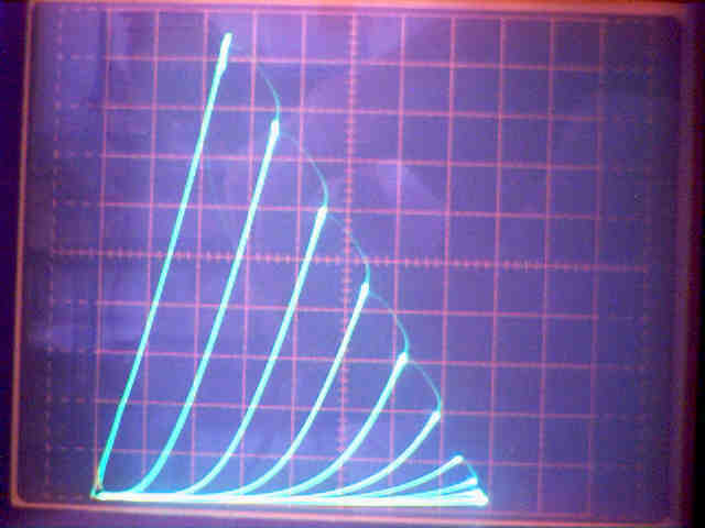

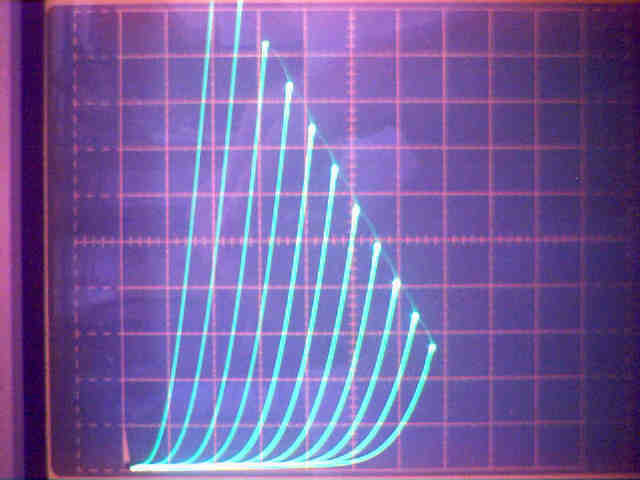

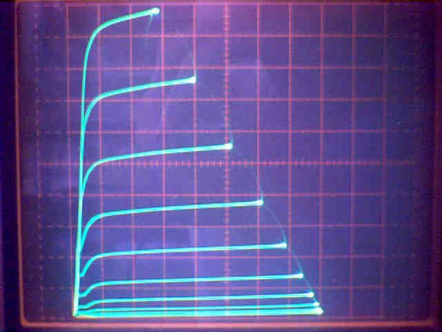

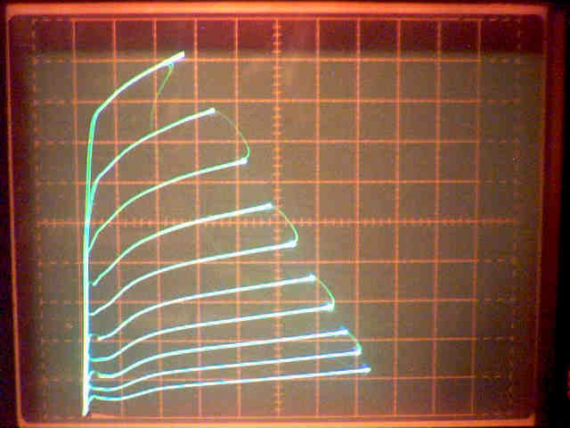

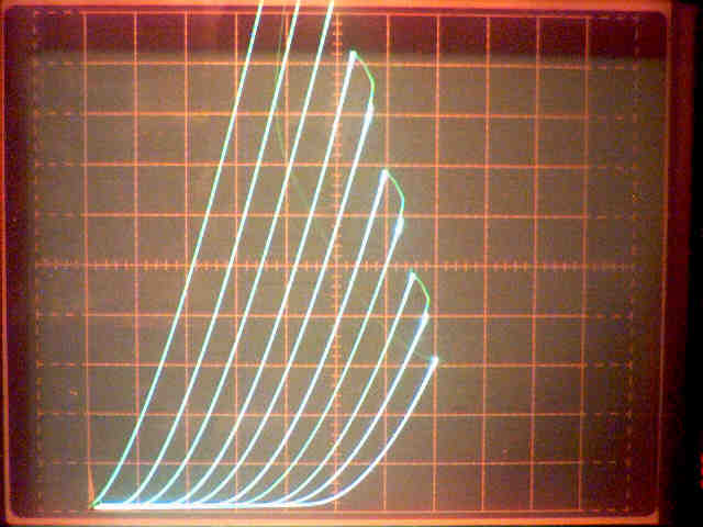

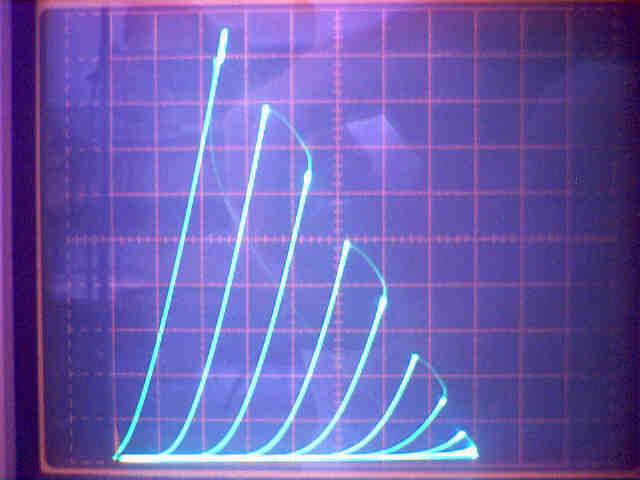

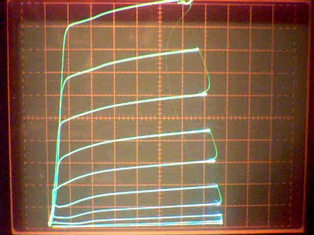

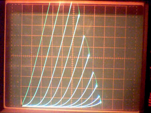

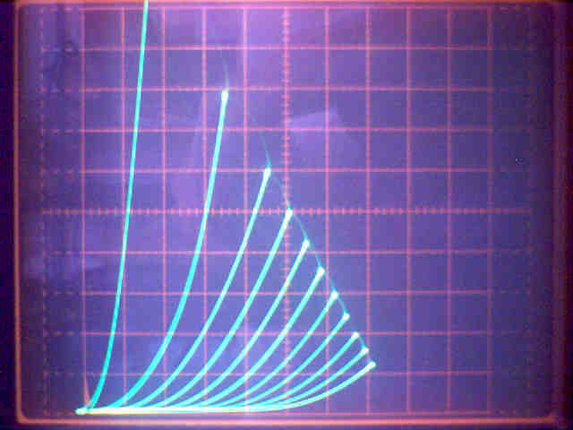

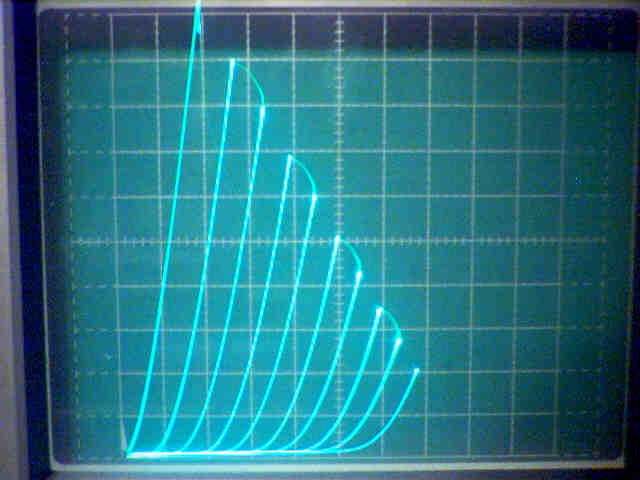

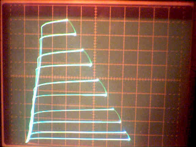

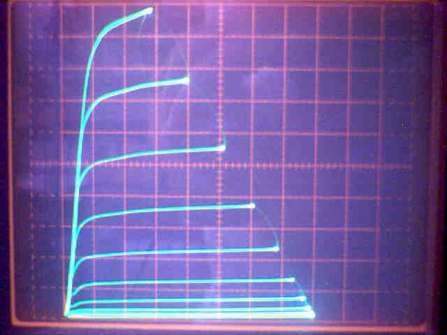

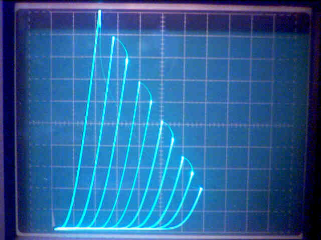

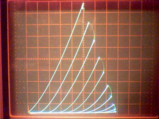

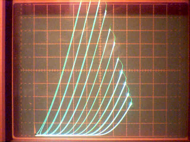

Next up is 24JZ8:
Plot1: pentode mode: 10 mA/div vert., 50V/div. horiz., 100V on g2, 1.4V per step on g1

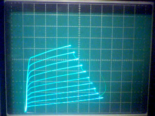

Plot2: triode wired: 10 mA/div vert., 50V/div horiz., 5.5V steps on g1

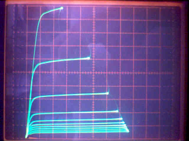

Plot3: g2 drive: 10 mA/div vert., 50 V/div horiz., 5.5V steps on g2

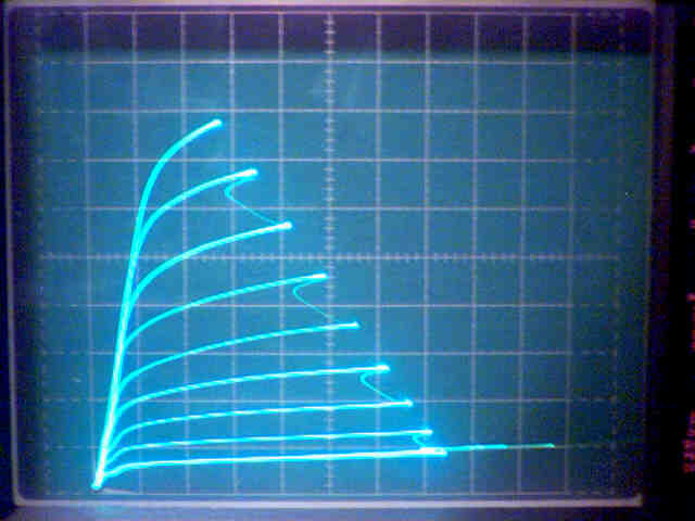

Plot4: the actual triode in there: 5 mA/div vert., 50 V/div. horiz. , 2.6 V steps on g1
I think there is a nice GE datasheet on the 6JZ8 at Franks.
No problem on sockets, I have pin jack leads that will fit the ECF200 and clip leads for the GU-50
I've never seen a 10 pin tube before! Looks like it would be a good joke to give someone to try fitting it into a 9 pin socket.
I have a Sovtek 6L6WXT here if you want to see some triode curves.

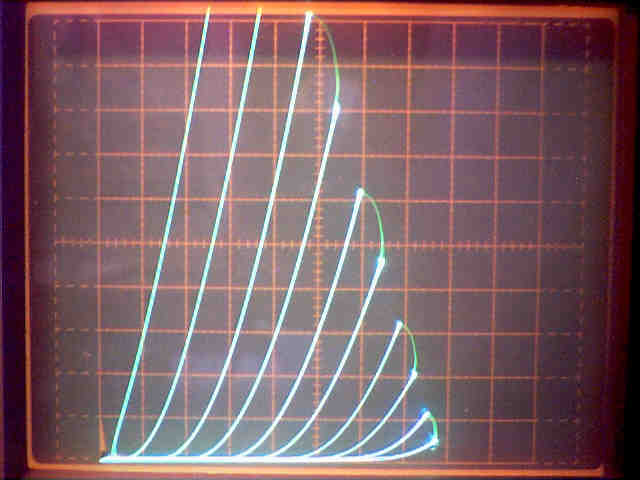

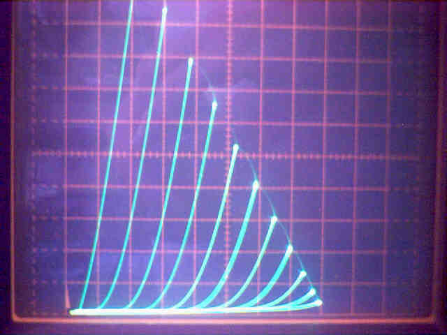

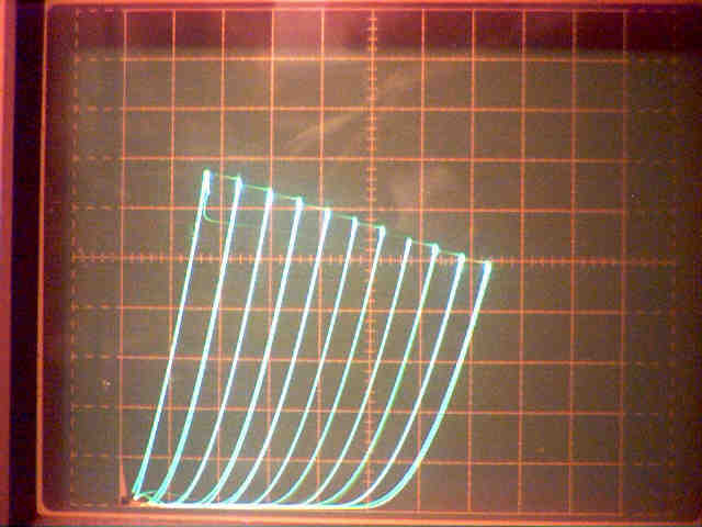

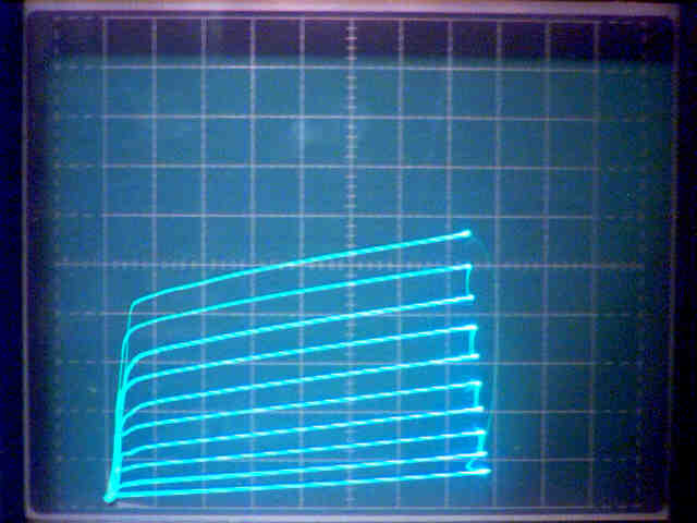

Here is 6L6WXT:
Plot1: pentode mode: 10 ma/div vert., 50 V/div. horiz., 2.6 V steps on g1, g2 at 150 V
Plot2: triode mode: 20 mA/div. vert., 50 V/div. horiz., 5.5 V steps on g1
Plot3: g2 drive: 5 mA/div vert., 50 V/div horiz., 5.5 V steps on g2, 0 V on g1

Actual triode in 24 JZ8 looks very nice, but a pentode section does not look ideal for SE, either in triode or pentode. It explains why I did not like it's sound in a hybrid driver, even CCS loaded trioded pentode as an output that drove MOSFET source follower. However, couple of them would rock in PP. Like triode LTP phase splitter and pentode output, 2 tubes only. Something like 10W in class AB, using cheap industrial transformers. Or, something like Fender output stage, for studio & practicing.

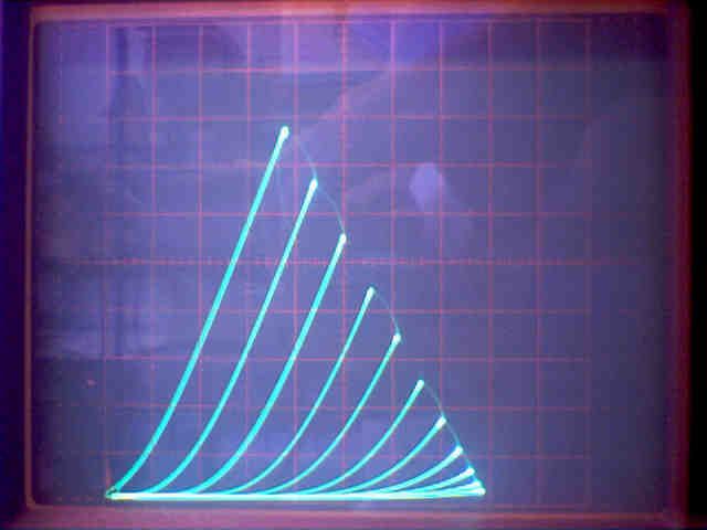

Here are the whole group together for comparison of triode mode curves.
1) 5763
2) 12L6
3) 24JZ8
4) 6L6
5) GU50
Yeah, there is noticeable hum grouping in the GU50 triode curves (notice at bottom, pairs squeezed), I'll try to redo them later.
1) 5763
2) 12L6
3) 24JZ8
4) 6L6
5) GU50
Still, 12L6 is the best for SE, while GU-50 is the best for PP.
But 5763 made for class C transmitters is a nice LTP driver! 🙂
