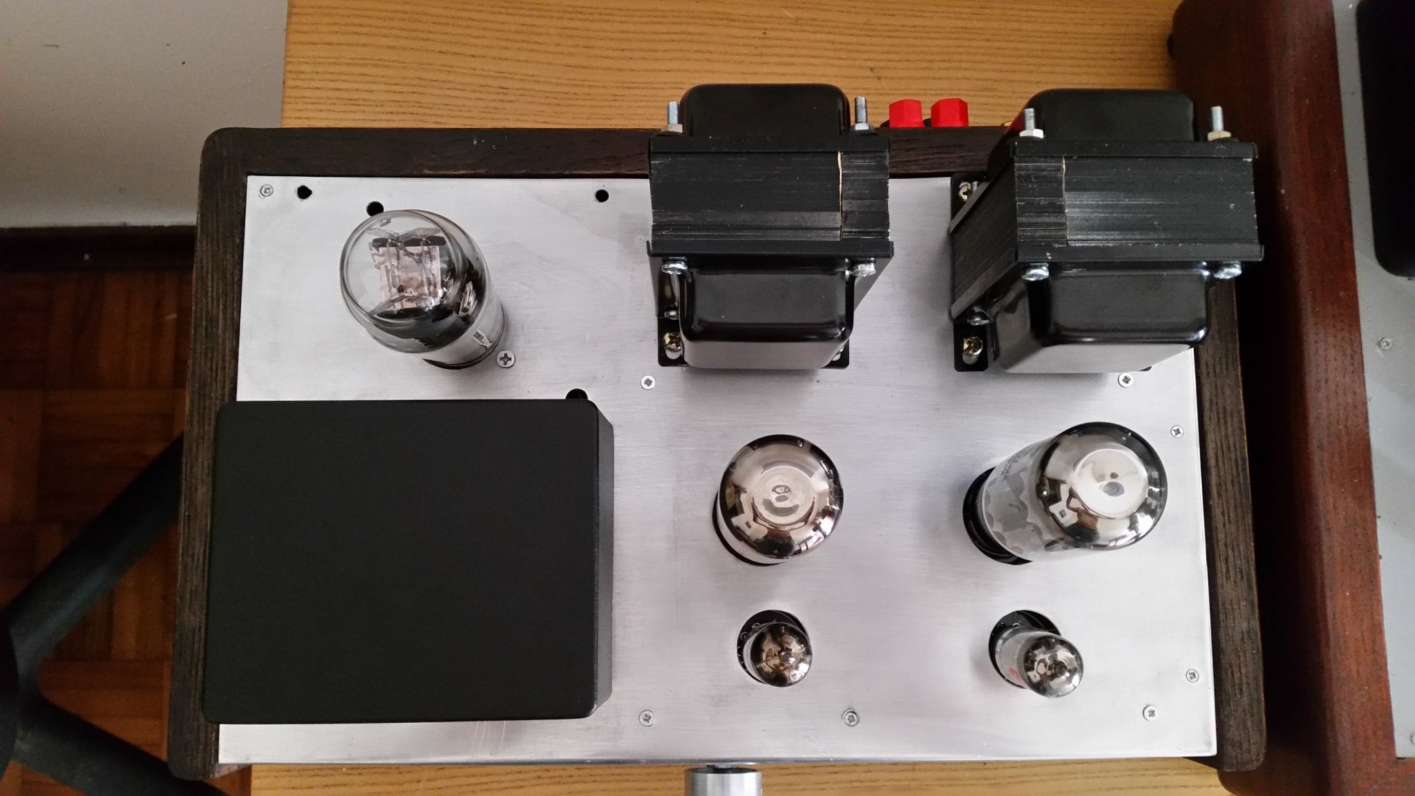

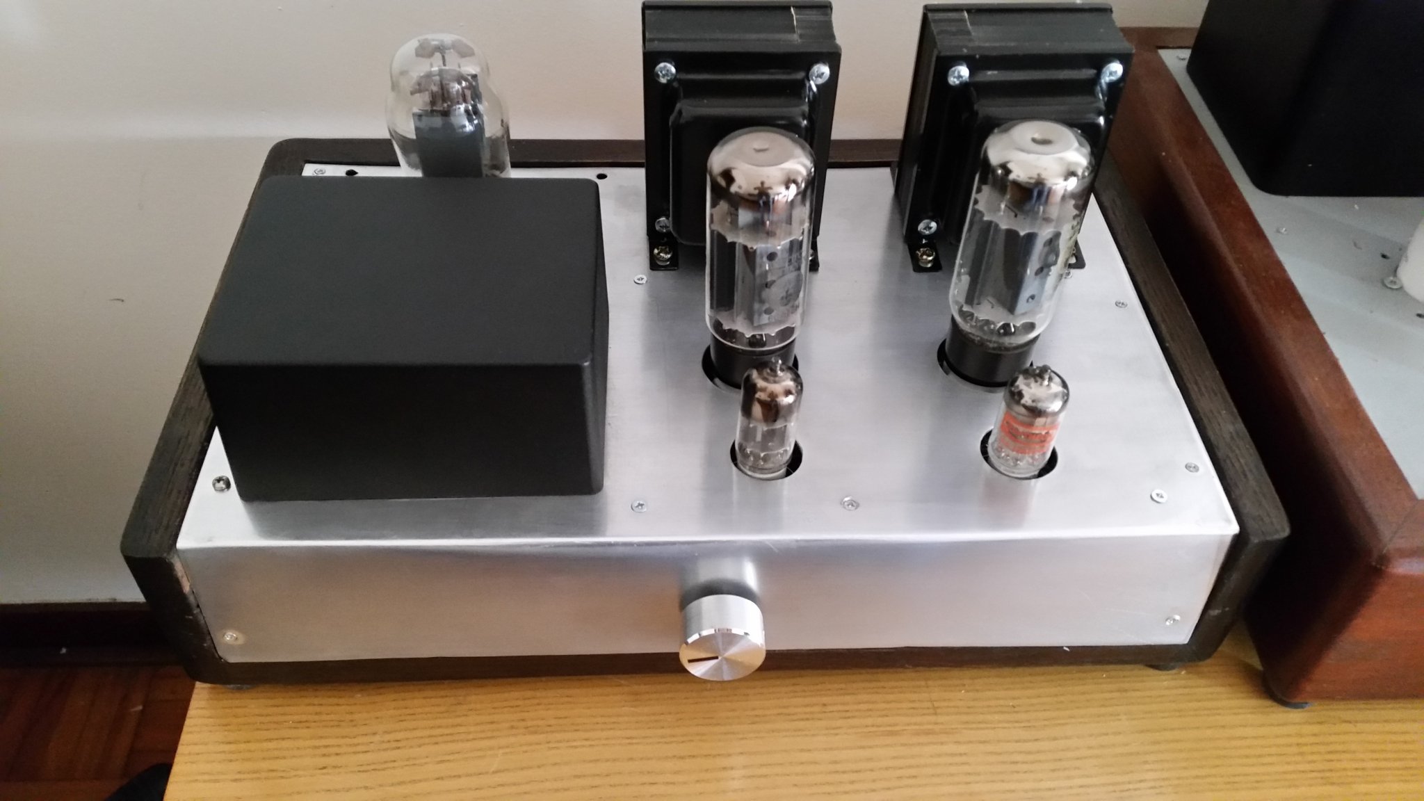

After various internal modifications to the amp: revision of the wiring (in particular ground), tube swap etc. I decided to move the toroid P.T. to the front of the chassis and thus insert the rectifier tube behi
I noticed an overall improvement on the left channel (even though is small) but then I also wanted to make a potentiometer change because it didn't convince me.
At that moment it happened that at the midpoint of the same there was a peak of "hum" on rotating the volume. After various checks I noticed a smoothing capacitor not well soldered on a pin on the heat elevator circuit so I resoldered everything nearby.
At the moment I would be fine with this, I didn't then make the suggested modification of the copper foil wrapped to the OT since there was a shipping problem from Germany.
Instead, I wanted to ask, based on the circuit at the beginning of the thread, is it okay to change the grid leak resistor from 470k to 100k? I also inserted an R grid stopper of 1K, I don't know if optional with an SRPP with the 12AT7....

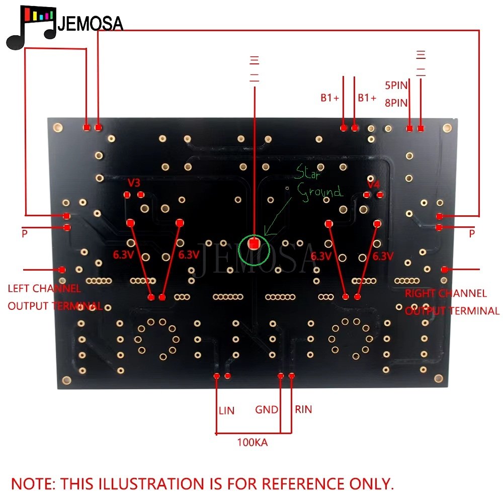

The tube sockets are linked directly to a PCB board of China manifacturing so, hoping they are designed good, I think that layout of Rg is OK like that. As to insert the 1K resistor properly I cut the pcb trace going to the input grid of the 12AT7 (lower section).

Regarding the PCB, it is already set up for the EL34 by default with pin 1 connected to pin 8 truough a track.

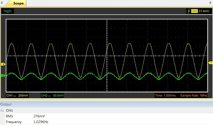

You need a 1 kHz signal source, apply it to the transformer primary.
Connect a 2 channel scope,
Channel 1 Probe tip to the plate of the output tube and transformer primary lead,
Probe ground clip to the transformer B+ connection (center tap for push pull transformers).
Channel 2 probe tip to the 4, 8, or 16 Ohm tap.
Connect the probe ground clip to Common of the output secondary.
This is a signal generator at the primary, just a low power signal. Do not put a terminating resistor or speaker load on the output.
Look at the 2 scope traces, they are either in-phase, or one sine wave is upside down versus the other sine wave.
This can be done with a closed up amplifier.

Hi, I made the measurement. Afer the primary wires of both OT being reversed (as I said above) the the sinewave seem to be on phase. No more whistle, even in ultralinear.
Here is the pic with the 1kHz injected signal. Channel 1 is connected to plate (+) and B+(gnd), channel 2 to 8Ohm output(+) and ground.

In my case from a modified PCB that I had to build around, I tried to keep the wiring in a certain order (separate power ground from signal ground) but a Chinese PCB is not great for improving on.
As for the case, be it wood or something else, I have always preferred for the aluminum top (also for workability reasons). I think the "bottleneck" is the size of the case, when I lacked with it I almost always had some issue: in this sense I was referring to magnetic coupling, the subject of the thread, when you have components that can interact being too close each other.
