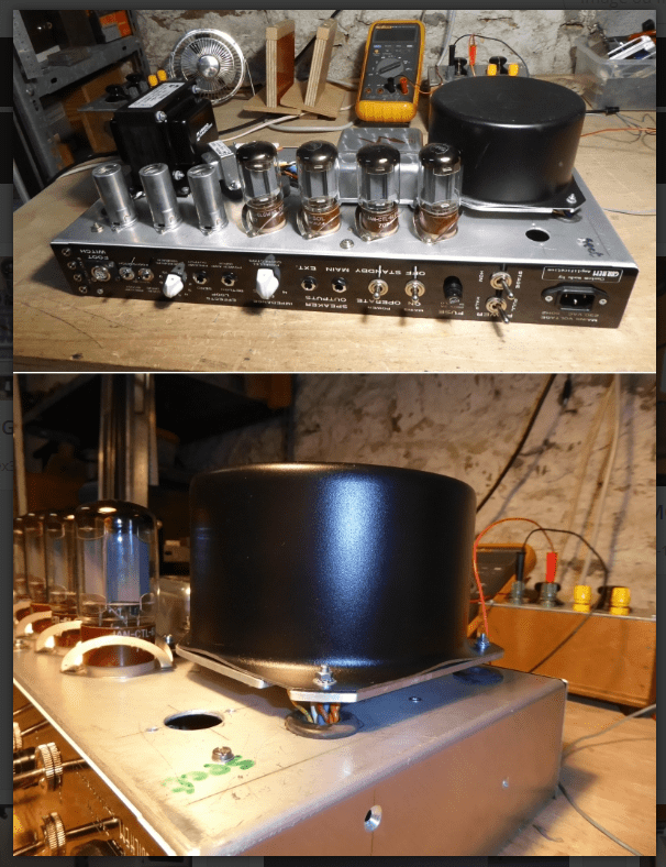

Well, as the title suggests I have the usual problem that also occurred with a previous amplifier I made... I suppose it can be the magnetic coupling between the power transformer(s) and the OT's.
Or rather it is more evident in the speaker coming from the central OT (closer to the toroidal tunnel) than in the more external one, and therefore further away, where the hum is barely perceptible to the speaker by placing an ear upon the cone.
I had told my carpenter friend to make me a wider frame, but he was wrong with the measurements and I had to settle with that...
Now my question, to avoid running into the same problem in the future is there an optimal method to minimize this coupling? I mean orientation between transf and (possible) power choke plus suitable spacing between these elements...
The support plate is made of aluminum as is the toroidal cover.

The cover of the PT is aluminium.Is the cover is steel?
That would explain a lot.
I tried to rotate the toroidal inside keeping the points where the wires come out away from OT. In a first time it seemed to have a smaller hum in the right channel, but it's tricky to find the right position (the magnetic filed is complex by itself).
The suggestion to swap the wires beetween the OTs is good. I didn't tried yet and is a simple test...
6A3sUMMER, the meral plate where thransformers lay on s aluminium too. BTW now I orderd a mu-metal sheet and I mean to wrap it internally inside the PT cover.
I tried to rotate of 90 deg. the choke but nothing change. May I have just to change the location inside the cassis (physically away from OTs)?

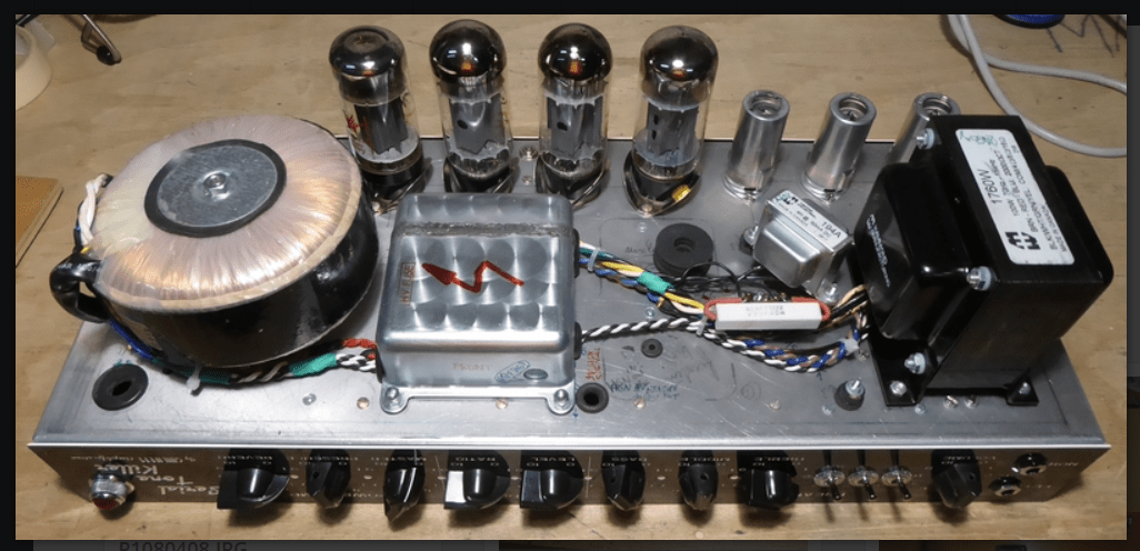

You have a toroidal power transformer... Despite what is usually said about them, this kind of transformer is far from being free from parasitic radiations of all kinds : hum (magnetic), buzz, spikes... I speak about my personal experience with toroidal power transformers, which gave me unpleasant surprises !This one below - despite being very tiny and having its transformers quite close each other - doesn't show any hum due to magnetic coupling. This comes from the orientation of the main magnetic axis radiation of their cores...
Power transformer is left-right, choke is vertical, output transformers are front-rear. All are EI transformers, with their magnetic axis at 90° each other. Conversely, the radiation of a toroidal transformer is rather omnidirectional, and so more difficult to deal with - that's what I noticed... Unfortunately :
Many years ago I built a dual-channel guitar amp using a toroid power transformer :
The amp was so full ridden with hum, buzz, adverses noises that it was unusable as is 😡... I changed for another toroid, and installed it in a shielding :
The improvement was poor, and in no way acceptable 🙁... So after numerous tests, I shifted to a classic EI transformer, suitably orientated, and fitted with magnetic "wing" screens, made from 3mm thick aliminium :
All hum, buzz and adverse noises were eradicated. End of the story... Merci, au revoir ! 😎
Needless to say that now I am suspicious about toroidal transformer's "reputed quietness properties"... 😕

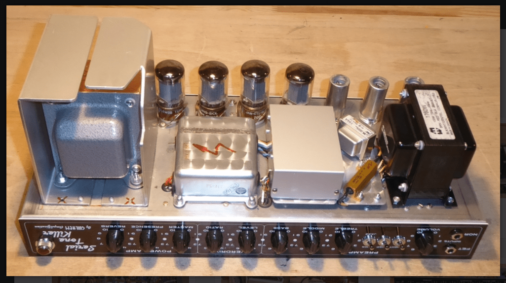

Supposed magnetic coupling with OTs

Here again, you can see the orientation of the EI transformers :
Direction 1 = Core axis maximum radiation.
Direction 2 = Laminations plane intermediate radiation.
Direction 3 = Minimum axis radiation.
As you can note, the directions 3 are "coincident" for minimum radiation. On such a compact unit, a Toroidal transformer would have been a disaster !
All transformers are EI magnetic circuits. The power transformer was intended to a Marshall 50W 2xEL34/6CA7 in class AB fixed bias push-pull. It is spec'ed for 690V CT / 350mA, while the need of the circuit is circa 110mA class A cathode bias operation.
