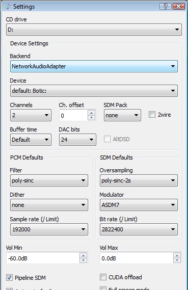

Bern, can you post a screen grab of your HQ Player settings; page 17 of the HQ Player manual refers.
I have no problem playing stereo (PCM and DSD) from HQ Player via an NAA (Beaglebone/Botic). I don't understand why you are trying to use split, in Alsa?

Hi Ray,
Ofcourse. I'm attaching a screen.

Hi Ray,
Your HQPlayer settings are what I would expect to see.
