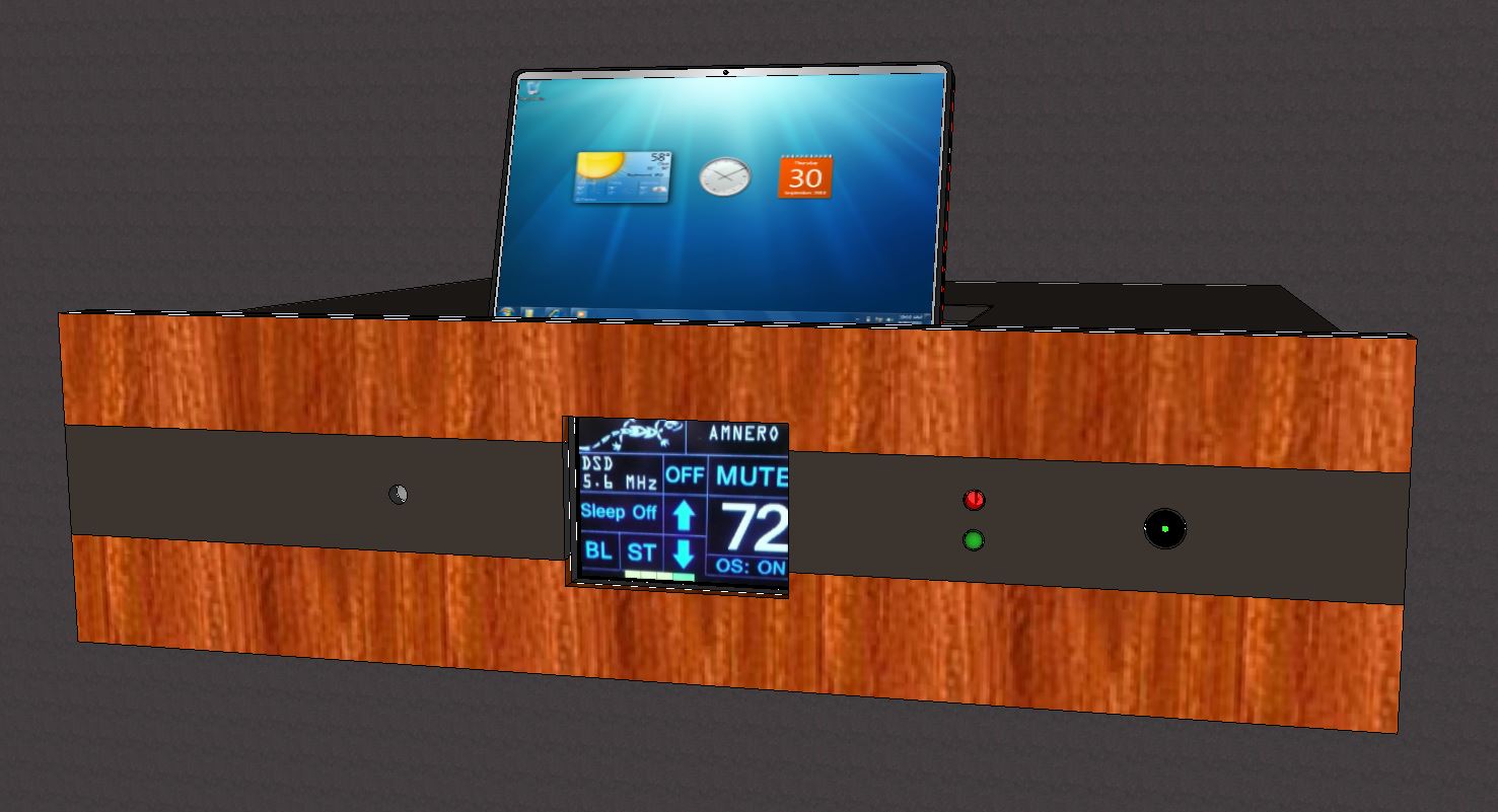

Does anyone know if its possible to run the HiFiduino code on the BBB whilst running Miero's driver etc
My ideal bit of kit would be to have a say 7" touch screen and SSD all built in to my BIII DAC so it could run stand alone, and control it all from the Touch screen and phone etc, I guess you could have 2 screens like the in the image but that doesn't seem very elegant.
