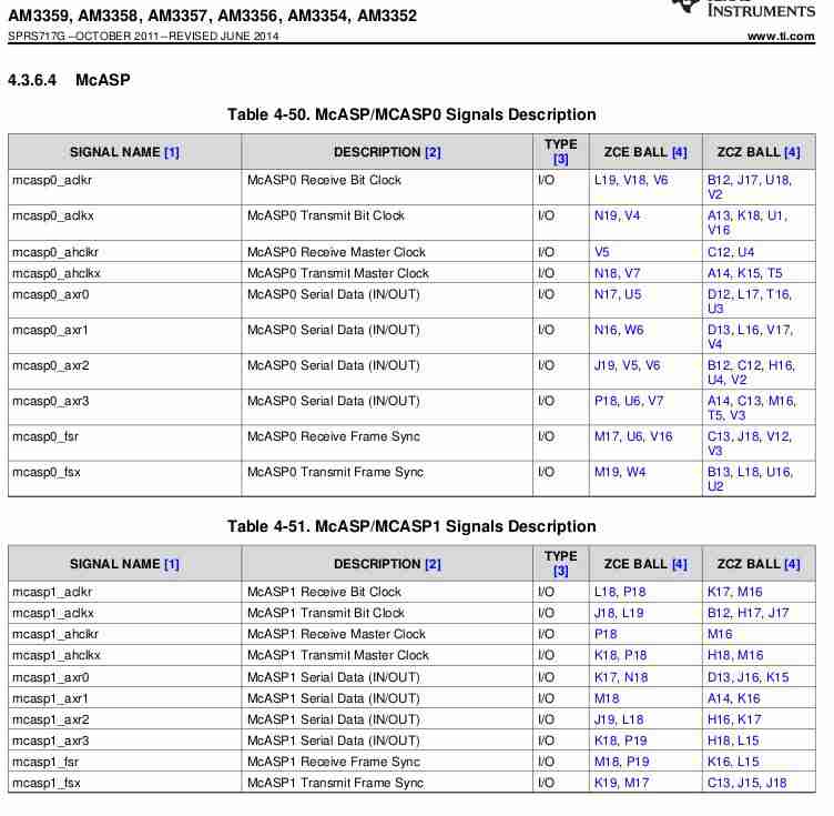

nautibuoy, because output pins on the BBB have to be switched ... DAC is able to receive data on same pins, but BBB is not able to generate both I2S and DSD on same pins.
Here is the scheme:
I2S: (BCLK) (LRCK) (DATA1) (DATA2) (DATA3) (DATA4) ... 2 channels in each data pin
DSD: (BCLK) (DATA1) (DATA2) (DATA3) (DATA4) ... 1 channel in each data pin

nautibuoy: Ah, plain but difficult question at the same time .... here is my best guess to explain the issue:
I'd rather say it caused by design choice of some DAC designers... to multiplex I2S and DSD support into single chip they reused clock pin (LRCK) to carry audio data ... digital sources usually separates pin to clock pins and data pins ... but in DAC like ES9018 (and others) those pins are mixed together (rerouted inside a chip).
But it's non-compatibility on both sides:
- DAC designers saves 1 pin by multiplexing I2S LRCK signal with DSD DATA1
- CPU designers saves internal circuitry by not allowing to route LRCK and DATA signal to same pin.

nautibuoy: unfortunately, this is not possible...
If you peek inside the "AM335x SitaraTM Processors" manual named sprs717g.pdf, you will find that it is not possible on any am335x processor.
The mcasp0_fsx does not have common pin with any mcasp0_ax? pin. Same applies to second mcasp1 channel.

Ah! so it is in fact a constraint of the BBB hardware after all (or more likely the firmware of the processor).
So, if it isn't possible to utilise the native hardware layer the next question is whether a work around is possible.
I know you've done some good work on detecting the native sampling rate of the audio data and arranging for the clock speed to be switched on the fly to preserve the native sampling rate. I also know that you are detecting whether the audio data is PCM or DSD format. With that in mind, would it be possible, within your driver, to remap the gpio pin assignments on the fly, depending on whether the audio data is PCM or DSD or is enacting the mcasp configuration file a 'done once at startup' action?
Remapping the pins on the fly is essentially all the Botic PCM/DSD switch is doing, based on information that is passed to it from the BBB. Can you pull that back to be a driver function?
Sorry to labour this, as I said, I don't even have any DSD files, but I would really like to bottom this out and I'm sure many others would find it useful. It's also good to exercise one's mind on these sort of puzzles.
Perhaps I should shut up now.
Ray
nautibuoy: aren't you really trying to reinvent "the wheel"? 🙂
there is no autodetection for sampling rate or audio data format ...
the audio driver knows exactly what it is playing and it toggles GPIO signals for EXTERNAL clock selection and i2s/dsd routing
the external switches on botic board is exactly that workaround you are looking for, but it was already designed months ago 🙂
Or have I missed something? 🙂
