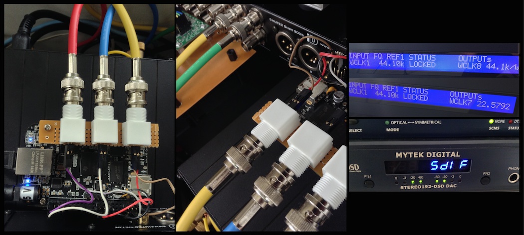

SDIF connection from Botic BBB to Mytek Stereo 192 DAC
Hi there,
Well, this is just for fun because the thread has been rather quiet for a while 🙂.
With the botic drivers and MPD supporting native DSD, I tried to know how the serial DSD data can be used for classical SDIF connection using a mastering version of Mytek Stereo 192 DAC equipped with SDIF digital inputs and iD, a clock generator/distributer from Mutec, Germany, that can provide word clock for SDIF connection and master clock for BBB, as shown in the figures below.
As Mytek has both of WCLK In and Out, the output was used as a reference signal for the iD (44.1K REF1 in the figures on the right) to produce MCLK (shown as WCLK7 22.5792), that may imply the BBB working as a slave.
As seen in the figure on the left, P9_41 connects to the red BNC cable as SDIF-R and P9_30 to the blue one as SDIF-L with MCLK input to P9_25 from the yellow one as described above. The green cable in the middle is the WCLK sent to Mytek (shown as WCLK8 44.1). So you might notice that P9_31 is not used for this SDIF connection.
After that, I switched Mytek to SDIF to check the validity of this connection. With both of SDIF-raw and SDIF-3 settings, the results were quite satisfactory with my DSD128 sources, providing flawless sound quality well comparable to that with my BIII/IIISE systems with BBB-botic.
Have a nice weekend 🙂.
