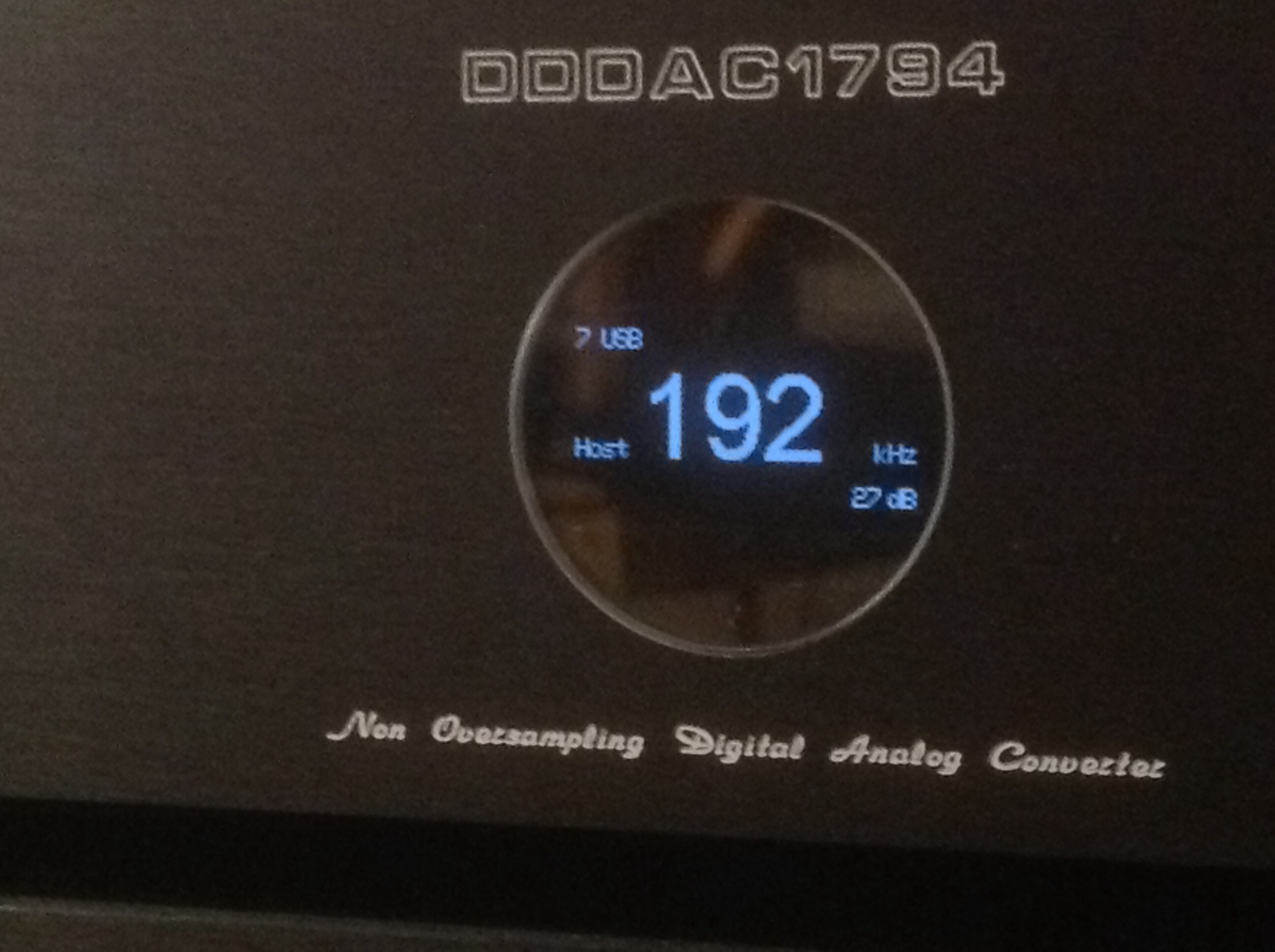

I believe it's a better way to use an additional microcontroller to drive a display. For DDDAC1794 with WaveIO I developed a small board using a PIC and some of Adafruits OLEDs.
My plan for BBB ist to use the same board with different PIC software using I2C to get all informations (sample rate, play status) from BBB.
@Miero: Do you see a way to do this?
Thanks in advance.
