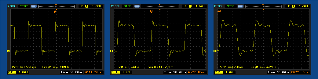

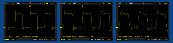

BTW, shown below are BCK (DSD CLK) waveforms from BBB/Botic/NAA when playing DSD sources
upsampled to 128, 256 and 512. Even with DSD512, the waveform appears not bad, doesn't it? 😉

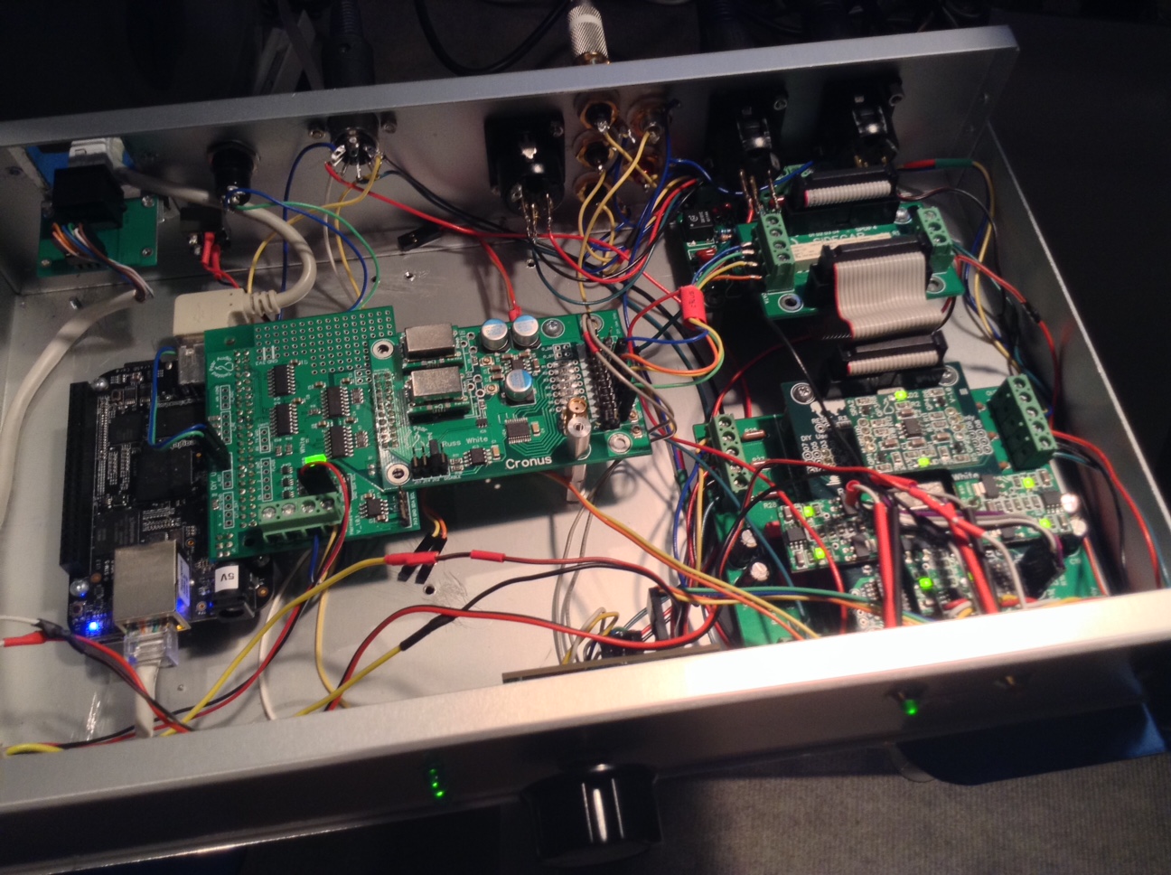

Exactly. I have each of B3 and B3SE connected to BBB/Hermes/Cronus, both with 45 and 49 clocks. Shown below is the B3 in the case, which playing DSD512 as of taking this picture.
Here is a very good news. With each system, I noticed that there had been no xrun errors when playing DSD512 sources with duration of at least one hour, though I wrote that the error might occur once in 20 to 30 minutes in the previous post. Below is the entire log of playing a CD rip from the beginning to the end. Please notice there has been no xrun errors.

Also, I have a Botic board for BBB assembled along with the original instruction by miero at http://bbb.ieero.com/. The board shown below includes 2 sets of 2:1 MUX for DSD/PCM and 44.1/48 clock switching with an isolator (ISO7640fm) for the output of I2S/DSD signals. A CCHD-957 22.9752 and an Epson 24.576 clocks are used for this system. The output connects to B3SE via Teleporter.
This board also works as BBB/Botic/NAA and playing DSD512 is quite stable for a few hours at least. I didn't notice any xrun error and also there has been no complication of noisy background noticed in 45/49 clock systems.
I can not explain why such a difference between 22.5/24.9 and 45/49 clocks can occur in terms of background noise. I'll be happy if there is anyone who can explain it.

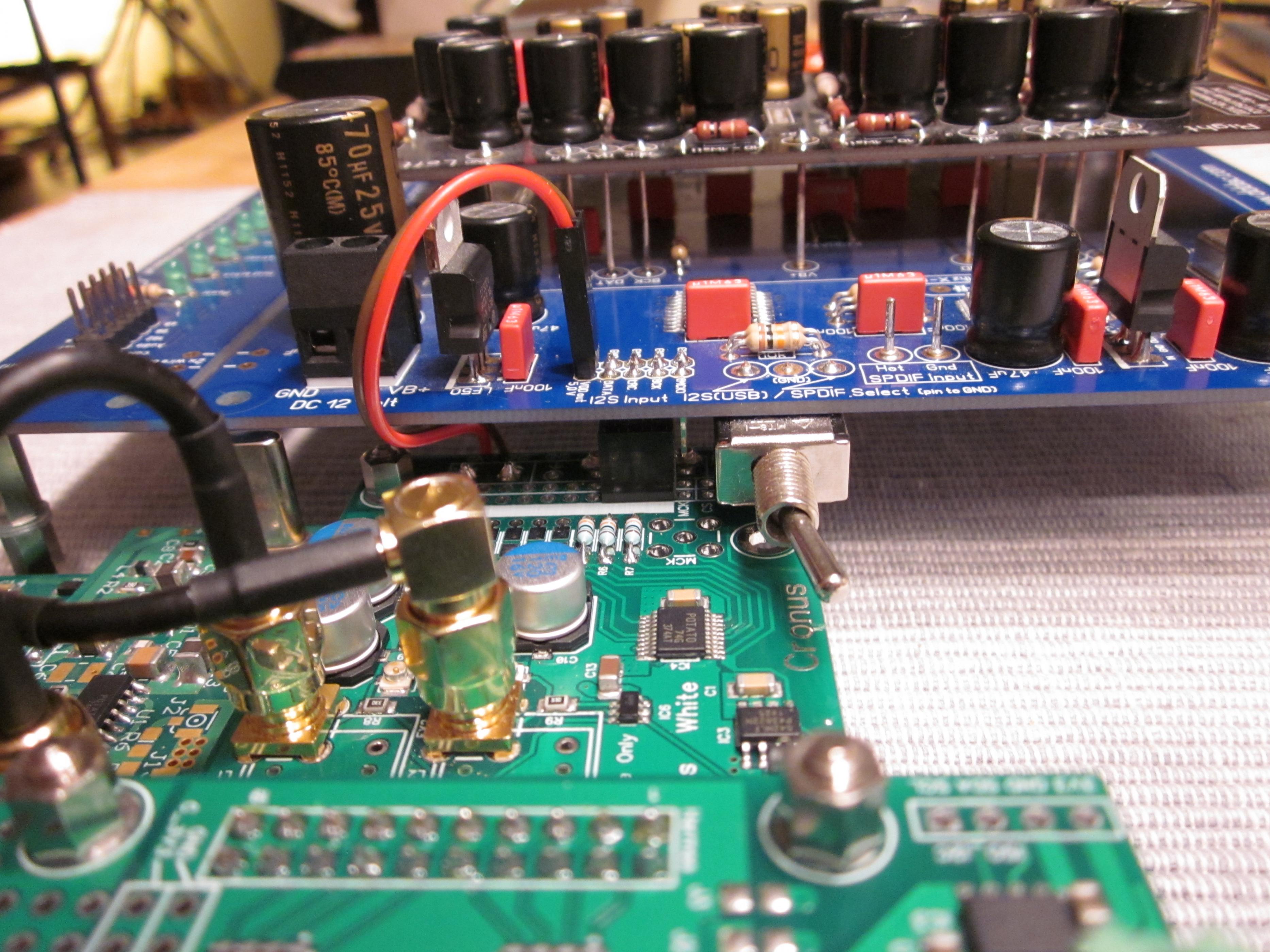

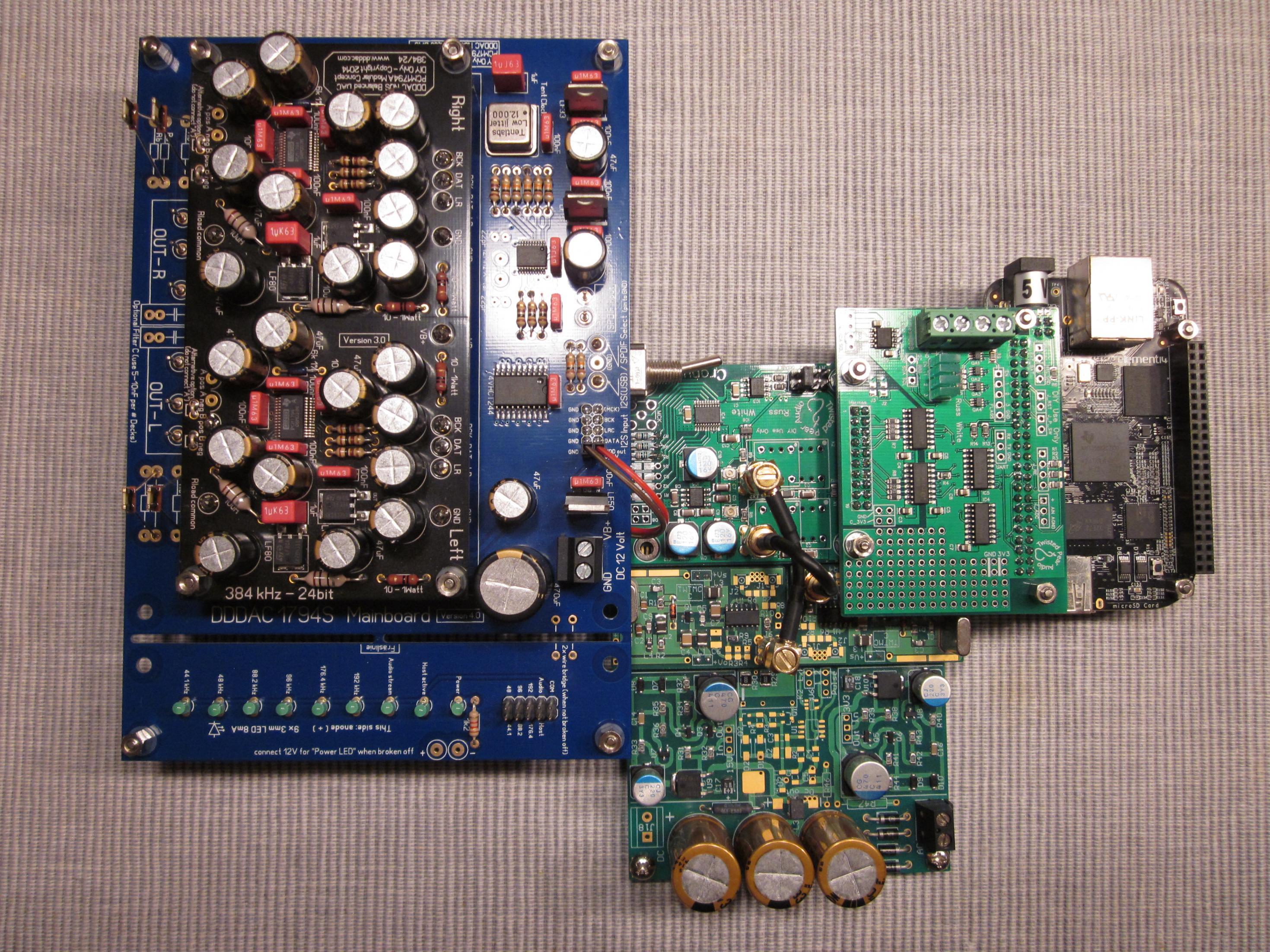

i2s-lines delayed
Hello Miero,
I managed to get my system working. BBB > Botic5 > Hermes > Cronus > DDDac. I am using external clocks (http://www.diyaudio.com/forums/digi...ow-phase-noise-jitter-crystal-oscillator.html). The system works flawless.
Thank You very much for Your fine piece of art!
As I am using a multichannel all-horn-system, delay lines are essential.
My question is whether I can use three of that four i2s-lines delayed by Botic OS. If that is possible basically, I think the real challenge might be to tell the system the needed delay in msec respectivly fractions of msec valid for all possible sample rates.
I am not interested in digital crossovers whatsoever. So there is no need for that. The signal should not be modified in any way, just delayed.
Hans
