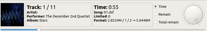

Or perhaps I'm misreading your table and you're upsampling DSD64 to DSD256 in the first set of results?
Yes, that is the correct interpretation of my table. DSD64@5.6448 means that the bit rate of a DSD64 source is up-sampled to 5.6448 by HQP as shown by the picture below. Sorry for this confusion.
I have some DSD256 recordings that I plan to load onto the BBB and play with MPD but I'm convinced that'll work perfectly.
Ray
Yes it does work. MPD on Botic-BBB can play DSD256 sources without any problems.

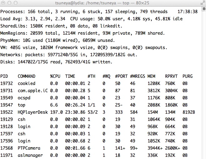

Thank you for your latest report. Following my previous experiment of BBB/Botic/NAA on the HQP running on Ubuntu, this time, encouraged by your comment, I checked the capability of this conduit from the HQP running on my MacBook (13-inch, Mid 2012, 2.5 GHz Intel Core i5) with my B3SE as a connecting DAC.
To my surprise, the HQP on my MacBook could almost completely play 44.1/16 flac sources upsampled to DSD256 as shown below, even permitting the situation is partly dependent on the filter selection. Only a few unlocks per minutes which were little annoying on listening to music. I think the B3SE is also greatly contributing to this result.
As shown by another picture below, the CPU usage on the MacBook is about 197%, indicative of about 40% usage per core, while the usage on BBB is about 20%: that would be not bad.
The results of mine are quite suggestive of the capability of BBB/Botic/NAA being able to deal with these Red Book sources upsampled higher to DSD512 as long as the HQP is running on a machine with more powerful CPU (not necessarily i7 6700K).

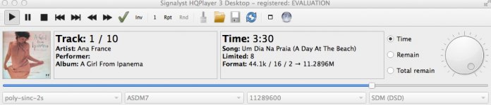

I have a reasonably powerful workstation running HQPlayer (Intel Xeon E3-1240 @ 3.30GHz, benchmarks at around 8000) so I gave DSD512 a try and it almost works; it plays fine for maybe 10secs at a time but is interrupted by a machine gun like sound. HQPlayer CPU loading was around 60% (on all four cores) and network load was close to 50% on the dedicated 100Mbps Ethernet connection. I neglected to note the load on the BBB as I stopped playback quickly because of the noise.

Is that with Pipeline SDM enabled and -2s filters, such as poly-sinc-short-2s? I think it could actually work...
I think the bit rate of 5.6448 x 4 (= 22.5792) instead of 24.576 might work.
As I mentioned to you before, the 'Auto rate family' check box means HQPlayer will automatically select the appropriate integer multiplier based on the source material rate.
With the settings as they are, if the source is 44.1KHz then HQPlayer will set the DSD rate to 22MHz, if the source is 48KHz the DSD rate will be set to 24MHz.
Upsampling 16/44.1 PCM files, HQPlayer does indeed automatically set the DSD rate to 22MHz with these settings.
