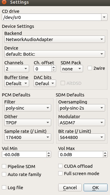

An update on my BBB/Botic/NAAadventure...
I set the networkaudiod process to 'nice' value of -20 and priority to 'rt' (FIFO) but I'm still experiencing occasional dropouts with DSD256. DSD128 and PCM up to 192KHz seem OK. DSD256 playback is fine most of the time, I'm getting a dropout every couple of minutes or so (typically once or twice during an average length song) .
I've been monitoring using 'top' on the BBB and the Windows 10 performance monitoring tools on the HQPlayer computer. On the HQPlayer computer the dropouts show as a 'glitch' on the network and cpu graphs.
To try and isolate the problem to the BBB I've been doing the same monitoring on my other NAA setup, which uses a more powerful Intel NUC device (1.6GHz processor and Gigabit network port). The NUC drives a USB DAC. Apart from the NUC replacing the BBB everything else is identical, even the music tracks. On the NUC 'top' is telling me that cpu load is around 3-4% and on the HQPlayer computer the cpu and network graphs are all but flat lines with absolutely no glitches.
I believe that is telling me that the problem is with the capability of the BBB. I'm wondering if the issue is network related rather than cpu; the BBB has a 100Mb network interface and DSD256 presents a constant data stream of 24-25Mbps so perhaps my initial conclusion that DSD256 is marginal on the BBB was correct.
Any ideas/suggestions?

Hi Ray,
First of all, thank you for giving me a chance to try HQP with NAA using Botic system. Out of curiosity I followed your instruction skipping installation of gcc-6-base and libstdc++6 after making a basic debian-stretch system and proceeded directly to installation of botic image and NAA with update of libasound2. After that, I confirmed the Botic system was well recognized as NAA on the setting panel of HQP running on Ubuntu Desktop as shown below. BTW this Ubuntu is virtually running via Parallels Desktop on my MacBook.
Despite this limited CPU performance on a virtual system, playing DSD128 and DSD64 sources with a 5.6448 bit rate went quite smooth without any glitches as well as FLAC sources of 44.1/16 up-sampled to 176.4. Playing these DSD sources with a 11.2896 bit rate, however, became quite sluggish but this was mainly due to low-powered CPU performance on my MacBook and I did not recognize any further additional glitches related to data processing. BTW the Botic-BBB with MPD can play a DSD256 source from 2L without any problems.
So it’s my impression that Botic-BBB system will be quite promising as an NAA working with HQP as long as you can use a PC of appropriate power for HQP, though this is not a style I'm looking for as an audiophile.
Below is the record of CPU loads from top command in various conditions. My poor MacBook can not deal with the huge appetite of HQP 🙁 but the Botic on BBB appears well dealing with the demand from it 🙂.

Thanks twluke. I think you've essentially confirmed the majority of my observations, the only difference being with DSD256, where my HQPlayer PC is barely breaking into a sweat upsampling 16bit/44.1KHz PCM to DSD256 (CPU loading of around 32%). DSD256 is faultless when I use my Intel NUC as the NAA device.
A suggestion regarding your HQPlayer settings; check the 'auto rate family' box and HQPlayer will automatically set integer upsampling rates (for example, 4 x 44.1KHz = 176.4KHz whereas 4 x 48KHz = 192KHz, so in this instance just set the max sample rate to 192KHz).
I'm a bit confused by your table of results regarding DSD rates. The original DSD (i.e. SACD) has now become known as DSD64 (64 times the CD Audio sampling rate of 44.1 kHz) with a bit rate of 2.8224MHz (or 64 times 48KHz = 3.072MHz).
Double rate DSD = DSD128 has bit rates of 5.6448MHz (128 x 44.1KHz) or 6.144MHz (128 x 48KHz).
Quad rate DSD = DSD256 has bit rates of 11.2896/12.288MHz.
Octuple rate DSD = DSD512 has bit rates of 22.5792/24.576MHz
Or perhaps I'm misreading your table and you're upsampling DSD64 to DSD256 in the first set of results?
I have some DSD256 recordings that I plan to load onto the BBB and play with MPD but I'm convinced that'll work perfectly.
