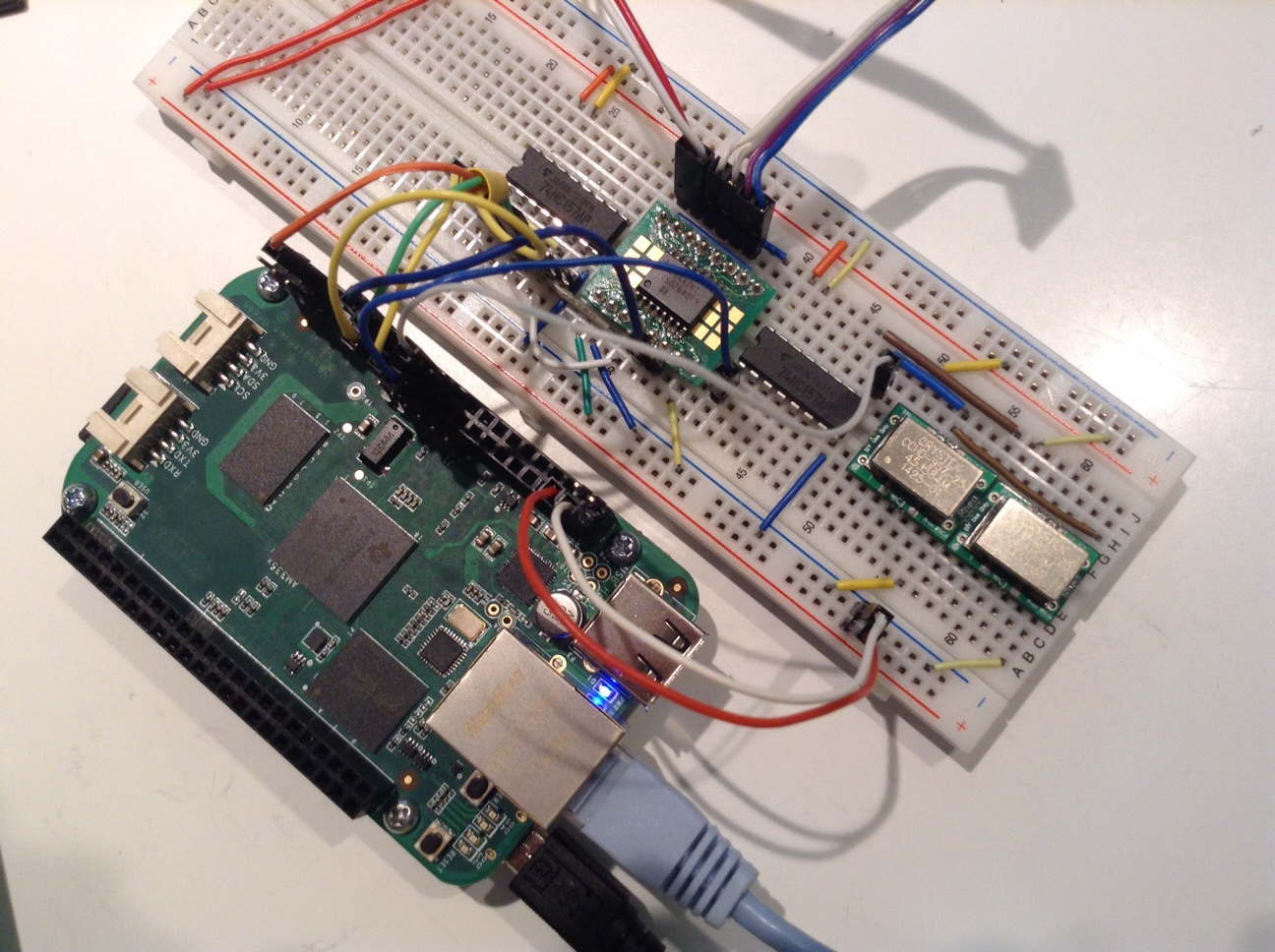

After the latest patch by miero, the BBB/Botic/NAA for HQP became well stabilized. However, Even after this remarkable improvement, there still remained a problem.
I wrote before:
Of course, there is one problem. After getting started with playing music, a kind of background noise also appears. This is faint and similar to the sound of wave at the shore, probably associated with the process of DSD locking. This noise soon disappears but reappears at some point, though there was no regularity. The situation is common through both B3 and B3SE.
I noticed this faint background noise is still persistent, particularly when using the Hermes/Cronus with 45/49 clocks for DSD512 output to the B3SE with its DAC clock still configured as it is. However, I also noticed that this noise, probably related to the DSD locking, became totally absent when listening through my customized BBB/Botic/NAA system with 22/24 Crystek clocks, that had no reclocking function like the Cronus.
On the assumption that the noise may be associated with this function, I assembled another customized BBB/Botic/NAA system with 45/49 Crystek clocks connected to B3SE via Teleporter as shown below. As expected, this system well eliminated the noise and I could listen to very clear, almost transparent DSD512 sound, probably better than with 22/24 clocks.
I'm well aware that the situation may be different if the external clocks are used as master, but, if not, the BBB/Botic using Hermes/Cronus with 45/49 clocks may be less suitable for NAA, though I can not explain why.
Forgive me for not following more closely. Could you clarify the clocking scheme of your 'custom' system? I assume the Crystek clocks are feeding the BBB directly, correct? ...but nothing else? ...and frequency divider?
Hi Frank, you are always welcome and thanks for this question. 🙂
The clocking scheme is quite accordant with the miero's instruction, in which the signal lines from 44.1k/48k clocks first go to 2:1 MUX controlled by the external master clock switch from P9_24 and then the output goes to P9_25 (a grey wire in the last picture I posted) just for feeding as you wrote. There is no frequency divider in my system. BTW, the PCM/DSD signals are sent to the B3SE via an isolator(ISO7640FM) with different Vcc.

So, when based on your latest comments, Cronus' reclocking function may not be the source of this locking(?) noise. Then the next question will be thrown on the stability of bit clock (or DSD clock) rate actually used by B3SE.
In case of B3SE in slave mode like yours, I think the BCLK deriving from the external clocks is going to be used by B3SE but if the DAC clock of B3SE is still working as a master like mine, then the final BCLK is going to be formed by the B3SE's 100MHz DAC clock handled by ES9018. Thus it can be said that this difference may finally appear as the difference in the amount of audible noise. Just my humble speculation.

Do we agree that, with your Hermes/Cronus and my alternative isolator/reclocker arrangements, we seem to be experiencing similar patterns of the static-like noise with DSD512, regardless of whether the B3SE is using its onboard oscillator or is getting it's clocking from the reclocker (and the noise fades away and is absent most of the time)?
I am not suggesting that the isolation/reclocking is not the cause of the noise; the evidence we have (in the form of your prototype build in post #1811) suggests that it may be. My reasoning for wanting to try a no-DAC low pass filter is simply that they have no data rate limit and don't use clocking, thus eliminating some of the variables.
Considering your prototype build, it would be interesting to compare the quality of the data signal output from your prototype versus the data signal from your Hermes/Cronus; maybe Cronus is reclocking data that doesn't actually require it and so might just be adding complication (and noise)?
Yes we do. Actually, I found that the similar noise did occur for a tenth of second, very short, at the beginning of track even on my prototype system with either 22/24 or 45/49 clocks, which has been otherwise mostly immune to this noise for long playing.
Okay, I understood what you are trying to address.
This comparison is interesting but for now I have no idea how I can set up a protocol necessary for this experiment. What I have now is only an analogue scope...
