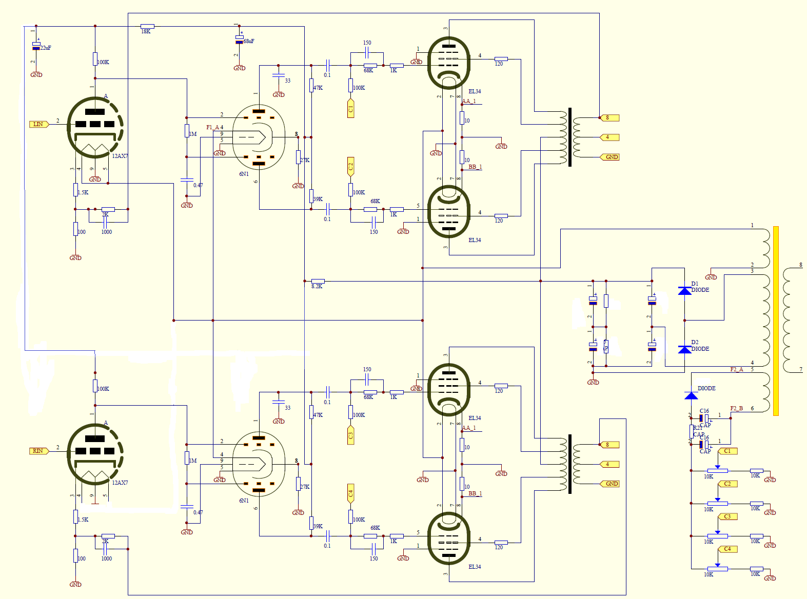

The schematic of EL34 is ready. just post here and one copy on Bigjppop's post:
http://www.diyaudio.com/forums/tubes-valves/160924-new-suppo-audio-el34-amp.html#post2081103
Joed

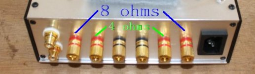

1) No instruction manual, OK you don't need to know much but the tubes arrive with numbers on but no diagram to indicate which is socket number 1 etc. Also the 4 Ohm & 8 Ohm terminals are not labelled again a diagram would help.
Note: I found the info on the Suppo web site at:
http://www.suppomodel.com/audio/pic/rare.jpg
and
http://www.suppomodel.com/audio/pic/tubes Number.jpg
2) My amp does not apear to have the updated DP Switch & fuse etc. However I have not taken the covers off to confirm yet.
