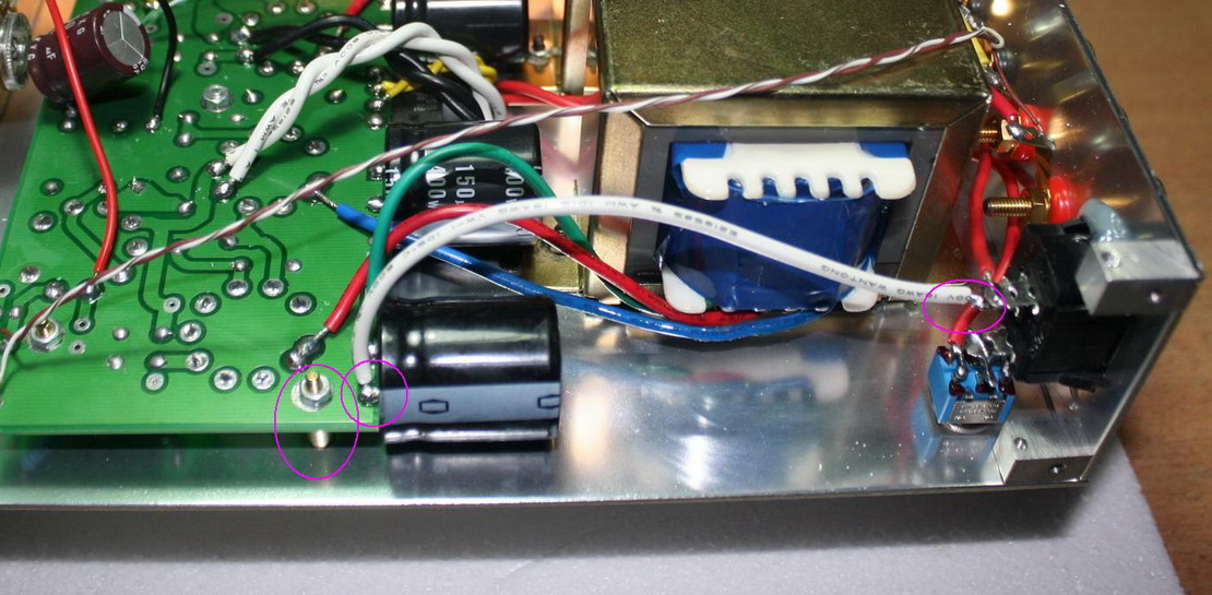

Just a short message first,
We are upgrating the EL84 now they will have new case in 4days. this AMP will have fuse installed. But in our test, no fuse better than fused. that fuse will effect the sound. We don't use fuse in our own listening AMP. some one wil say dangerous. Oh yes, just depend on how you evaluate and control the risk.
Earth grounding issue: we connect the earth via the PCB to chasis and to the power socket. isn't that enough? or we should do more?
we will change the Vol pot and the power switch. should not let the machines fail just because of this two small parts.

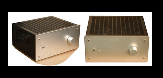

the V2 case of EL84 would look like the EL34 shown on our website. but smaller size.
The EL34 price: we will set a good price for our DIYaudio members. special price for DIYaudio member around $360-$400. this AMP weight around 17-20KG with packge, maybe more. So the shipping cost is expensive too (around $180). If people can group-buy 3AMP, then we ship 3 together, then will be $450($150 each).

sorry, forgotten: not only the volume pot are fakes, capacitors in china, Rubycon , Wima, etc etc. brands are fakes as well. there is a long, long list which i have to deal every day. here in shenzhen huaqiang bei road, futian district. a lot of this stuff is sold. worse than that: the sell also used components after cleaning them up. ICs, capacitors, or, selling components, which fail customers request for performance and being rejected. manufacturers purchase departments will buy them and built into devices...so it comes to a cheap product. next worst: manufacturers ("engineers") even dont have suitable equipment or the knowledge to test their products. data publishing is therefore rare.....chinese companies come and go as the weather does. as a tester here in this blessed countriy, i could tell you nice stories. and tube amps are a big topic.

Do you have any specific information on this amp or is this another "all Chinese stuff is junk" comment.
there are some good manufacturers around, which are doing that vacuum tube amp business seriously. so, not all is junk, but quite a lot, to maka fast money. as an example i may tell you, that the output transformer used in this discussed ( EL84 / 6BQ5) amp costs no more than 10..12 US$, or even less. here are plenty of "NOS" tubes available, a 6P1 = 6AQ5 costs no more than 90 cent US etc. 6Nxx tubes are even more cheap, as they were mass production for the chinese army, tons here to sell.
later on, i will test this "amplifier", and if Joe wants to contact me on behalf of this, we will see. safety is for sure, to fail, as ist is presented on the internet.
to me: i am working for a big well known testing company with world wide 35000 staff operating as a tester and consultant especially in audio / video business here in china since 12 years.
you know: if these amps are not designed carefully, things may happen. i myself design tube amps since about 45 years, yea, i am over 60. i think, i know a little bit about that.

Hi DMKBOX,
We think the EL84 GV-2 case less of space. and it is easy to be damaged in transit. difficult to fit a fuse inside. would you take the new and largeer case, similar as the EL34 beta?
the EL84 is a small AMP that fit small room and smooth music.
EL34 too expensive? lets see if we can do something for diyers. like the review discount as the EL84.
