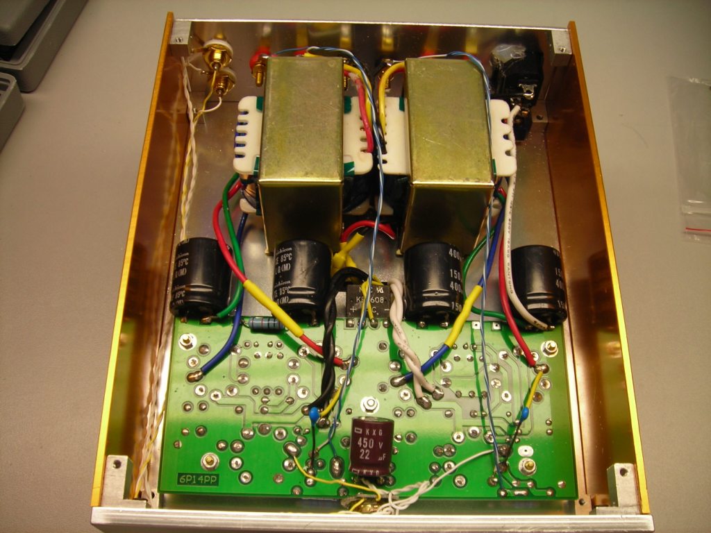

I received my Suppo Golden Ear amp today and hooked it up to my Fostex FX120 bass reflex monitors. I am using a modified Playstation 1 as a CD player.
I have to say that my first impression of this amp is positive. The balance is a bit leaning to the right channel--it floats to the center and than slightly right of center. I am not sure why this is, but it could be the volume pot. I hope that's all it is.

I might be able to add something useful here, having bought a few cheap Chinese amps over the last 2 years or so. (When I say "cheap" I mean sub-$400 amps.)
It won't be too hard to tweak this amp if one felt the urge, some other amps from China have much more difficult access to the PCB, so this is a plus IMO.
Nice to see it has 4 and 8 ohm speaker outputs on it. Also the company appears to have a tube tester to match the output tubes, good to see. It does appear that Suppo are selling a value for money product rather than "just another valve amp."
This Suppo amp appears to have a relatively decent schematic so no problem there. The power supply looks a bit unusual with 6 x 220uF caps on it, and no C-R-C network, can someone confirm that? If the power transformer is undersized it will get hot, the 80W spec on the webpage, I wonder if that's the transformer rating or the max power the amp will draw from the mains?
On a new amp its a good idea for peace of mind if you can measure (or get someone to measure) the B+ and heater voltages to make sure the power supply cap voltage ratings are OK and the heater voltages are within spec. Then measure the voltages across the R11 and R20 cathode resistors on the output tube pairs and calculate the approx power dissipation for the output valves. If all is within limits then good.

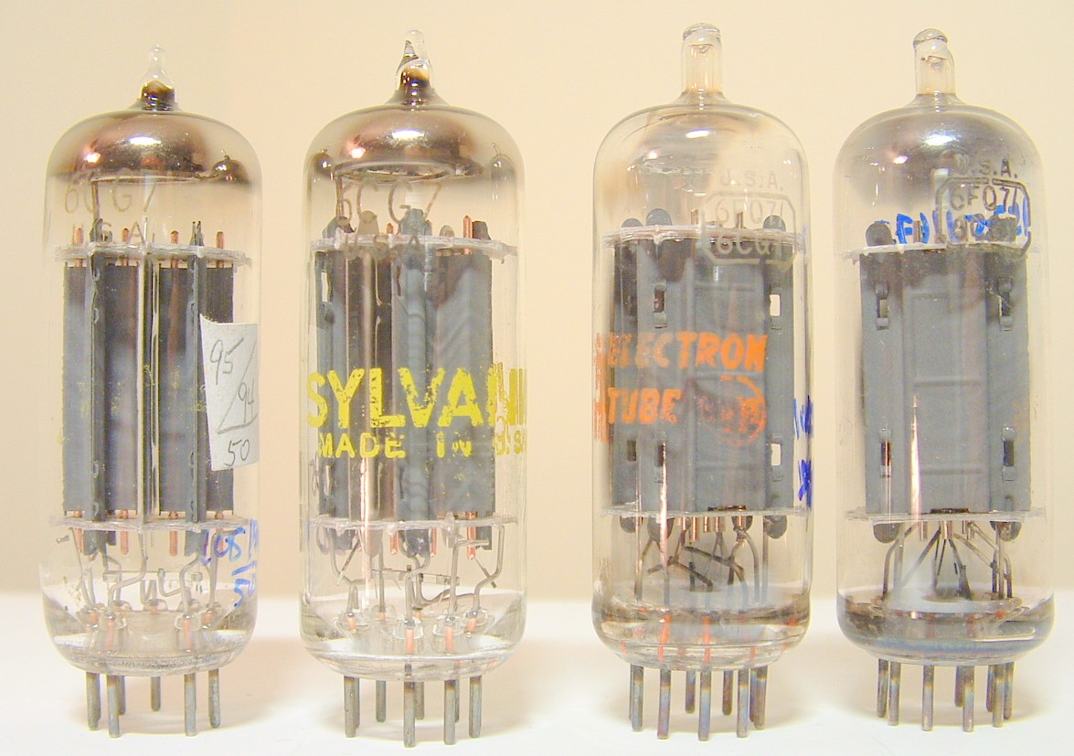

Taking advice from Joe, I just installed a pair of OS RCA 6FQ7 clear tops in place of a pair of Russian 6N1P-EVs, and there's just no comparison, even with the stock 6P15 power tubes still in place. Later this week, I am expecting a matched quad of new production Genalex Gold Lion EL84s. To date, I've replaced the input wiring with Teflon-insulated Silver wire, replaced the stock RCA connectors with Teflon-insulated RCA connectors, and I put in a 50k SMD resistor stepped attenuator.
This really opened up the sound and with the RCA 6FQ7 drivers in there, it is really rich sounding. I hear greater bass extension and definition, a focused image with spacing between instruments and vocals and a larger soundstage. I also bought a pair of OS Sylvania 6CG7 tubes to try out as well. These tubes are almost as tall as the EL84s.

bigjppop, you'll hear a bit more bass extension with more driver break-in on your Omegas and stand mounting. This amp sounds really good with my Fostex FX-120 monitors, but with full range speakers like the Klipsch Forte IIs, it really sings with bass down to the 30's.

Hi, I got the old version and it was unfortunately damaged from transport. The toroid was loose in its case because the package apparently had been transported upside down. The weight from the toroid had drawn its bolt through the 2 mm thick chassis. The hole for the bolt was already drilled a bit too big which did not help. The toroid had to be taken out of its case but this could only be done in a destructive way. I also needed to remove the output transformers but their screws were covered by the case with the toroid. So it was not very service friendly.
Joe was very helpful and offered to send me a new revision of the amp. Of course I accepted his offer and waited patiently. Two weeks ago the amp arrived. I was away last week and haven't listened yet. I did power it on with resistors at the outputs and it becomes hot indeed. Not too hot but class T amps made me forget that amps can get hot !
It has 3 mm thick panels so no sagging of the upper panel and the build quality is better than the old version. The bottom panel is also 3 mm thick. It is also better layed out internally. The side panels are black now instead of the orange of the first model. The output transformers are better placed and the power transformer is a classic power transformer bolted down with 4 bolts.
So better build quality and a better chassis. I probably will drill several 4 mm ventilation holes in the chassis just after the valves/tubes and in the bottom panel as it is completely closed now causing heat buildup that can be avoided. Better convection for better longevity of the amp. It also lacks a power fuse which should be there IMO. No loose screws etc. like with the old model. If you have any questions about the differences please let me know as I still have the old one for comparison.
