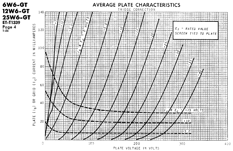

I know that this thread is a little old, but perhaps I can get a couple of questions answered. I like the 6SN7 but am obsessed with the 6W6GT. I’d make a computer with them if I could. Anyway, would it be possible to adapt this circuit to use a 6W6GT in triode running at around 25ma without too much trouble? If so, what alterations would you suggest?
Thank you for your help.
Link to the circuit:Super Triode Connected (STC) chip amp
1. Increase CCS from 8mA to 25mA, 300R to 100RWould it be possible to adapt this circuit to use a 6W6GT in triode running at around 25ma without too much trouble? If so, what alterations would you suggest?
2. Decrease plate resistor to account for the higher Ip current
3. Increase Feedback coupling cap to account for lower output impedance.
IMHO, I would keep it at 6SN7, The change will result in a bigger NFB coupling cap. Not so sure it is for the better or the worst.

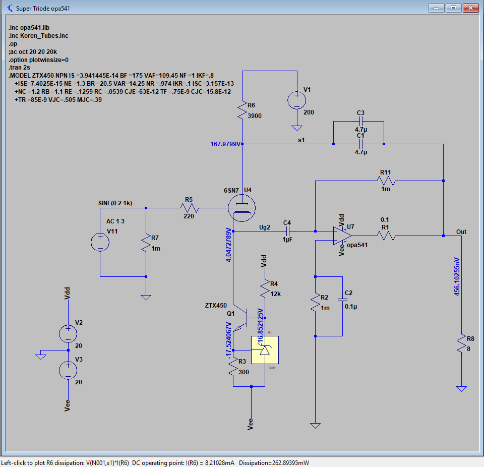

based on the info from TubeCAD, I built a super triode connected chip amp. <snip>
Hi FYC, I am very interested in your implementation. So, I quickly made a LTspice simulation. However, it seems that there is no so signal entering opamp's inverted input, can you confirm the feedback resistor and capacitor value for us?
Here attached are screenshots and LTSpice circuit files.
Try R2 and R11 as 1 Megohm rather than 1 milliohm
Damn! my silly mistake. Thanks tikiroo, after changing them into 1000k, things seems ok now

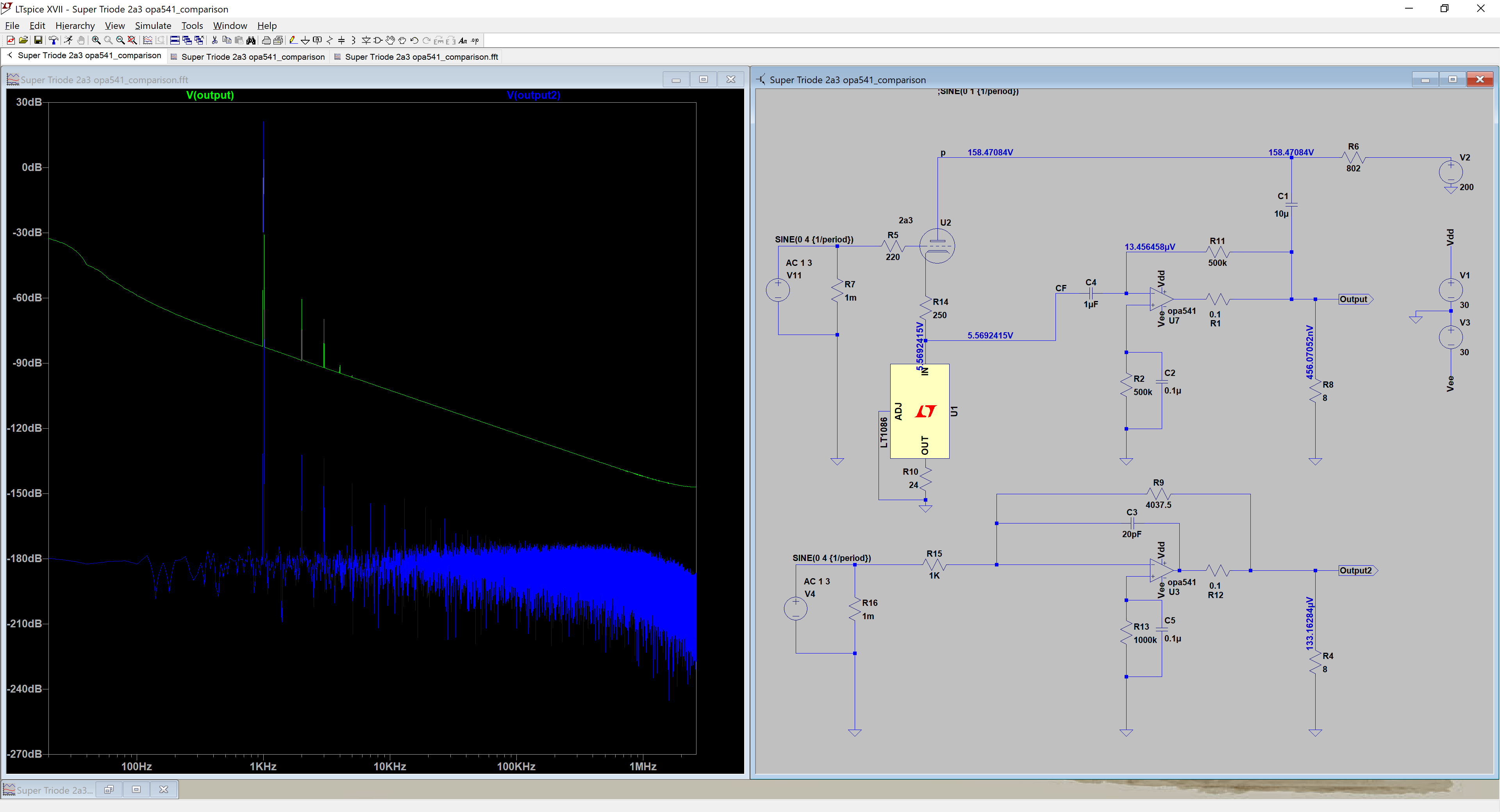

i think this schema is nonsense. if you want tube sound-then tube must be doing majority of gain... follower has gain <1 ... and GFB to anode is waste, because triode with medium or even high mu, will effectively "ignore" small signal injected to anode circuit.
so if you remove tube, and short the g-k it will sound same
That's interesting. I just simulate a comparison and here is the result.i think this schema is nonsense. if you want tube sound-then tube must be doing majority of gain... follower has gain <1 ... and GFB to anode is waste, because triode with medium or even high mu, will effectively "ignore" small signal injected to anode circuit.
