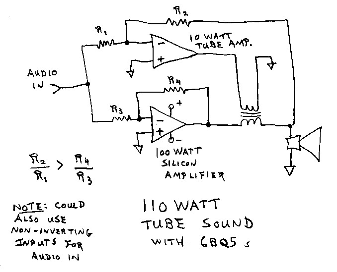

Or placing the I amplifier output after (at the secondary) of an OT for the V (tube) amplifier. Then the tube can do some heavy lifting as well.

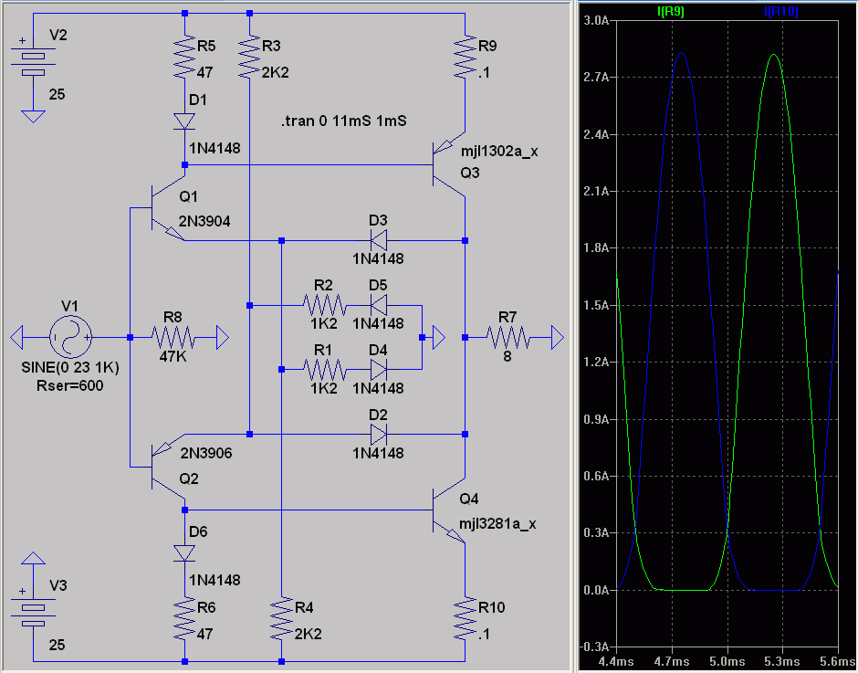

And if you use a "perfect triode" for the feedback (or V amp), no reason it has to be distorting:
and (a tube veneer amp) just puts the final finish on the sound. (requires a very low Z secondary OT if the tube amp is smaller than the SS amp; has to be able to drive the same final current level):
