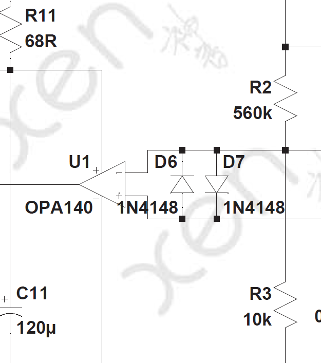

400V 50mA J-D Pos Super Reg
To take it to the extreme, and for the sake of stimulating discussions,
this is a concept (i.e. not-proven, build-at-own-risk) schematics for a 400V 50mA Jung Didden Positive Super Regulator.
At least in Spice simulations, performance is excellent.
Patrick

Nice Patrick, that should work well!
Two things to watch out for: start up may give issues with the opamp locking up at zero output, and on the other hand the supply to the opamp may have switch on transients above the save value.
These things are not always modeled well in Spice.
The lock up may be fixed with a large resistor across the pass device, while the opamp can be protected with a zener across it's supply pins.
Since the MOSFET pass device will have lower transconductance than a BJT performance may be slightly less, but will be of no consequence.
If you use depletion mode MOSFETs like the 2540, be aware that it has a peak Id limit not much higher than its avarage Id limit. That means that if you have large capacitors at the output, the switch-on (high current loading of the output cap) may destroy the pass device.
That's the reason that in my HV supply I went away from a depletion mode device; it did increase the circuit complexity somewhat but made it much more robust.

Like the TL071, the OPA140 uses JFETs on its inputs. (Pchannel for the TL071, Nchannel for the OPA140).
Like the TL071, the OPA140 can tolerate a very large delta-V across its inputs; there are no emitter-base junctions to worry about, and no VEBO breakdown voltage to fear.
This is why the TL071 is the unanimous choice for generating triangle waves in PWM switchers: the (integrator + SchmittTrigger) triangle circuit applies more than 2/3rds of the supply across the opamp's input pins. That would be disastrous for a BJT input opamp, but no problem at all for a JFET input device like the TL071. Or the OPA140.
So why include diodes D6 and D7 in the schematic of post #34? They are across the input pins of a JFET opamp.
Not wanting to talk for Patrick, but I find this good practise. It keeps the opamp from driven hard into saturation even if for protection purposes this would not be required.
Because people "roll" opamps.
For my own use, I normally use a red LED there.
BUT for the public, better be safe than to be accused of negligence.
Who dares to build ? 🙂
Patrick
