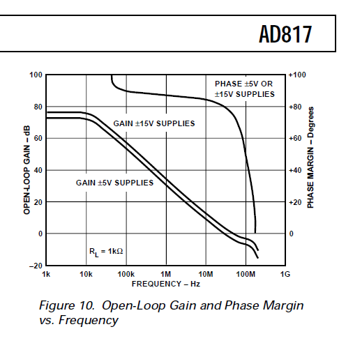

I always suspected that the main reason people love the AD817 opamp for the Jung regulator, was that you couldn't ever get it to oscillate. Bad PCB layout? no problem. Poor choice of output capacitor(s)? no problem. Slow output-drive transistor? no problem. The enormously generous phase margin (> 80 degrees!) of the AD817, covers a multitude of sins.
Its nitromethane-fuelled uncle, the AD797, was difficult to stabilize, even for Walt Jung. Reaction: replace by an opamp that's easy to stabilize. Or so I imagined.

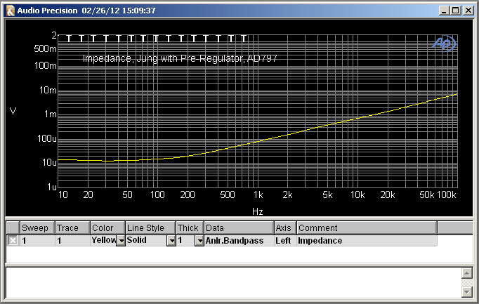

I like the idea of using a preregulator (IF you've got the voltage headroom) simply as an enhancer of "line regulation", i.e., to reduce ripple at the input of the downstream, second voltage regulator. I'm not so enthusiastic about Walt Jung's bootstrap connection, in which the reference for the preregulator is connected to the final output of the second regulator. As far as I'm concerned, "ground" is always a less noisy reference than "Vout_final".
Consider: if the preregulator does its job, its output voltage will be constant. If the downstream voltage regulator does its job, that output voltage is also constant. Voila, the input-to-output voltage of the final regulator is constant. Without any bootstrap connection.
Some people on diyAudio are enthusiastic about using a series mode preregulator followed by a shunt mode final regulator. The series regulator sees a constant current load and the shunt regulator sees a constant voltage input. Nice!
I like to place an RC stage before any regulator, to round off the sawtooth waveform and reduce upper harmonics. No use feeding any regulator all that stuff, less work for the error amp in it.
A quick question for anyone. Is it still recommended to incorporate a pre-regulator?

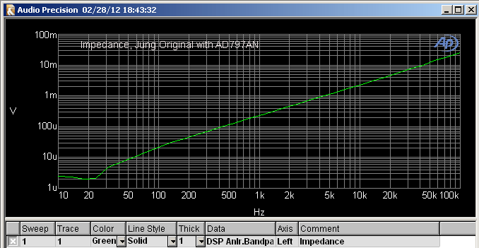

The pre-regulator increases the Zout of the circuit in the low frequency zone, but Z out is lower thereafter.
