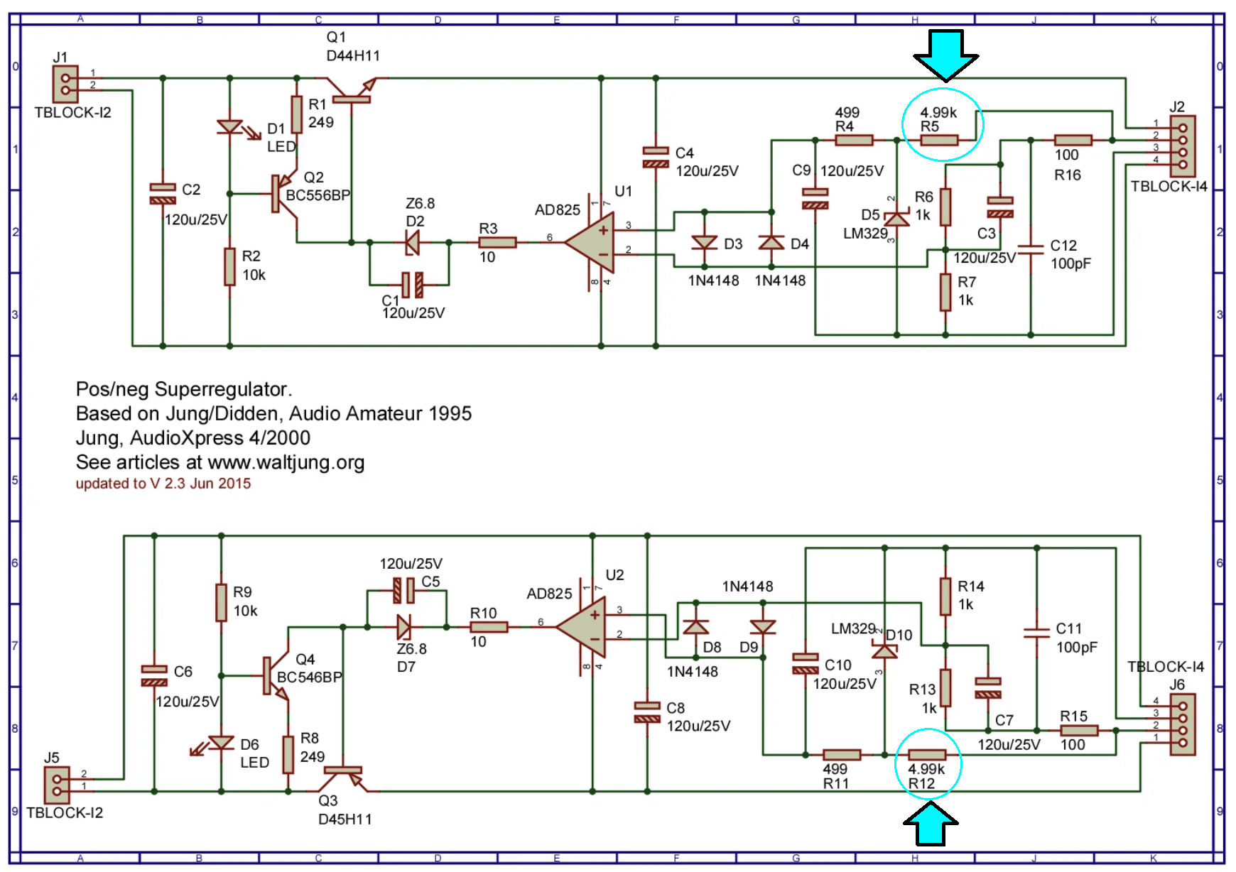

For those who are thinking about building their own customized version of a Super Regulator, which does NOT use the diyAudio Store PCB . . . . AND which happens to output a voltage Vout_reg that is at least 4.5 volts greater than Vref . . . . then my little experiment yesterday might be of interest. I'm fooling around with preliminary ideas for a Super Regulator that outputs Vout_reg = 15.0 volts and uses a Vref around 7 volts. Since (15 - 7) is comfortably greater than 4.5 volts, yesterday's experiment is applicable to my situation.
However I realize that many builders want a Super Regulator with output voltage waaaaay less than 15 volts, and therefore (Vout - Vref) is waaaay less than 4.5 volts. So the little contrivance shown here is not useful for them and I am very sorry.

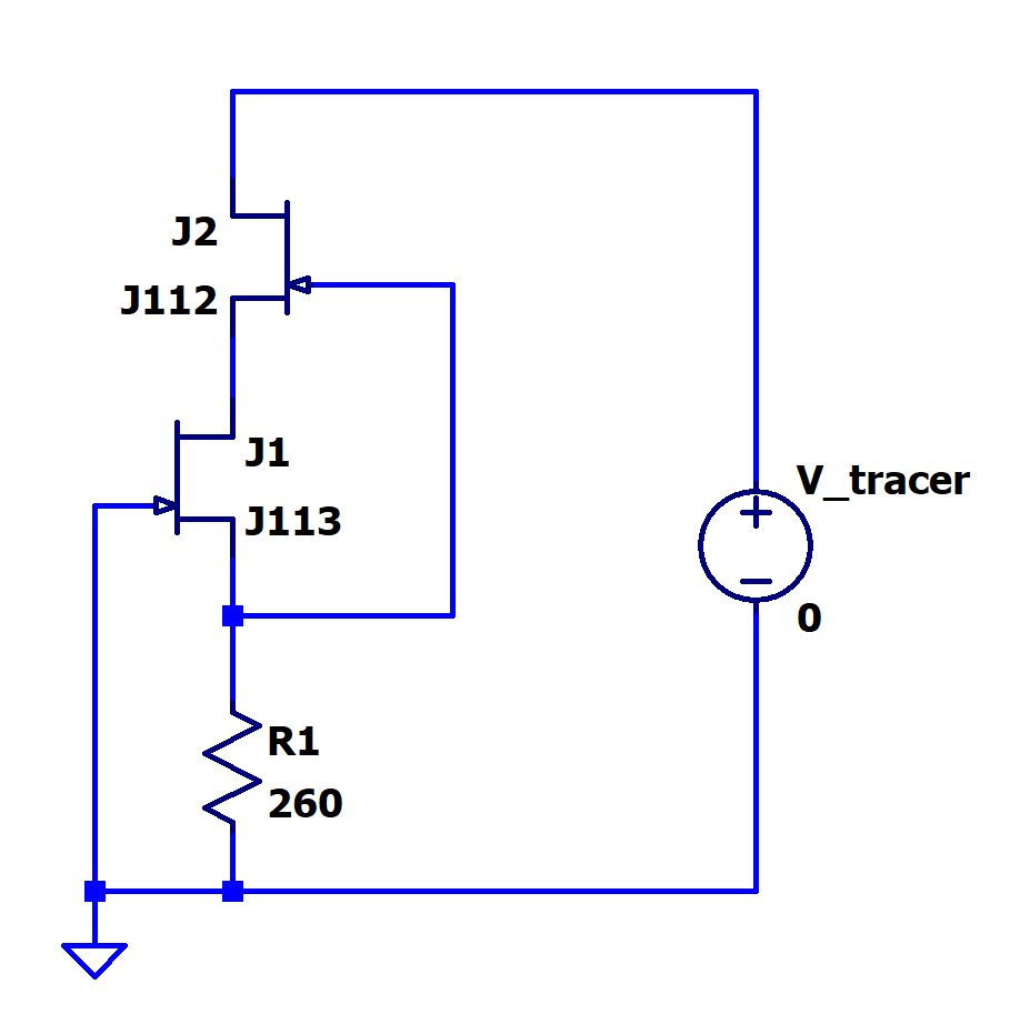

Figures 1 and 2 (attached below) show the basic idea. Resistors R5 and R12 on the official Store schematic, provide bias current to the super excellent Zeners-On-Steroids D5 and D10. I plan to replace R5 and R12 (on a custom PCB not the Store PCB) with constant current sources. Indeed, with cascoded constant current sources.
I built the Figure 1 circuit on a protoboard, and connected a potentiometer in the R1 position. Then I dialled the knob up and down until the current was 3 milliamps. It happened to require 260 ohms for this particular J113 JFET; no doubt other J113's will require different resistances than 260 ohms to give 3 mA. That's an annoying reality of cheap analog switch JFETs like the J113 -- their analog properties vary dramatically. Fortunately I had two 130 ohm resistors in my box, so with them in series I was able to achieve 260 ohms. That gave 3 mA for this particular J113.

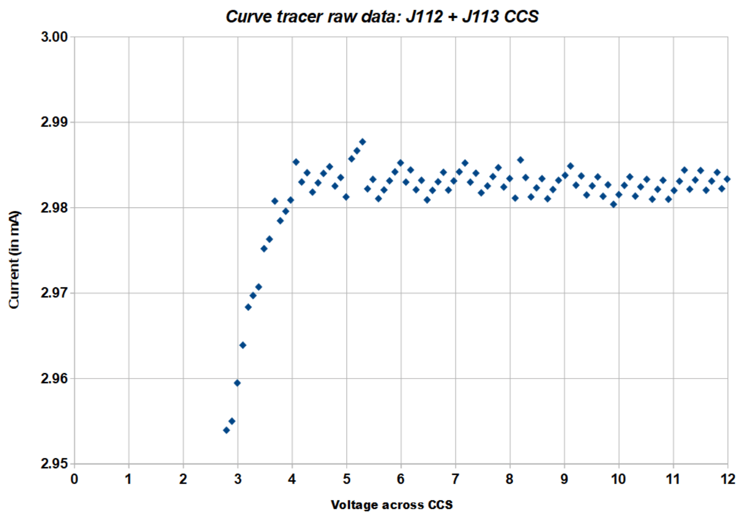

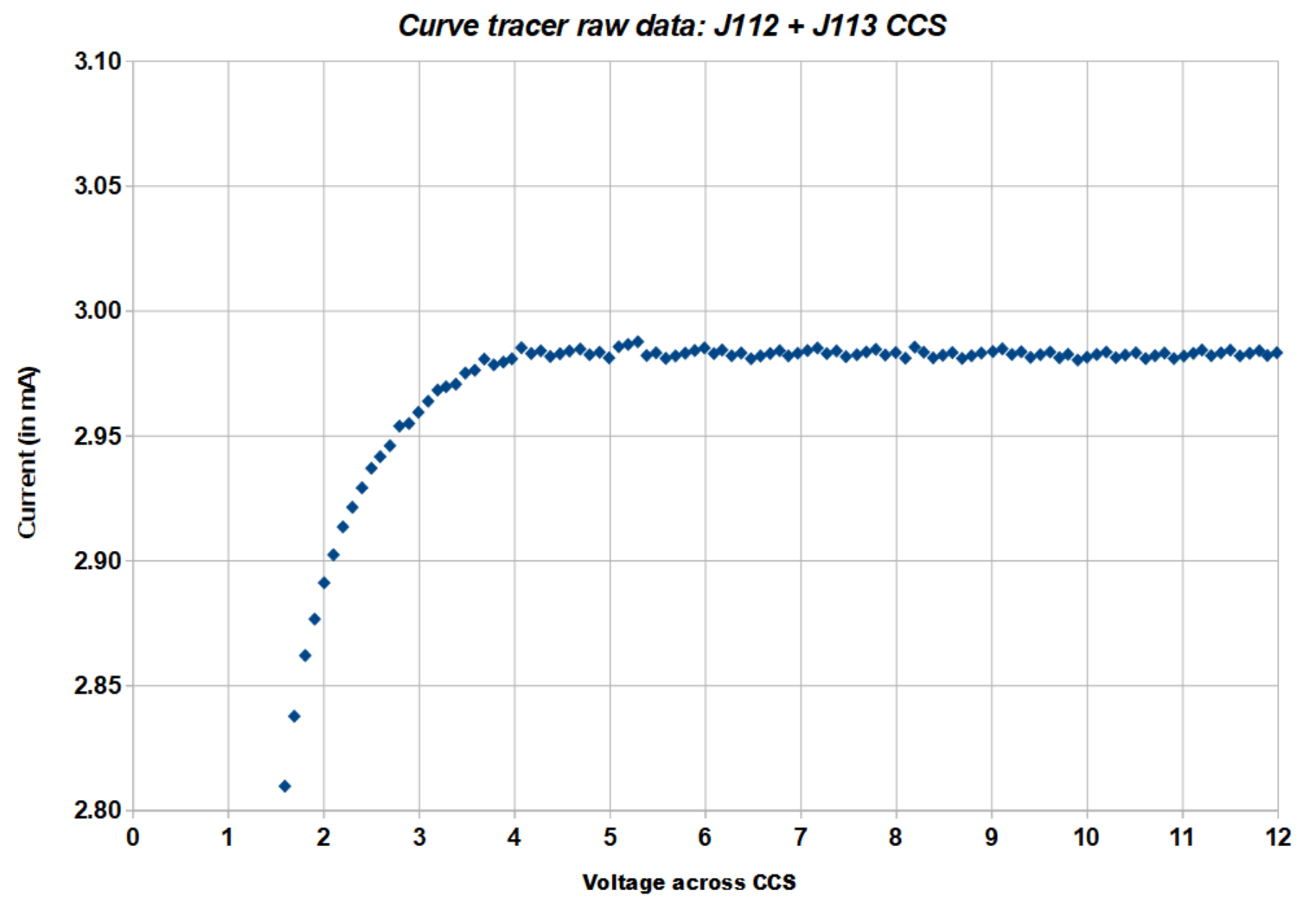

When I attached the Figure 1 circuit to the "Locky Z Curve Tracer" I got the plot in Figure 3. The trace is just a single J113 current source below ~ 4 volts on the plot. Then the magic of cascoding takes over, the J112 starts to help out, and suddenly the plot goes flatline above ~ 4 volts.

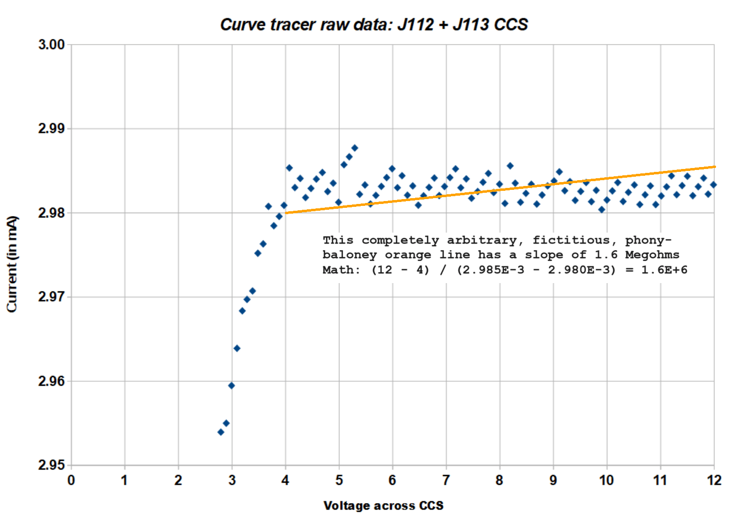

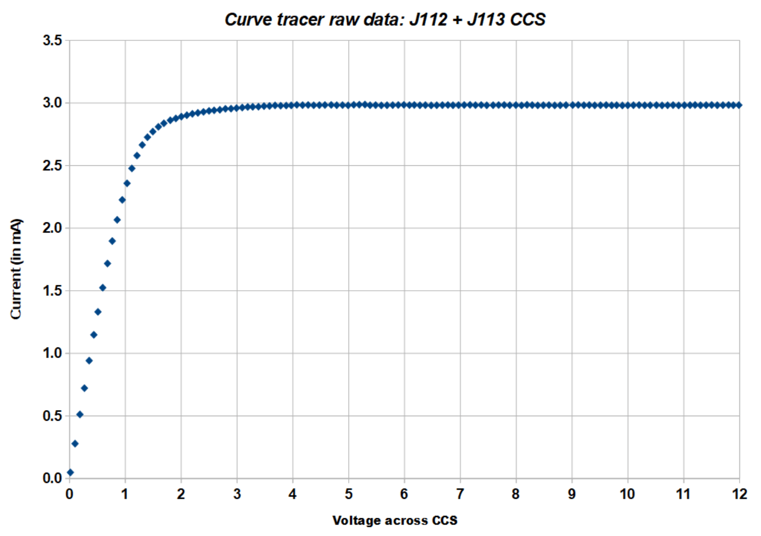

The LockyZ curve tracer can barf out its measured data as an ascii text file, so I did that and slurped the X,Y datapoints into a spreadsheet. That produced the plot in Figure 4. It's just like Figure 3 except we're not using LockyZ's hard-to-reconfigure plot software any more; now we're using a spreadsheet. Again you can see the single-JFET-only current source behavior below ~ 4 volts, transitioning to J112+J113 cascode current source above 4 volts.
Zooming in the plot view, we get Figure 5. Zooming in even more, we get Figure 6. It's plain and evident that the DACs and ADCs inside the LockyZ Curve Tracer do not have unlimited precision - - - but still, the shape of the plot tells a story. And it's a happy story.
Figure 7 is the same as Figure 6 except I have drawn a straight line among the measured data, deliberately exaggerating the slope (output impedance) of the data. It's a conservative under-estimate of the output impedance of this cascoded current source. I encourage others to draw their own straight line upon Figure 6 and calculate their own slope (output impedance). It will be fun!
Conclusion: by replacing one component (4.99K resistor R5) with a three component CCS, I was able to increase the impedance of the Vref bias network by a factor of 320. (math: 1.6E6 / 5E3 = 320). This increases isolation between the regulated output and the Vref; it also opens the door to using different Vref components which may not be as good as the venerable but expensive LM329. Ahem.

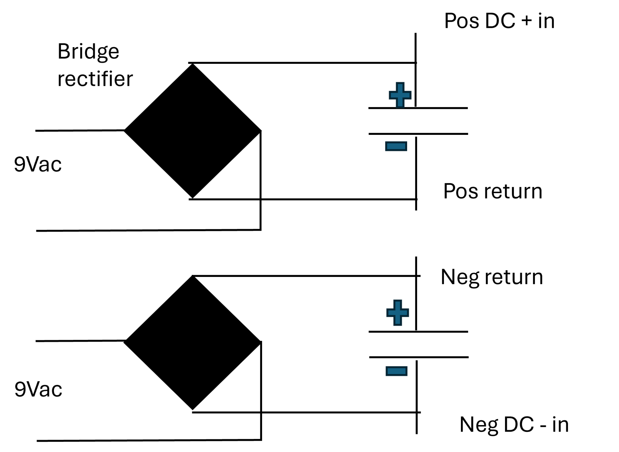

If I am targeting +9-0-9V from super regulator I plan to build and had some query on the input side. Can I short the pos return and neg return pins on the input of super regulator board? Since the final connection will have a common "zero" or ground, I think it should be ok but wanted someone to confirm the same. Please let me know.
See the attached picture for reference.

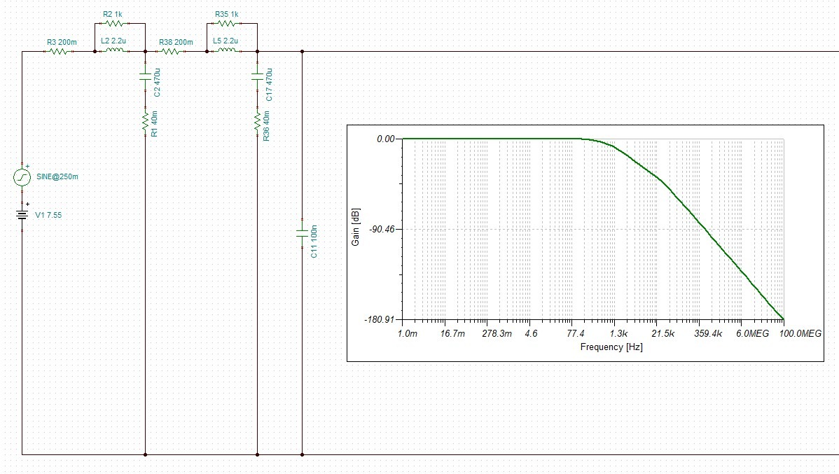

You'll get more accurate simulation results if you include the self-capacitance of the inductors and if you also include the self-inductance of the capacitors, in your simulation. It is a bit of a challenge to obtain these values but confident and self-reliant designers usually rise to the challenge.
Store filter PO89ZB: Rseries = 0.040 ohms // Lseries = 2.2 uH // Cparallel = 470uF
AmyAlice filter: Rseries = 0.100 ohms // Lseries = 10.0 uH // Cparallel = 470uF
Post #3,607 filter: Rseries = 0.200 ohms // Lseries = 2.2 uH // Cparallel = 470 uF << different from the other two >>

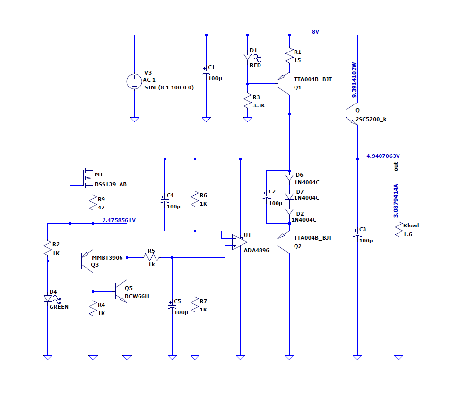

So maybe I can help. I've been using the higher current version in my amplifiers for years. The problem is not high current at all, but rather dissipation. For 5V and 3A, the dissipation on the series transistor will be almost 10W. The scheme is from LTspice and there is a possibility that it will need to be adjusted a little in practice.

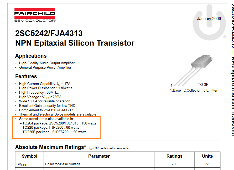

@grunf I saw that you also used this pair 2SA1962 / 2SC5242 in your regulator. What are the differences between these two 2SC5200 and 2SC5242 for you to go for 2SC2542?

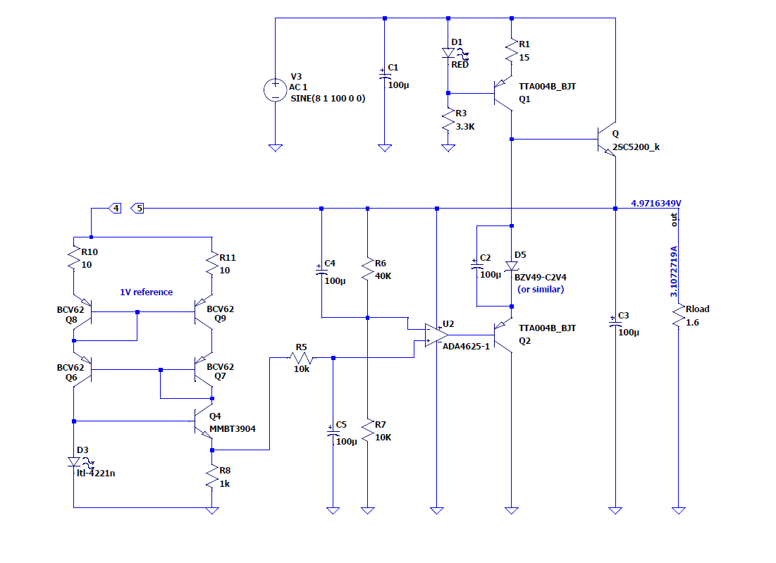

If I use this schematic with 1V ref then all the other parts could be still the same besides OP amp changed to ADA4625? For output 5V and 3A?
To use this regulator in class A amp then voltage ref changed to 6.8 or 10v and add up more diodes to D6, D7? Other changes needed do to have a 24V output?

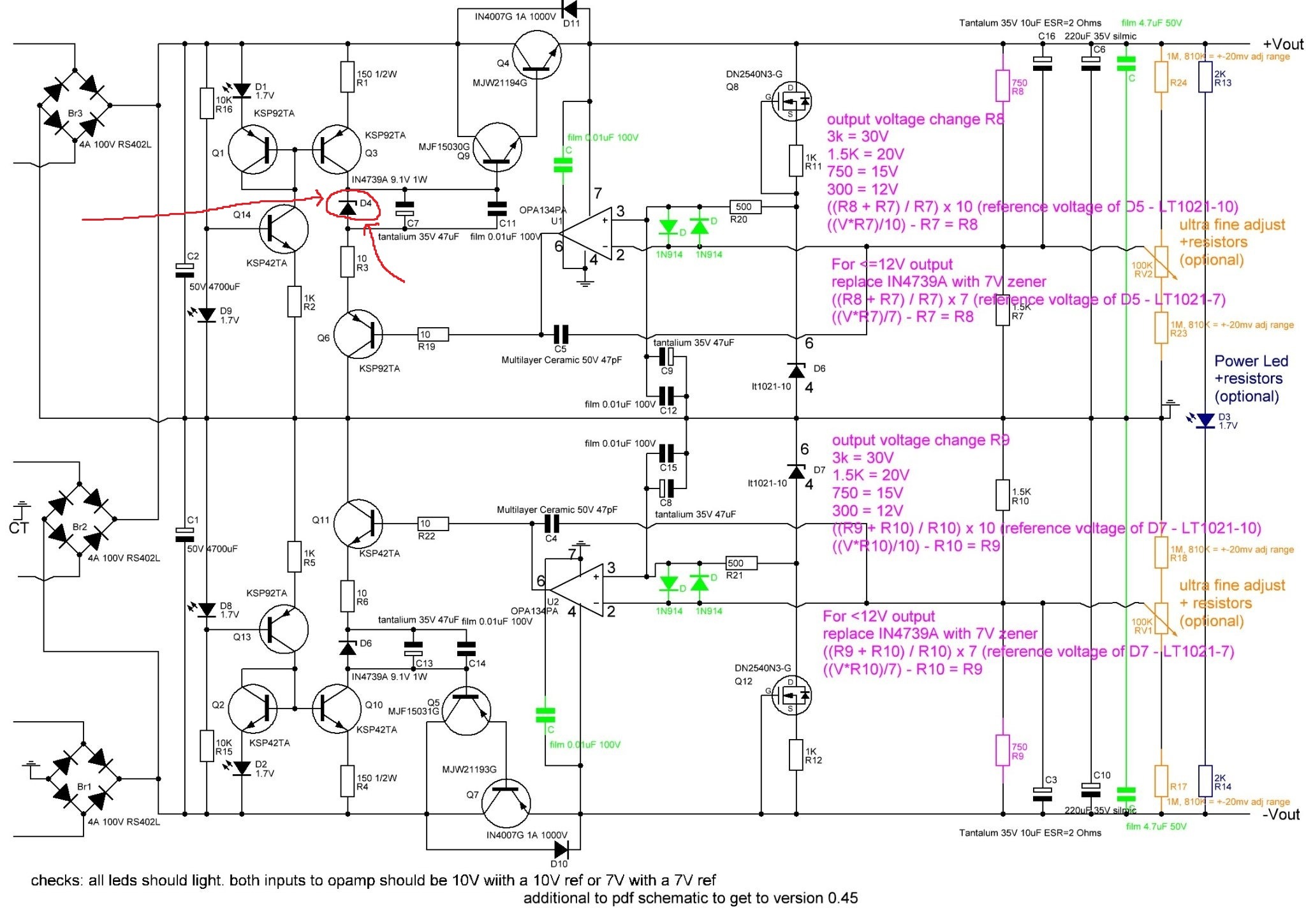

I have a question on this GRLV circuit here (positive rail only). I'm looking to use a 7v reference with a 9v Vout. Is this 7v zener diode (that i circled) a strict requirement? Would a 7.5v zener suffice?
D4 and D6 in the schematic of post #3,611 (1N4739A) are DC level-shifters. They are included because the opamp cannot swing its output pin all the way to its supply rail voltages. In that circuit with the darlington pass transistor and the PNP emitter follower:
  • You want Vzener < (RegulatedOutputVoltage - 5.0V) so the opamp's output pin is not required to swing impossibly low.
  • You want Vzener > 1.2V so the opamp's output pin is not required to swing impossibly high
In this case, using OPA134 which does NOT swing all the way to its rail voltages, and hoping for RegulatedOutputVoltage = 9.0 volts: those inequalities tell you that (Vzener < 4.0V) and also (Vzener > 1.2V). Any of (these 1 watt Zener diodes) at DigiKey, would work well.
The only difference is in the packaging.
In that case some values should be corrected, points 4 and 5 can be connected together or inserted between the LDO reg that Walt Jung described in his last article. D5 is now a zener diode from 2.2V to 2.7V 1W.
For 24V you have to add 3 more LEDs in series with D4, recalculate R6 and R7, D5 is now a zener 12V 1W, op amp is OPA1641, OPA828, ADA4625,AD825 or similar.
