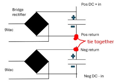

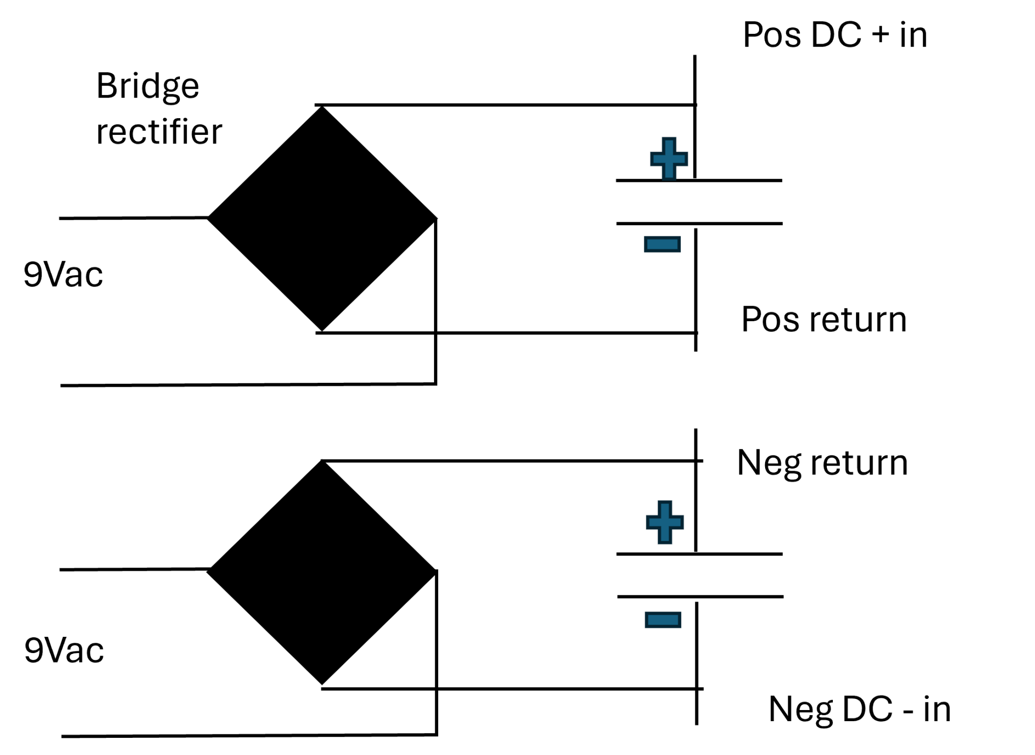

I need a little bit help to connect Super Regulator in different situations. These positive and negative returns and DC in etc are for me always confusing.
1. When I have command ground and two separate diode bridges. How I connect negative regulator in this situation?
2. If the diode bridges are not sharing common ground then can I also use two positive regulator to make bipolar power + - supply?

In order to get the two transformers in the previous post #3647: Can I use a centertap toroidal transformer, identifying the lead in the CT belonging to transformer output lead respectively? And then tie together “POS return“ and “Neg return”? Any other suggestions/recommendations??

With a CT transformer and 4 diodes (or a bridge) you can make a pos voltage, the CT and a neg voltage. You can use these as inputs to a pair of SRs as shown in # 3647. But the best performance you get with two separated secondaries. Where did you look? There must be a ton out there.
Or use two small transformers.
How much voltage/current do you need from the SRs?

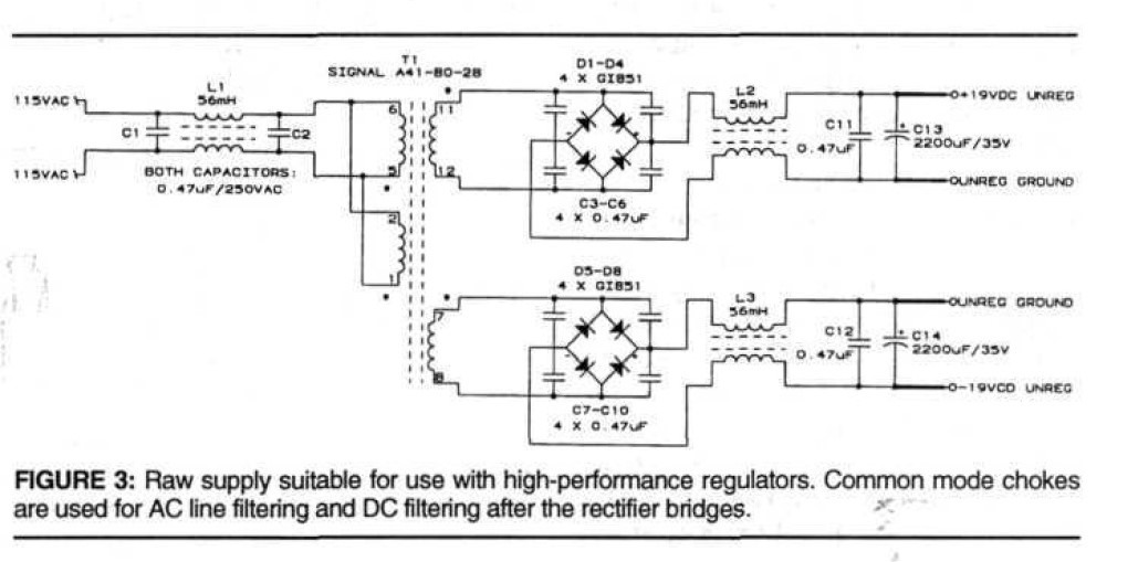

Back in 1995 Gary Galo drew up a supply with two separate secondary windings feeding the SRs.
Today we'd be using snubbers on the transformer secondaries.
Typically the "0" point would be at the circuit board in any event but it wasn't clear if Galo was relying on that to construct the +/0/- voltages. In other words would/ should the unregulated grounds of the output of this supply be tied together in this supply... and where.
As well one may be wanting a "signal ground" conductor to tie to a ground break device (bridge) as is suggested in several recent projects (Pearl phono stages for instance)

As a general rule, you would carry both the hot outputs as well as the individual grounds as far as possible to the powerd circuit, and connect the returns there.
You should avoid tying them at the rectifier/cap ground so you don't get ground loops that can cause hum and noise in the regulators. This is the basic principle, and why I put separate return grounds on the PCB so that the regulator can sense (and regulate) the voltage at the load point.
Any other method will degrade performance.
Use those ground returns on the diyaudiostore PCB!

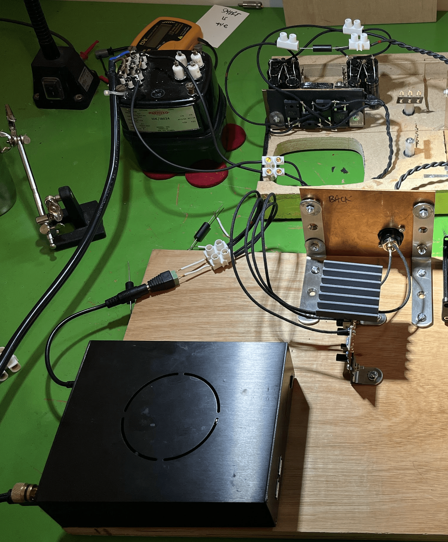

I am using a super regulator to power a 5V device that needs 500-600 mA in normal use but requires bursts of power (1.5A or more) on boot up (raspberry Pi loading software). The device is an aLLo USBridge Signature
I built a CRC power supply to feed the regulator 3000uF - 5R - 3000uF, and had to supply 13V DC to the regulator board to cope with the current demands on start up not dropping the supply voltage to the Super Regulator [SR] to allow it to boot successfully.
I purchased a Sjostrom SR01 ready built to get me going before I build a DIY module with selected components.
Now it's only 15 hrs old so not a lot of running in but I wanted to know if anyone has experience comparing this to retail options?
The reason I ask is that I had high hopes for the Sound quality improvements over my cheap iFi wall wart SMPS but I prefer this to my new super regulator by a sensible margin. If the margin was reversed I would be very happy with the project?

So I though great let's make this work with a ready assembled board at 5V and find out if it's worth the effort of building one myself to put in the place of the SR01.
I used a nice transformer, my preference for diodes and a series resistor I also like and made the prototype, however to my surprise at the moment I prefer an old wall-wart, which was not what I anticipated - hence the question to see if by some strange set of circumstances I am missing something.
