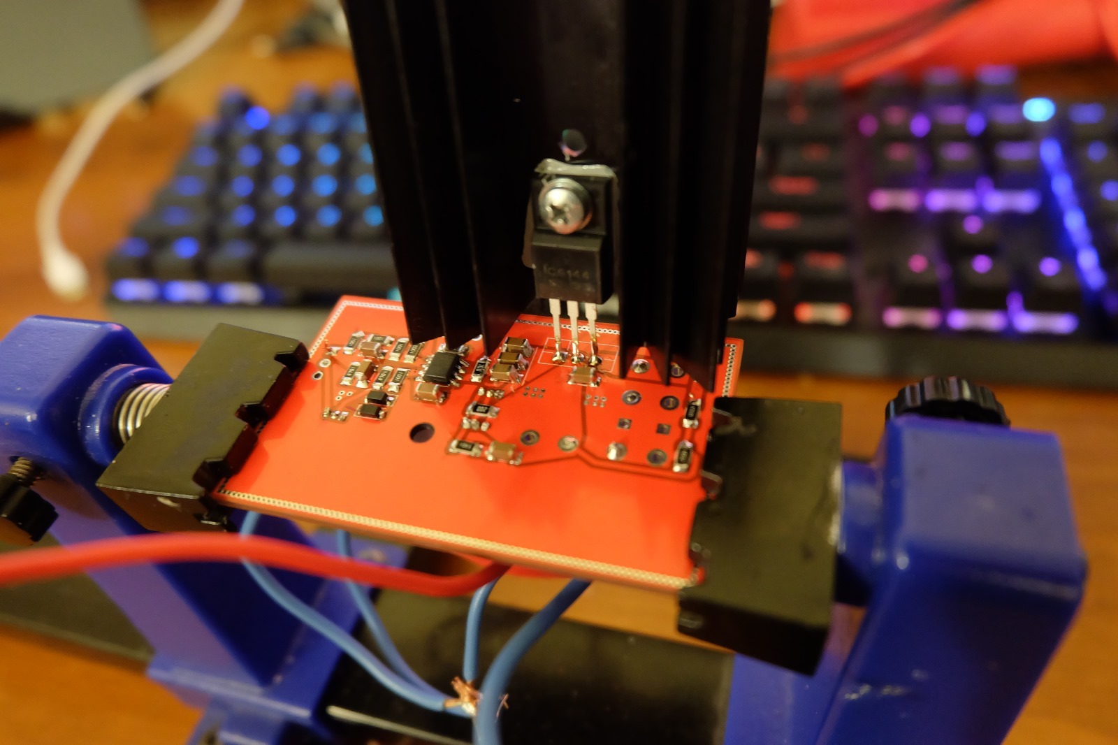

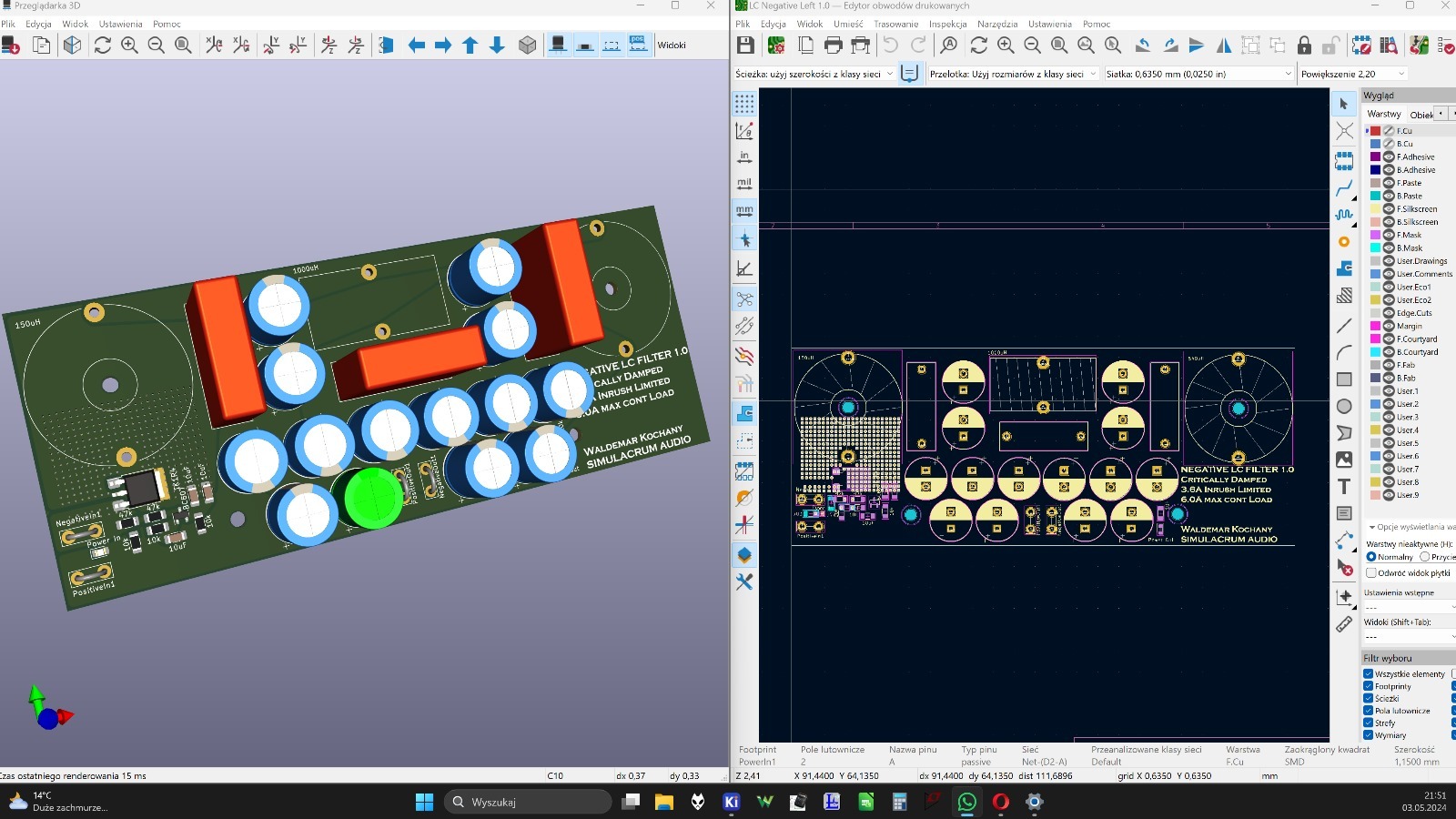

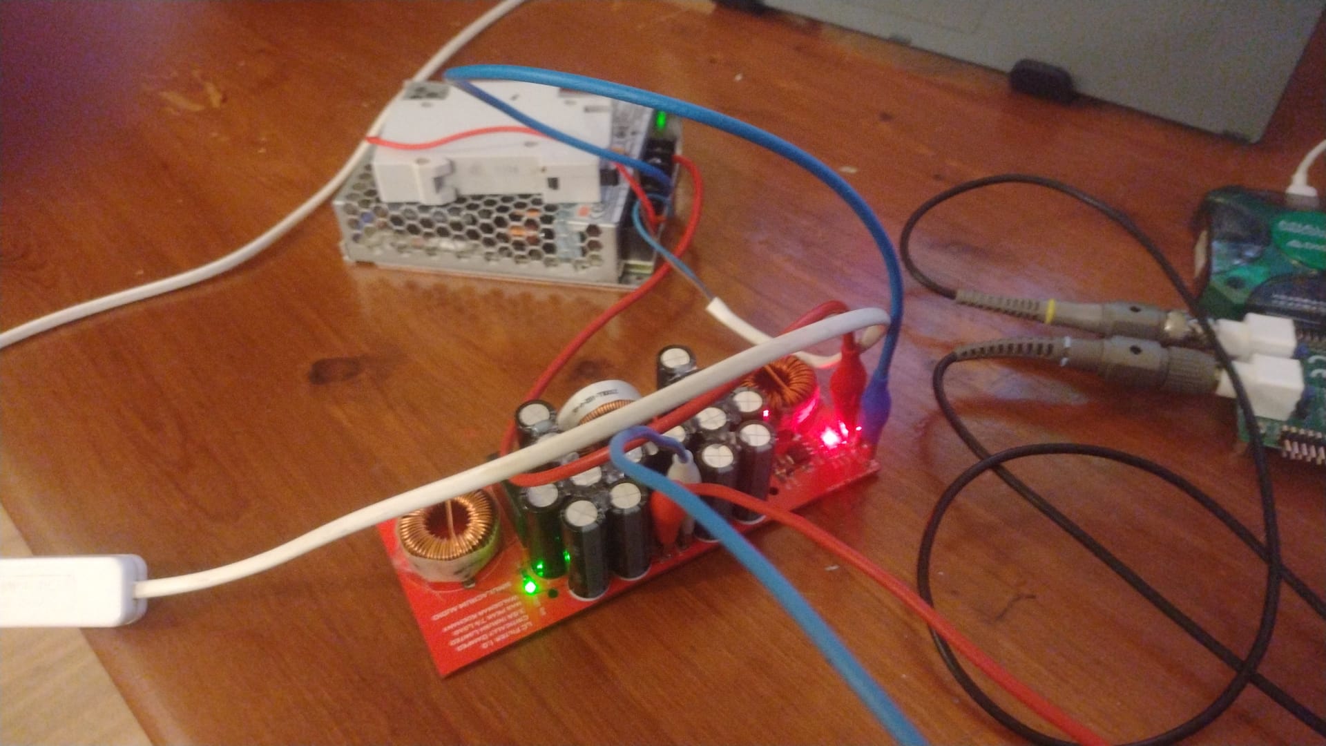

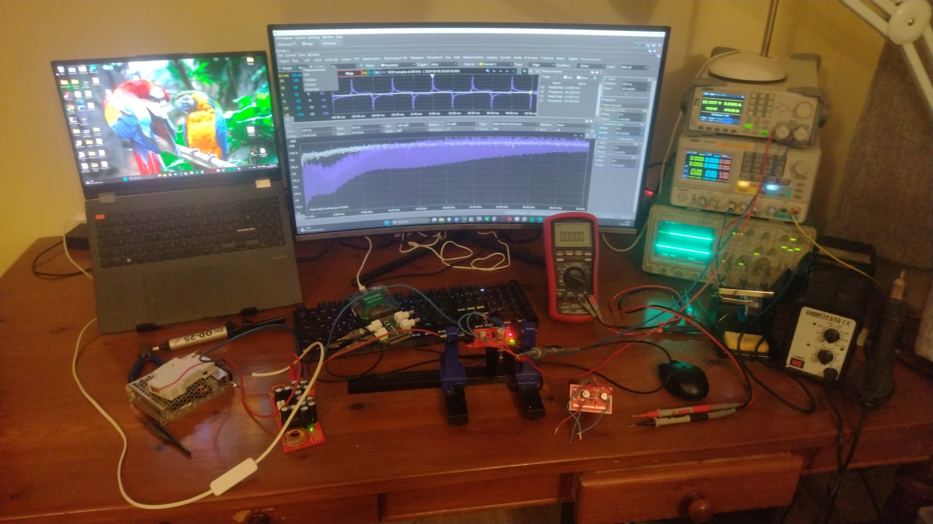

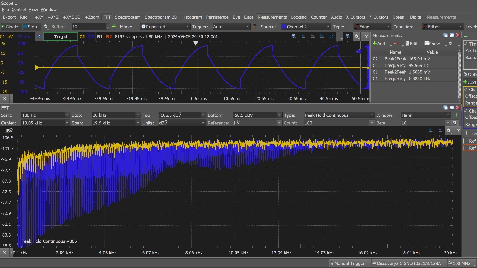

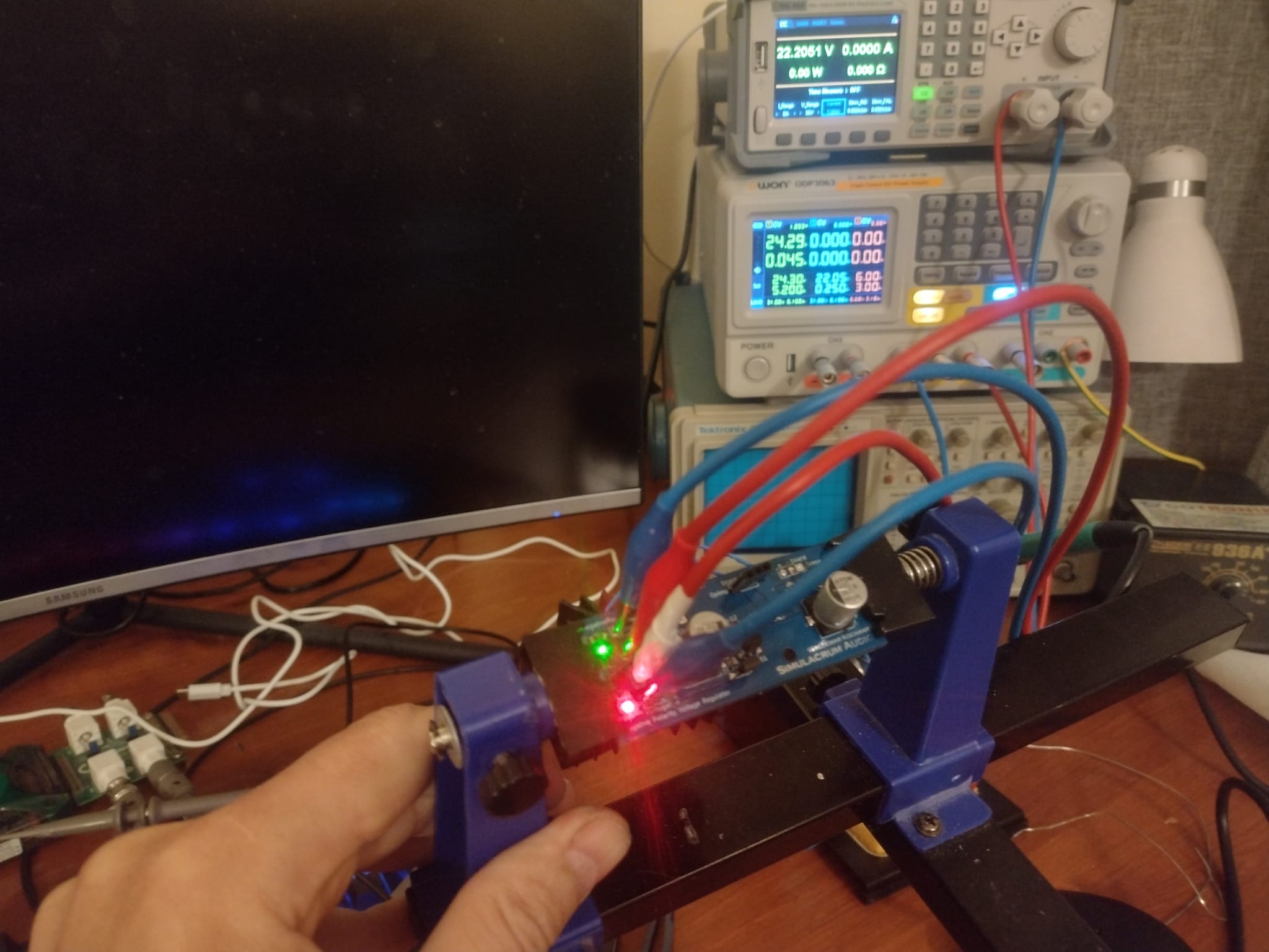

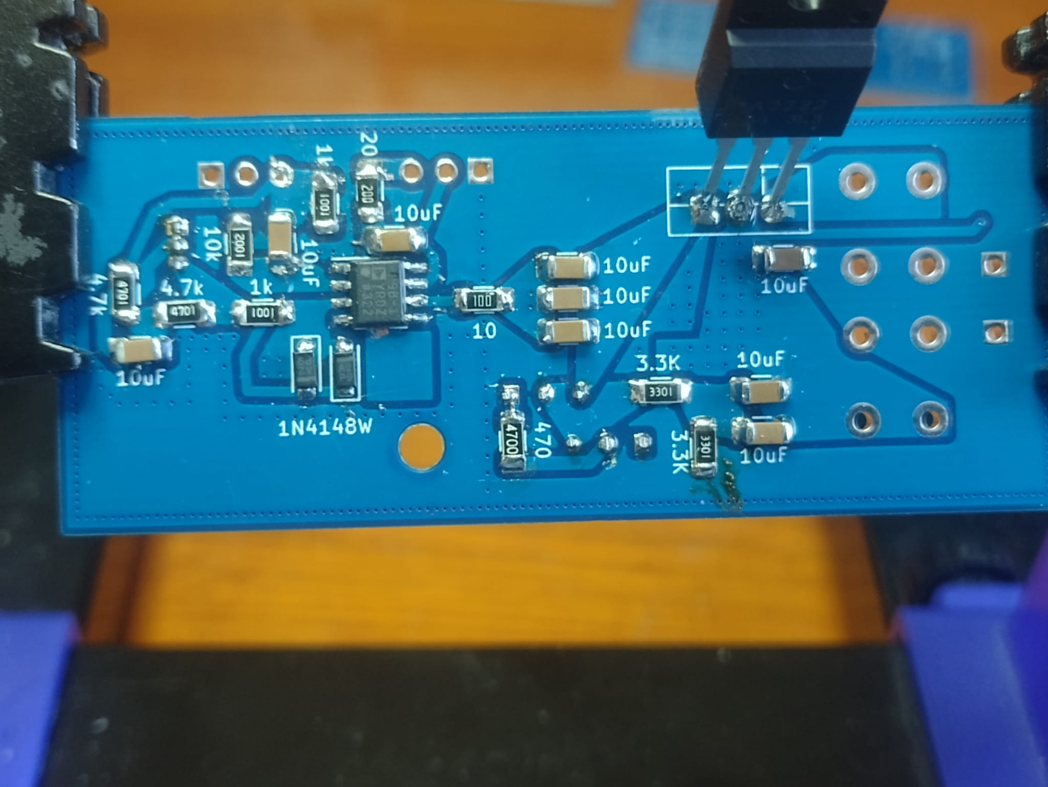

is there any advantage of using a Current Feedback type of opamp in this project ? I already have a nicely working >5A version with ADA4898-1, but think about pushing it to the absolute limit, i.e. GLED431 , string of LEDs instead of zener, bulk foil resistor on feedback. Some photos for eye joy. last picture is FFT from my LCLC filter (14x3300uF Nichicon UKW 11mR ESR) under 5A step with 0.5A/us, and what Superreg output.

also, due to the unpredictable current demand of power amplifier output and beta droop of pass transistor, and current limitations of the op amp, i find it hard to properly program input ccs. Darlington seems to solve many problems at once, keeps op amp cool, renders slew rate irrelevant, keeps current load on level shifting diode(s) zener/led string almost constant, so their dynamic impedance characteristics becomes irrelevant, and most of all, keep everything nicely in class A operation even at 12+ Ampere spikes. Only Spice simulation suggests that regulator will be much slower, although i keep both Darlington transistors in high current state, close to their max ft, with base discharge resistor in place. Despite my best efforts, smd resistors, tight layout, hybrid polymer caps, i still see see things on ouput with square 5A load, and not much better than cable salad of prototype breadboard. Since both input CCS and pass transistor need some dropout for proper function, and I found 2.2 Volts adequate for sudden voltage drops at the input under heavy load, i use this dropout for another 100R to green LED between input and output to check for proper function. I shorted already a few transistors, and not noticed immediately when it started giving non regulated output.
Several major disadvantages to CFA as error amp, high and dissimilar Ib, need for fixed Rf to keep stable, just not a good match for this application at all. Stay with low noise jfets.
pm329 with 3 gleds is best around 7v for vref, low noise and high gain for low Zo. Be sure to use low noise pnps for best performance.
Vishay S102cs great for sense Rs, but keep net z balanced. Texas Components are a great source.
darlington for pass device is good, a real necessity for 5a.
Walt Jung
Ps: see p2 of the 1Vref with rleds, and ancillary stuff. Grunf’s favorite mosfet, bss139i, works wonders as Isource for 10ma or so. Two parts!

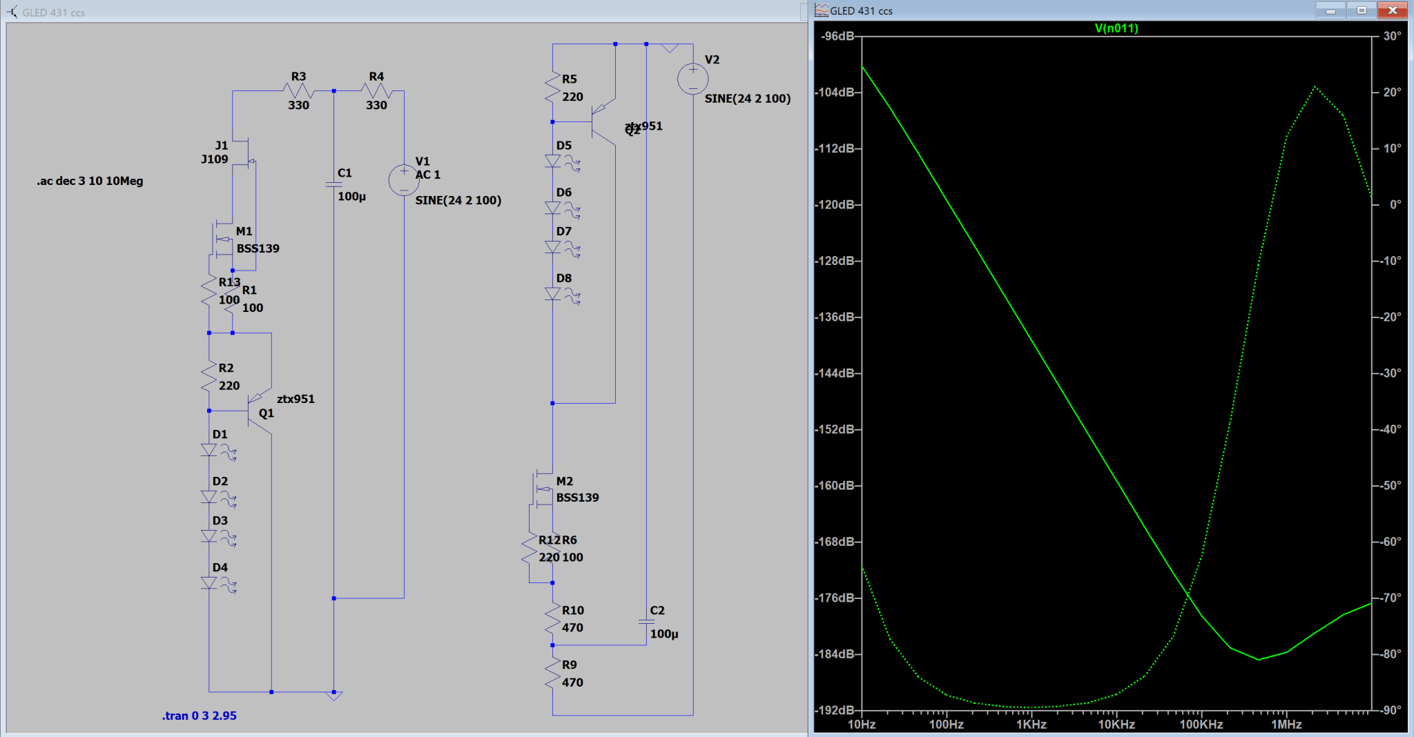

for 22V output, this arrangement has enough voltage headroom for everybody>, AC analysis of Vref vs Vin
CCS output current simulated - 11mA, real measured 7,5 mA, 220R resistor over led string sends 5mA to ztx951, 2,5mA stays for LEDs. I feel i need to push the leds a bit harder, min 5mA, maybe even >10mA both branches. For leds I bought HLAMP 6000. Don`t know what can i do better.

“Don`t know what can i do better” you said. I think you flat out missed my point about the pm329, Simulacrum. Look at https://refsnregs.waltjung.org/2New_Vrefs_082715_Draft.pdf in particular fig 3 where the topology is two_stage, not one. Allows for much lower z, and is more effective.

lower z on voltage reference is nice in an universal voltage reference, i.e. with sparse input filtering and dynamic load. One more jelly bean npn bjt will not bankrupt anybody, but I just thought, that when supplied with a a super duper high output impedance ccs, and used specifically in super regulator circuit, i.e. loaded with another constant high z node of op-amp input, further lowering in dynamic impedance shouldn`t do any appreciable difference. If you insist that this is an upgrade even in Super Regulator schematic, i will add BC550C and resistor.

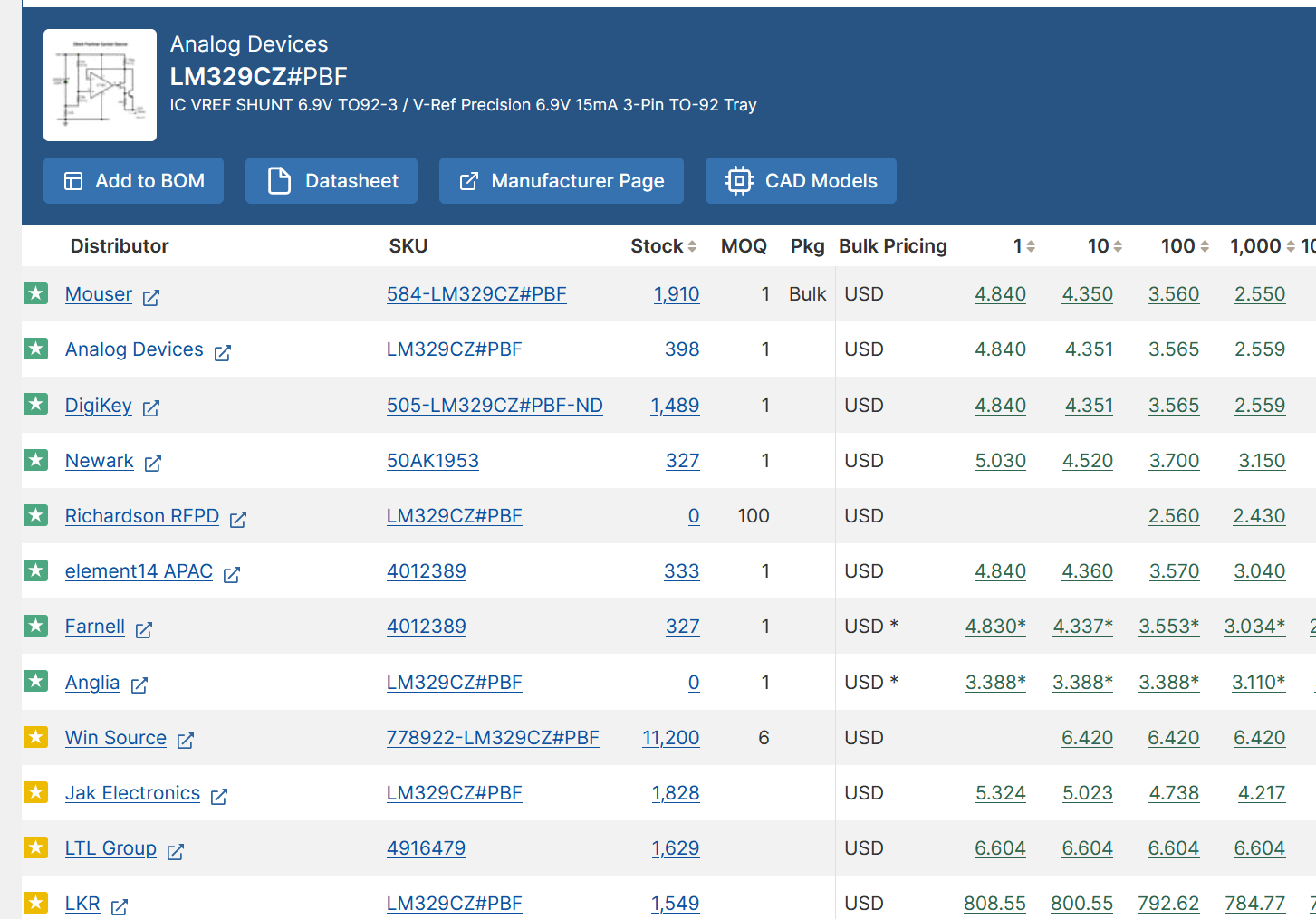

Good news: Linear Technology's implementation of the LM329 voltage reference IC, is in stock at Mouser and DigiKey and Farnell and Newark. Walt Jung's original design for the Super Regulator uses two LM329s; one for the positive regulated output and one for the negative regulated output.
Not such great news: they're expensive! Octopart chart attached below.
