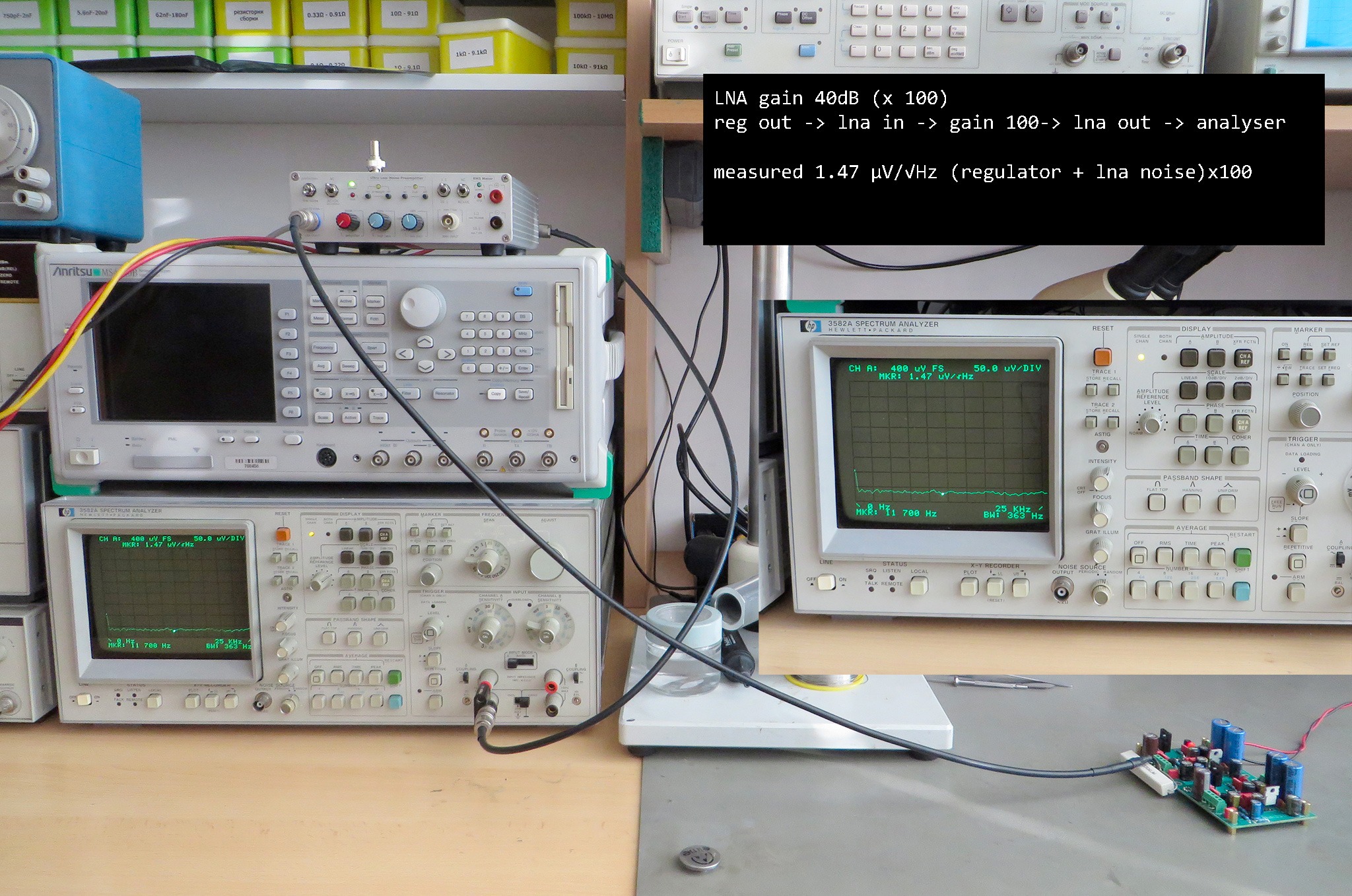

And so. About the noise of this regulator.
New measurement. Regulator supply from unregulated psu. Opamp supply also from unregulared input as a schematic.
For easier understanding, the readings of the analyzer are in µV/√Hz.
Tombo, really the analyzer is wrong at levels below -120 db or I have calibration problems at these levels.
When I have time, I will give it a fresh calibration.
At high levels not problems. Furthermore its specifications are down to 1 microvolt (-120dB)
So at such low levels it is good to have LNA before it.

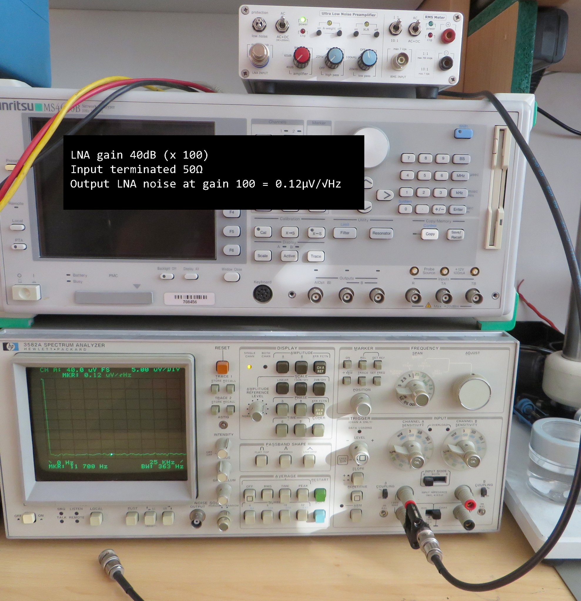

I did measurements. All measurements are at gain 100 (40dB).
I did the calculations. I don't know if I'm wrong somewhere. I don't have a deep knowledge of analog circuitry and especially noise.
You have a lot of experience and knowledge and I hope you can tell me now if everything is correct.
LNA noise at gain 100 (50R terminated) = 0.12µV/√Hz
at gain 1 = 0.12/100 = 0.0012 = 1.2nV/√Hz = 1.2*√25000 = 1.2*158.11 = ~190nV
measured noise (1K5 resistor + LNA) at gain 100 = 0.49µV/√Hz
at gain 1 = 0.49/100 = 0.0049 = 4.9nV/√Hz = 4.9*√25000 = 4.9*158.11= ~775nV
measured 1K5 resistor noise = √(775^2-190^2) = ~751nV
(theoretical thermal noise = 789nV)
measured noise (regulator + LNA) at gain 100 = 1.47µV/√Hz
at gain 1 = 1.47/100 = 0.0147 = 14.7nV/√Hz = 14.7*√25000 = 14.7*158.11= ~2324nV = ~ 2.32µV
LNA noise = 190nV = 0.19µV
measured regulator noise = √(2.32^2-0.19^2) = ~ 2.31µV
regulator noise (video)
1K5 resistor noise (video)
LNA noise (video)

I thought that LNA was used for first measurement as well, because of HP3582A 1 uV noise floor.
Measurements and calculations are OK now. I don’t see any error. Measured regulator noise is realistic value, close to best possible with used opamp. 🙂

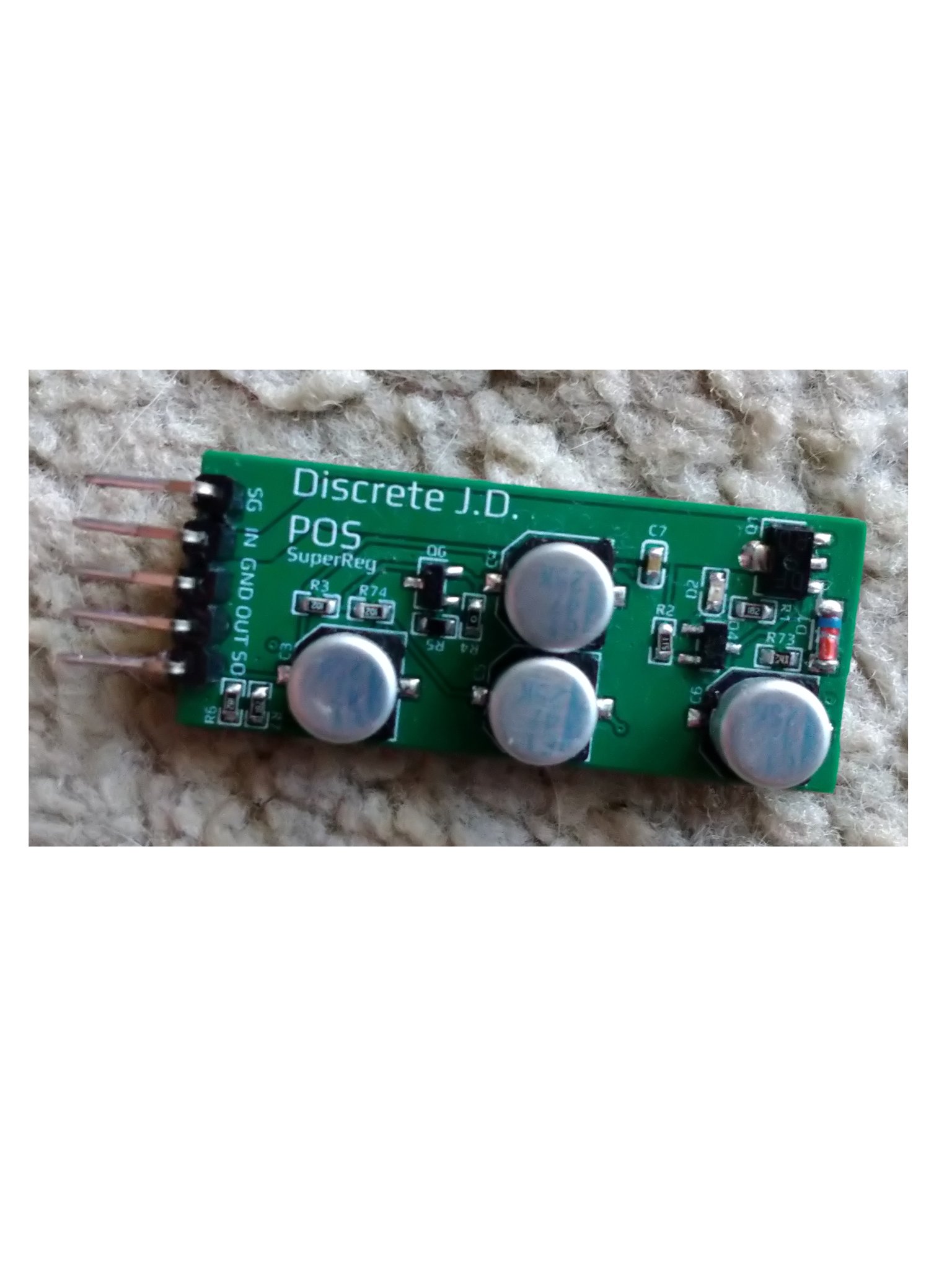

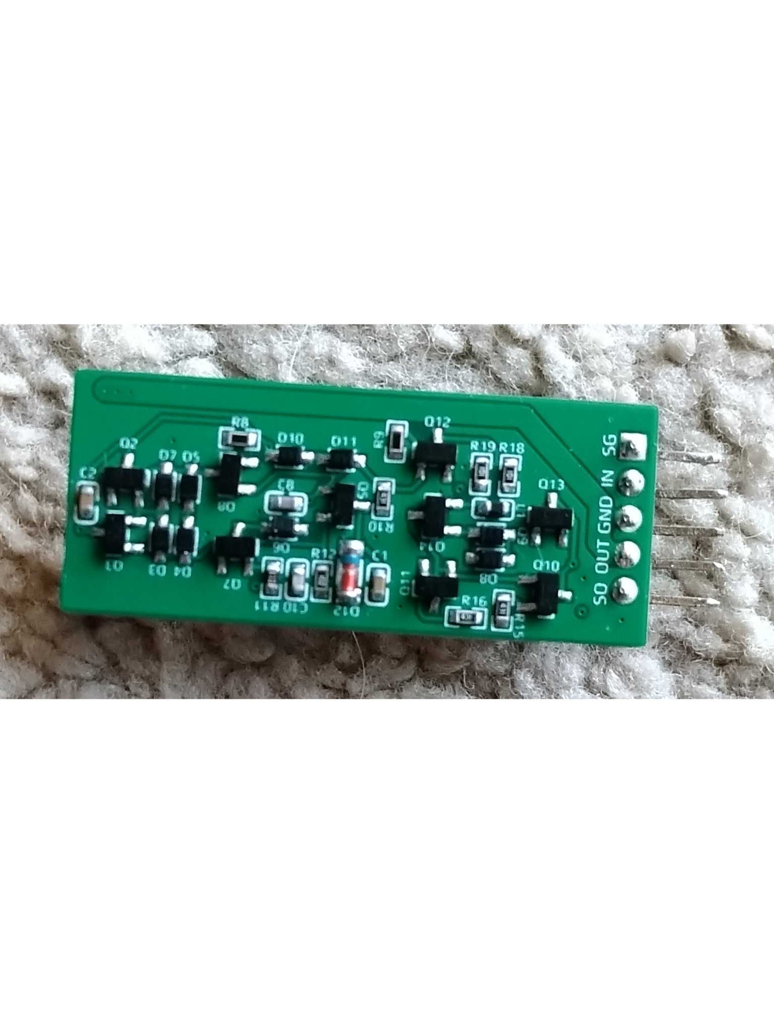

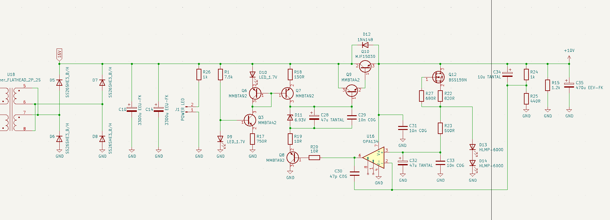

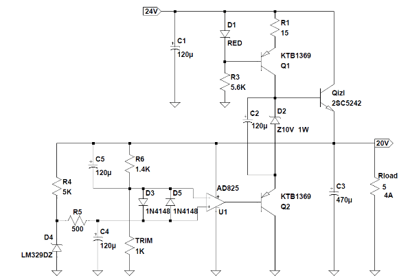

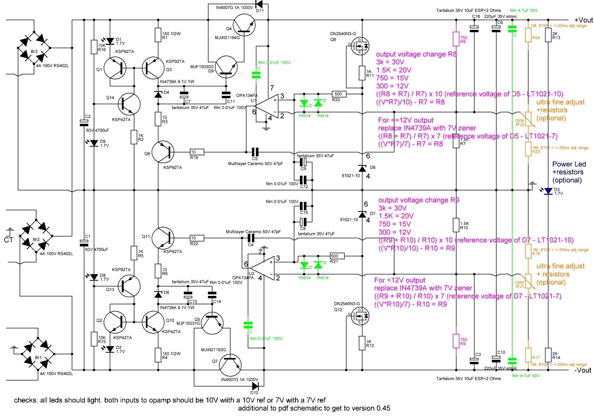

Hi everyone!
I read the whole thread but haven't found anything about Kevin Gilmore golden reference low voltage power supply (GRLV for short).
It is interesting because it inverts diode switching noise (transistor circuit on the input of the regulator).
Original power supply measures bellow 1uV of noise.
I am using the positive half for my DAC and as always I am looking for a way to improve it.
I attached the original bipolar supply and my modded positive supply schemes.
-I changed the voltage reference for two diodes. Because of low regulator output the voltage reference ccs wasn't getting enough voltage to work with. Leds improved the regulation and sound drastically. Diodes are low noise HLMP-6000.
All of these changes made very big difference.
Btw I am using custom made smd DDDAC1794A by Doede Douma.
Are leds quiet enough to replace voltage reference in my case?
Is there a need for darlington pass transistor? I read that because of it regulator has higher input and lower output impedance, but it is slower.
I would very much appreciate your advices and critics.

LEDs (except blue and white) are the most quiet reference you can get with no additional effort.
What I see in your schematics is not the "Super Regulator" discussed here ?
Thank you for your answer!
This should be an improved super regulator. The topology is the same. Correct me if I am wrong.
I posted here because i wanted to know if this "improvements" are worthwile and maybe some parts of original super regulator are better than those in my diy super regulator.
All in all I would like to change parts of this regulator and listen for a differences

I wouldn't really say that it is an improved super regulator, it can still be improved a lot and some shortcomings of that design need to be corrected.Thank you for your answer!

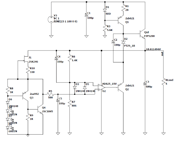

https://www.diyaudio.com/community/threads/walt-jung-shunt-design.383690/post-7016961
grunf another version of JLH69 regulator
I have built this following grunf JLH69 version ( on the 3rd picture) using Q1,2 - DB140 and 2SC2500. 5V out and using it to power soundcard consumption with 1.5 amps. Can I just add J1 and Q3, Q4 from upper schematic to this my built one to improve this regulator further more? I also like to add this CCS that was used in the first picture using right parts to this schematic what I have built. I really need help and guidance for that.

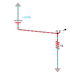

I'm referring to something like the attached image. The positive output of the supply is at common potential so it's own return becomes a negative voltage source.
Conversely, If the negative output of a negative supply is set at circuit common, its return becomes a + voltage for the circuit it's connected to.
Bias supplies for tube circuits have been built either way. In the case of the Super-Reg , where its designer has supported use (in a pinch?) in this way, I'm wondering what differences (or drawbacks) there may be between each in the same application. That's all.
Edit: The context for the above question is that I have a positive Super Reg biasing a breadboarded transmitting triode grid positive for A2. So far, successfully.
If the circuit turns out to be worth building a second channel for stereo, rather than use another positive board (resulting in two unused -V supply pcbs) I wonder what potential trouble might be there if the -V board is used for +V grid bias.
Thinking about this, then if in use there is no practical difference. why bother having two designs?
Or, if there is a situation where the alternative hookup is not optimal, then what are the limiting conditions?

HI and thanks . Yes, I understand all this. I guess the question is more about the electrons than the nominal use in this or that application.
Its why I worded the question the way I did. If either board can be used "as a battery" in the same application, there must be at least some difference there somewhere, though you might have to be an electron to see it. The two "batteries" are different after all, and might not necessarily behave equally under every conceivable condition. The differences may have absolutely no bearing on concerns for the practical application, though might be a topic for a physics thesis. While I think it's natural to wonder how much it will like clamping a transmitter grid being swung by a very dynamic driver my question here is more out of pure interest. Thanks.
