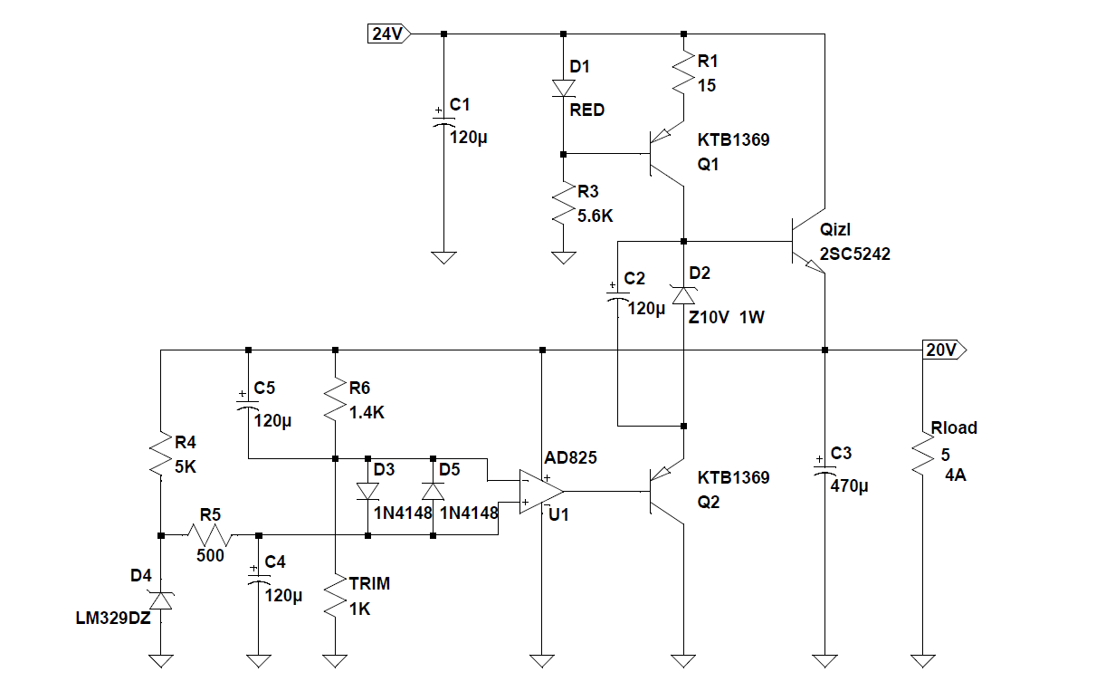

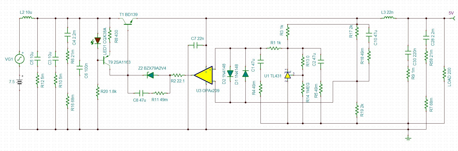

@grunf Could you please guide me what changes I have to make to use your schematic in 5V out version? I like to get out 1,5-2 A.The new version is no longer so simple, now it has 13 transistors (10 SMD) and does not use any zener diodes or references. All parts of the schematic are not mine, so the publication will have to wait.
To begin with, I am attaching the first test version that I used in JLH69, instead of KTD2061/KTB1369, TTC004/TTA004 or the popular BD139/140 can be used.

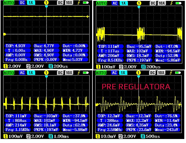

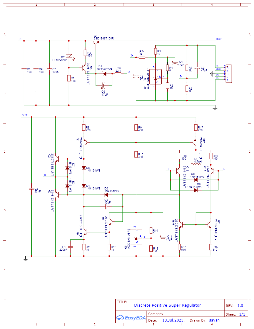

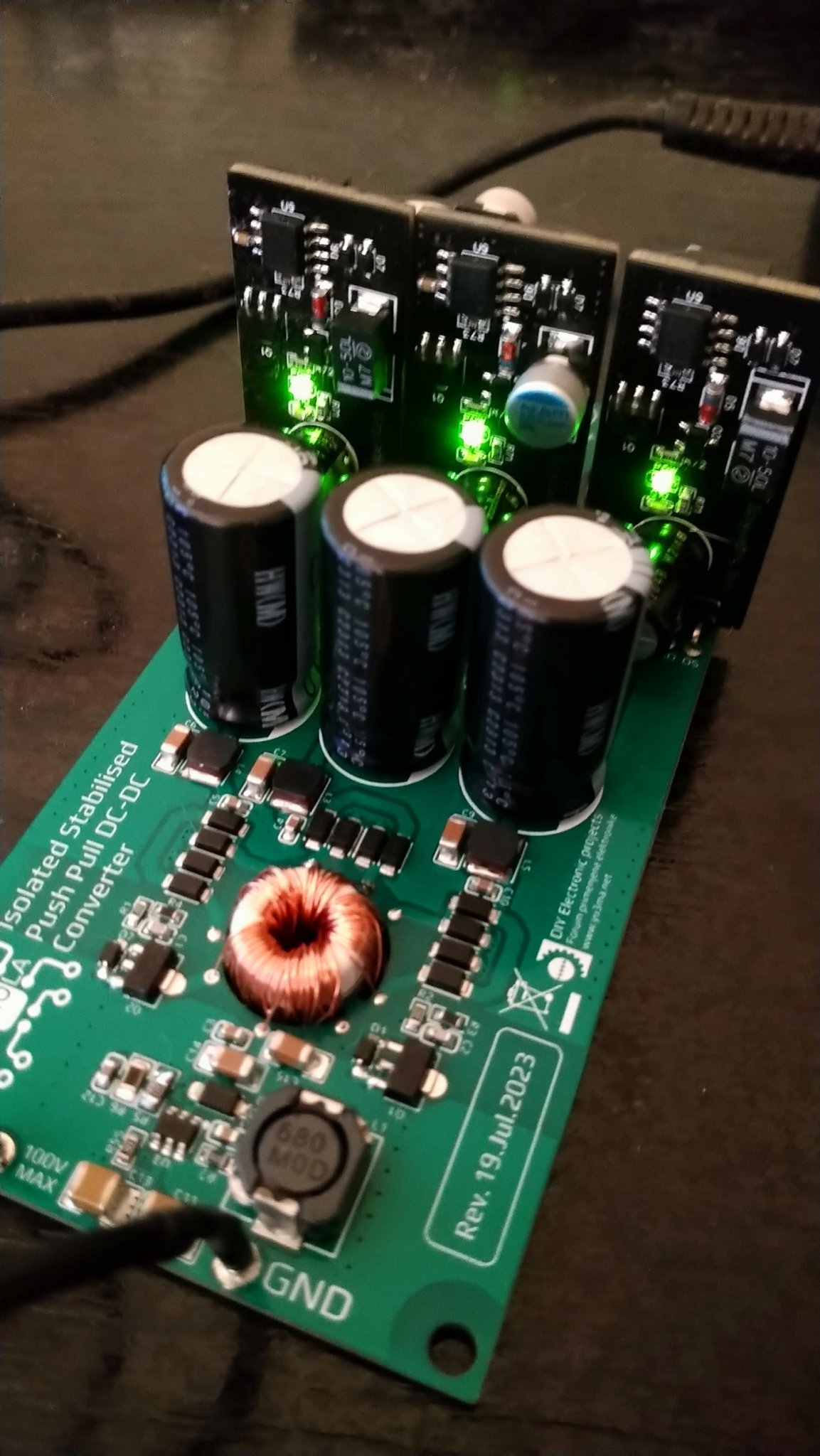

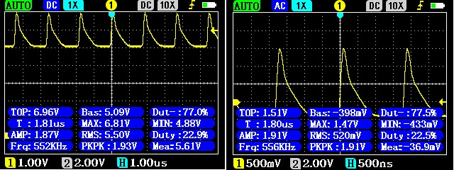

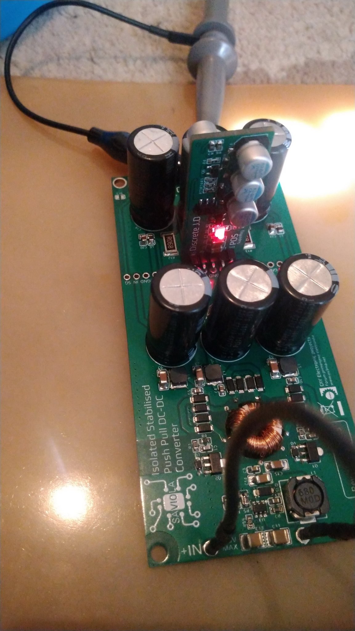

To bad news for my iso push pull super reg version, push pull iso pre regualtor work very well, but J.D. discrete supereg seems have problem with layout? If I put an linear fixed 5V regulator in place of J.D. there is no isue so problem come definitely from discrete J.D . Pre regulator deliver 7.5V but I have put it on 12V with no diference. Previous implementation was almost promissing but something is happened with this smaler version, can you please tell me do you see something which I don't, it have some strange oscilations and I am unable to figure them out, looks like a layout isue? Isue is reflected even to pre regulator, which can be seen in the lower right window in the first picture, what might be isue here? I thought I'd share this with you after full testing it as it works very well on the previous biger non-isolated implementation, too bad : (

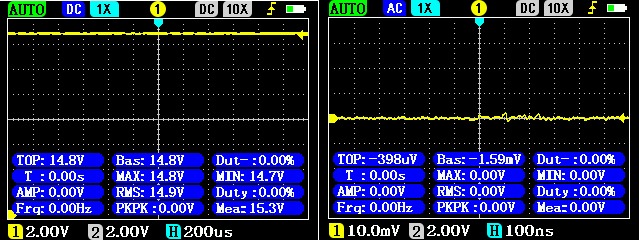

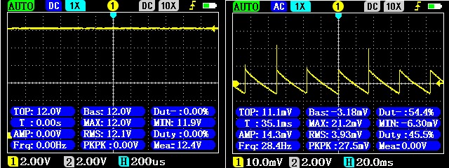

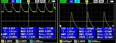

I discovered something interesting about this regulator. When I connect it to an external 12V voltage that has a sawtooth signal, it seems to me that this j.d. the mini regulator amplifies that signal instead of correcting it, why? What might be wrong, do you have any idea?
Picture 1 is j.d. regulator characteristic and picture 2 is external 12V pre regulator

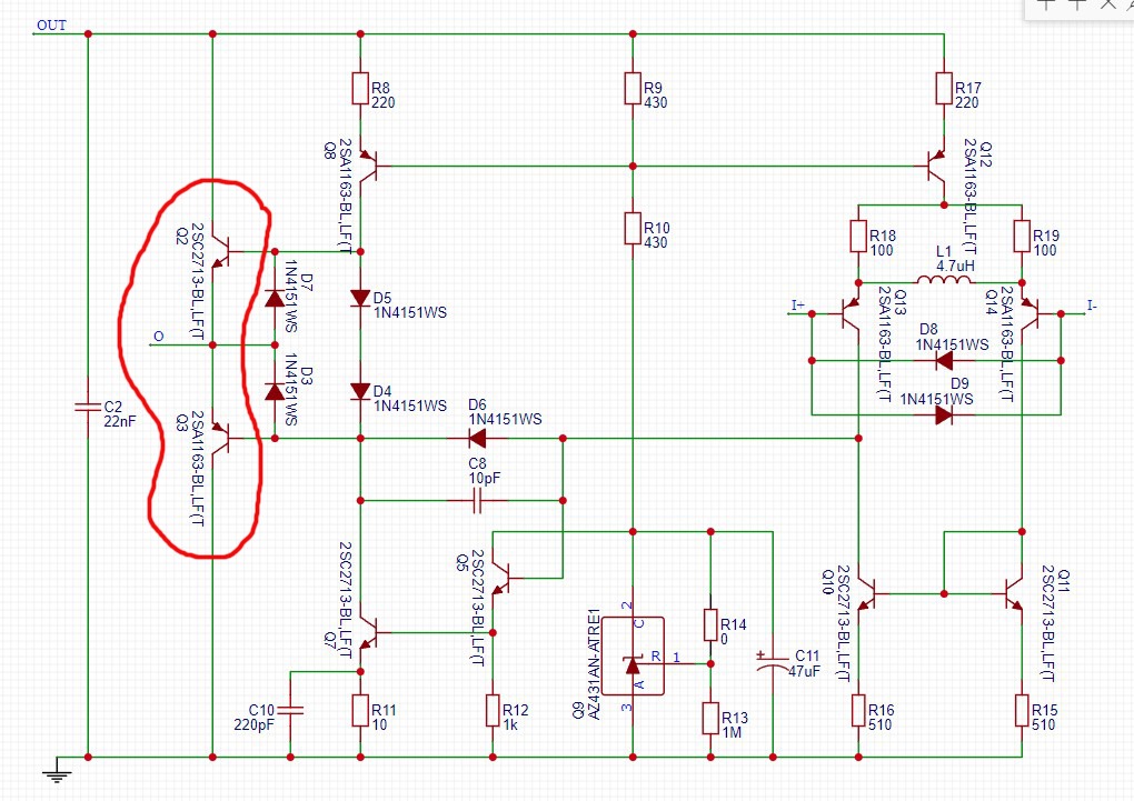

OMG! I forgot two resistors between Q2 and Q3 : ( might that be the source of problem?

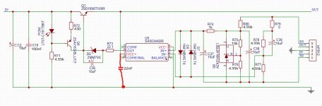

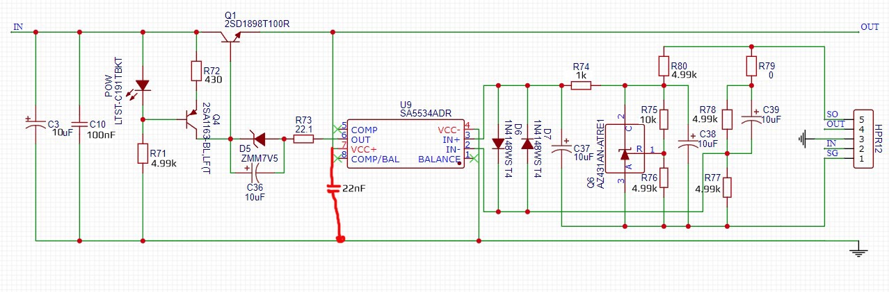

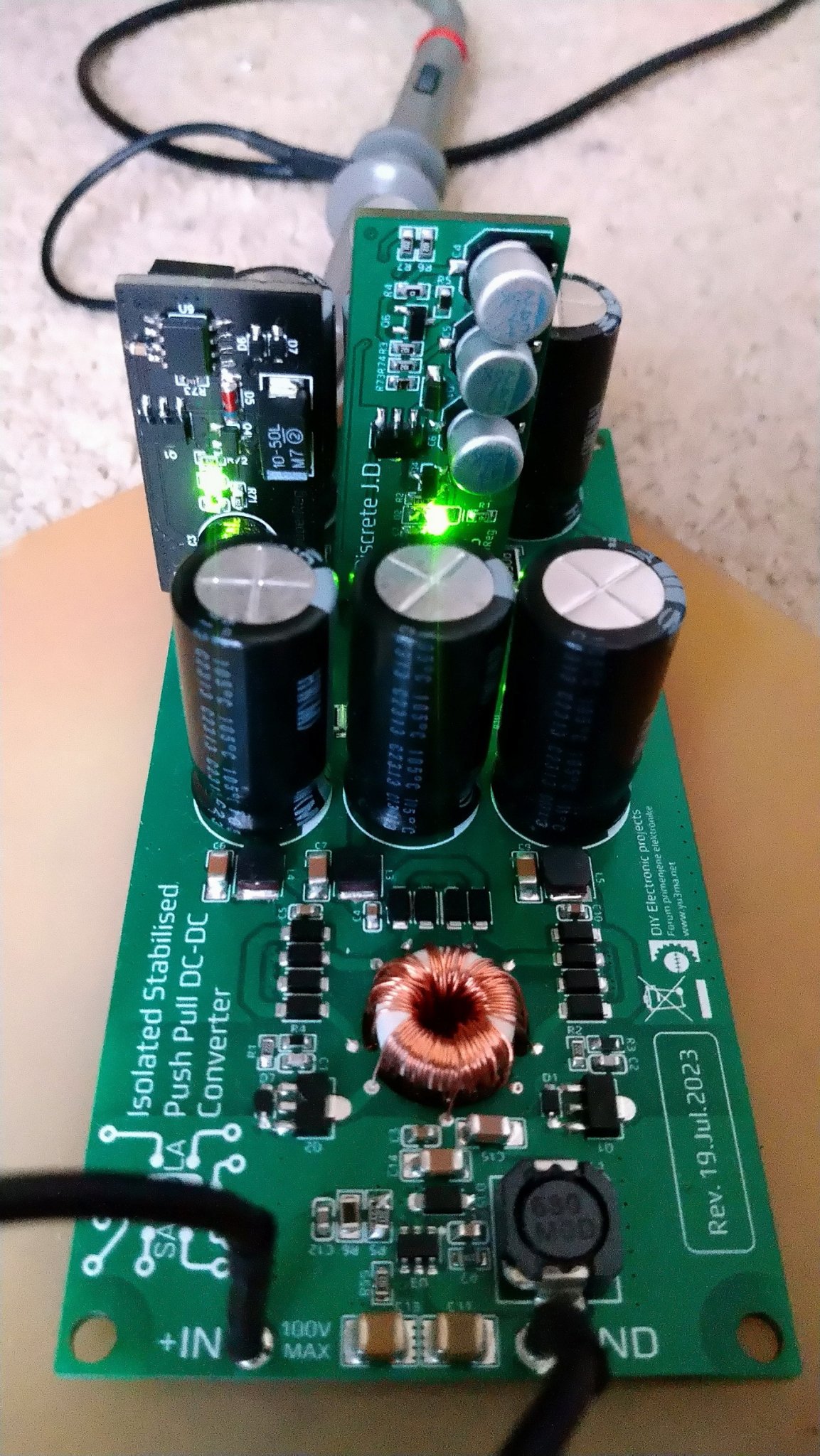

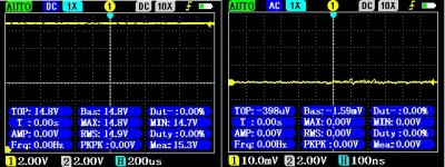

I didn't had luck this time with discrete version, I'll try to make a different layout because I know that regulator will work because the bigger version works well, very good transient response, so this mini version must work too, I won't give up! This is the good result with SA5534 mini version (black one on the picture) I made recently

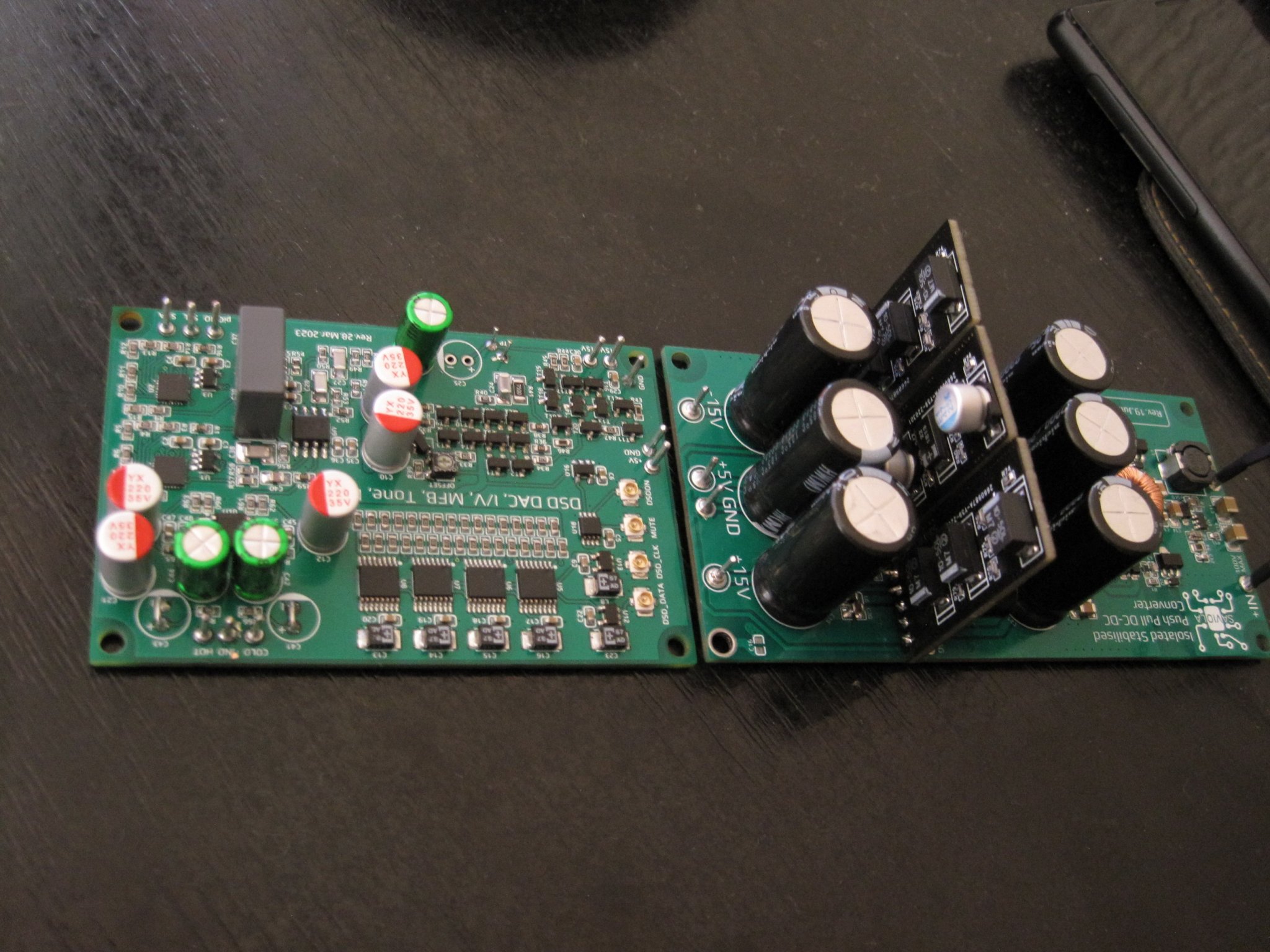

Done all 3 voltages needed for DSC single ended dac with tone control, mfb, diff, it is as a frontend for ucd180hxr. All 3 votages is stable as in previous post. 5V schematic resistor values is in atachment, the rest of components is like in previous post except resistor values, opamp and zener diode. Opamp here is opa209, for +-15V it is sa5534. Instead of posting gerber,bom,schematic I will open new thread when fully test all things together, you will get push pull iso pre regulator, 3 j.d. regulators, and frontend for ucd, all going open source soon!

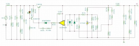

I modified this schemaic to 5V version. D2 I am using 2,4V zener 0,5W because from local shop they have only this close to 2,5V. For D4 I am using LM4040 2,5V. Q1 and Q2 re BD140 and 2SC5200 for Qizl. D1 is GREEN Led. Input 13 V ac 3 Amps. OPA1611. R6 value is parallel combination with resistor and trim pot.
Problem is that Qizl 2SC5200 gets very hot in 3 minutes so I can not hold more than 3 seconds my finger on the SK-129-50 heatsink. What kind of heatsink is good to use for 2 amps output and what changes to make in this schematic for better reliability and noise specs?
