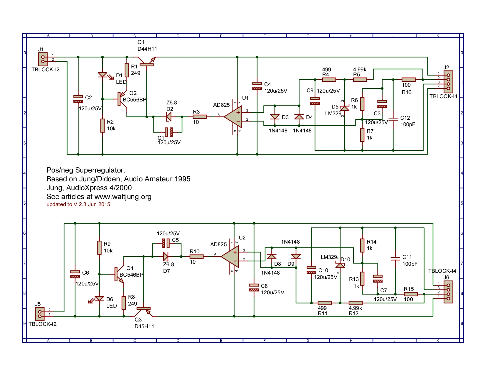

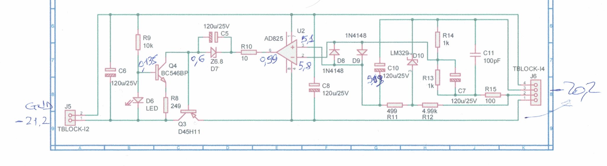

Maybe a rerun of earlier comments, but here goes:Dear All,
I need some help to debug a Negative Superreg at -15V.
I build 3 regulators for a dac that need +5V, +15V and -15V.
The +5V and +15V work at the first power up, absolutely stable, but I am not able to make the -15V working.
I recheck all the components, I changed the BC546, the LM369, the Zener 6,8V that I have available.
I do not have the AD825 so I install a OPA1641 that I have from another project but the result is the same so I reinstalled the AD825
I am sure I miss something very simple and I aid to ask for help for a so simple board but I am stacked...
I power up the board with a lab PSU and the Vout is following any change on Vin with more or less 1V difference
I take some measurement on the board referred to GND
Any support will be appreciate
Thanks and Regards,
Enrico
The base of Q4 cannot be -0.135 to ground, obviously, unless there is no voltage drop across R9.
Thus there is no current through R9, thus D6 is either disconnected/broken or wrong way around.
Remove the opamp and Q3 and fix the Q4 base voltage first.
And check that you really measured against ground; that's the top line in the drawing.
Jan

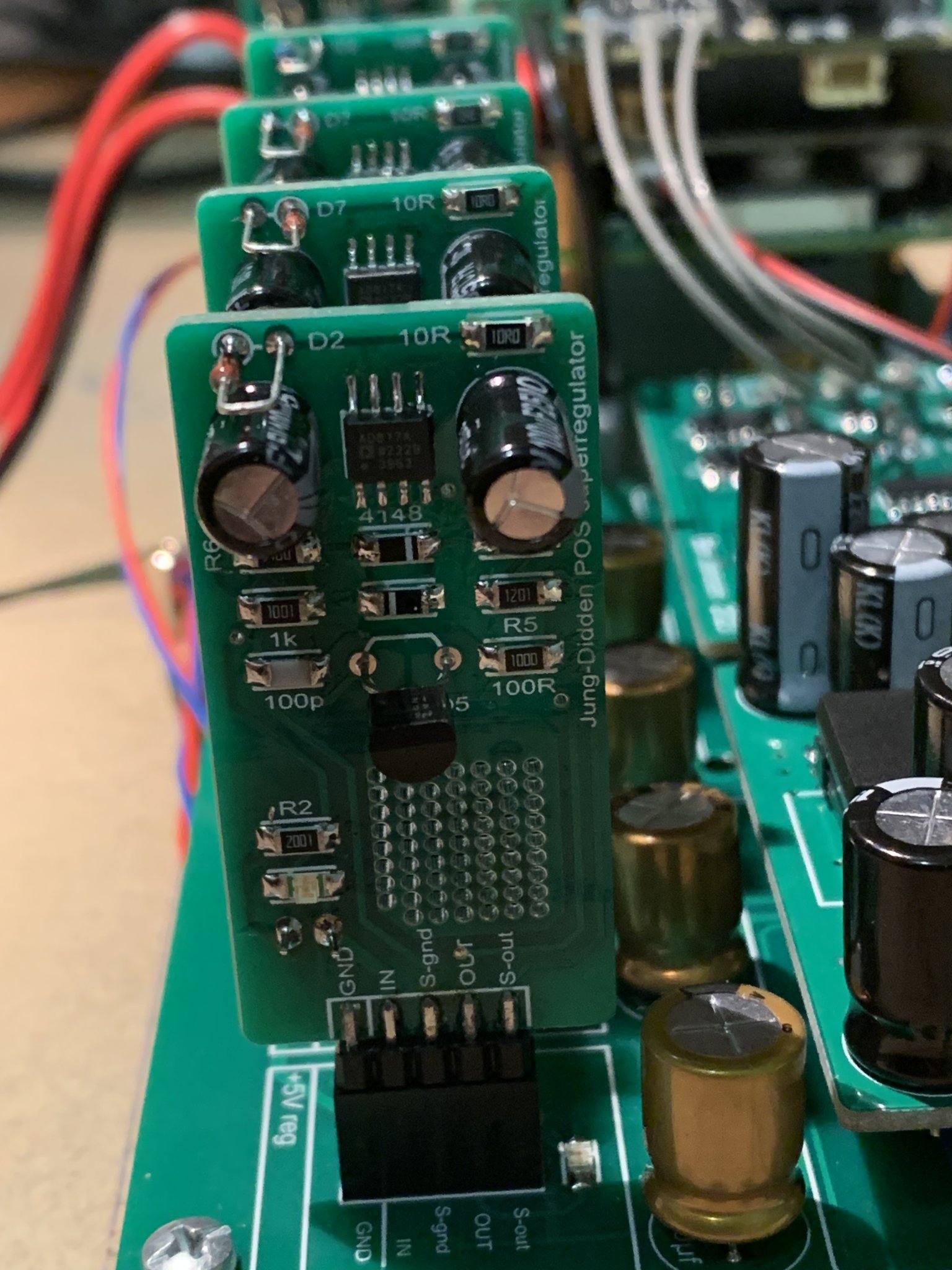

Thanks Jan and All for your replies,
The PCB is not the original from DIYAudio but I design myself long time ago exactly as Jan design with the exception of the ground plane.
I design myself first of all because I like to design pcbs and also because I was ordering other pcbs to pcbway and was easy and cheaper instead place the order to DIYAudio.
I am reading again the long thread and I understand that is not a good idea to create the ground plane at the bottow and I hope this is not the problem.
The positive rail have no issue and it's designed with the gound plane too.
I rechecked anyway the PCB point by point with the schematic and is fine, no mistakes here.
I dismounted the OP, Q3 and Q4. The led light up that's is fine, not reversed and not broken.
I checked Q3 and Q4 with DCA Pro from Peak and both are recognized and fine. I have anyway some spare
The only issue that I have is the opamp. I have no more AD825. The only opamp I have in the hands is the OPA1641. It's a good substitute or I have to order the AD825? I live in Vietnam and get some good part here is quite difficult...
@ Jan, I think you are right, probably I take the measurement from the GND of the PSU that actually for the board is the -DCin. Sorry about that
If you confirm that I can use the OPA1641 I will resolder the board and send back the correct measure.
Thanks again to everybody for your kind help. Really appreciate
Enrico

Well done, that's progress. You can build it up with Q3 and Q4 without the opamp. The Vout should rise up to the max, a few 100mV below the input. But that will allow you to measure and see if all is well like the current source and the reference.
If that works out fine (post measurements here) you can plug in the opamp and see how that goes.
Don't do everything all at the same time because it's hard to diagnose in such a situation.
And don't worry about the groundplane, that's not a go/no-go factor.
Jan

Arghhh... I found the stupid mistake!!!
I inverted the output pin 2 and 3 in the PCB, mean that when I bridge pins 1/2 and 3/4 for the test actually I was bridging 1/3 and 2/4.
I did recheck the board 2 times before asking for help but I miss it.
My sincere apologize to to waste your time...
Jan, you think that I can remount the AD825 or better I use a new OPA1641?
Sorry again guys...
Enrico

Well you were successful, that's great on a Monday morning ;-)
In fact you are right that those connections are not completely logical.
I could change them next time but then there would be two different boards around, adding to the confusion.
A rock and a hard place.
Opamps are pretty resilient if you don't overvolt them. Give that '825 a try.
Jan

Dear Jan,
Thanks for your kind words
I think that the connections are logical as they are and follow the schematic. That was just my mistake when I design the board.
I installed back the AD825 and you were right, everything work at first power-up.
Both the positive and negative 15V give me the same value, 15.2V... impressive.
Thanks again Jan for your support
All the Best,
Enrico

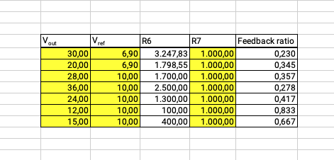

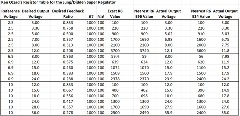

Hi dvd7900. Point taken. Articles read. Answers found.
(My question about the voltage at the inputs arose from having lost track of some basics of opamp operating principle. I get that now.)
The other point about the voltage divider I apparently got right. I asked because for ease of calculation I wanted to reproduce in Excel this table at the diy audio store page:
Which worked out nicely once I took the 100R at the +VDC sense line into account:
So far so good. (The five bottom rows are values that appear in Ken Ozard's table. I included them to make sure my sheet behaves the same way Ken's does.)
To follow your suggestion: I need two SRs, one with +30V and one with +20V output. My calculation shows 3k25 (30V unit) and 1k8 (20V unit) for R6, assuming 1k for R7 and LM329 as reference on both boards. Is that correct? I may play around with these if necessary to arrive at E96 or E24 values but they look pretty good.

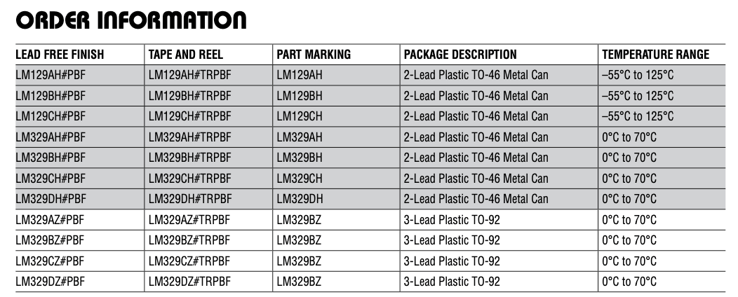

- There appear to be different versions of the LM329. The Sjöström units that I have previously built came with the LM329DZ variant. In one of Walt Jung's articles I read that DZ was the "loose tolerance version". Don't know why that would be preferable. Mouser has AZ, BZ, and CZ (A being more expensive (and lower stock) than B and C versions). What's the difference between these? The LT datasheet is totally un-informative on the difference:

30 VOLT OUTPUT ( Assuming 6.9 VREF )
R7 / R14 = 665 ohm
R6 / R13 = 2.1 K
D2 / D7 = 15V Zener ( 1N5245 or eqv. )
20 VOLT OUTPUT ( Assuming 6.9 VREF )
R7 / R14 = 768 ohm
R^ / R13 = 1.33 K
D2 / D7 = 10 V Zener ( 1N5240 or eqv. )
I would doubt there is any measurable or audible difference between using a LM329 D or A grade
in the regulator circuit, but if your just building 1 or 2 regs, I would spring a couple of bucks more
for the A grade.
Main reason being that there appear to be measurable differences with a different higher quality reference
according to some of the research at WALT JUNG.ORG and there is definitely audible differences with these upgraded reference circuits
according to some folks in this forum. This is however a whole other topic and does require other changes to the reg circuit.
For C11 / C12 use NPO/COG 100pf.

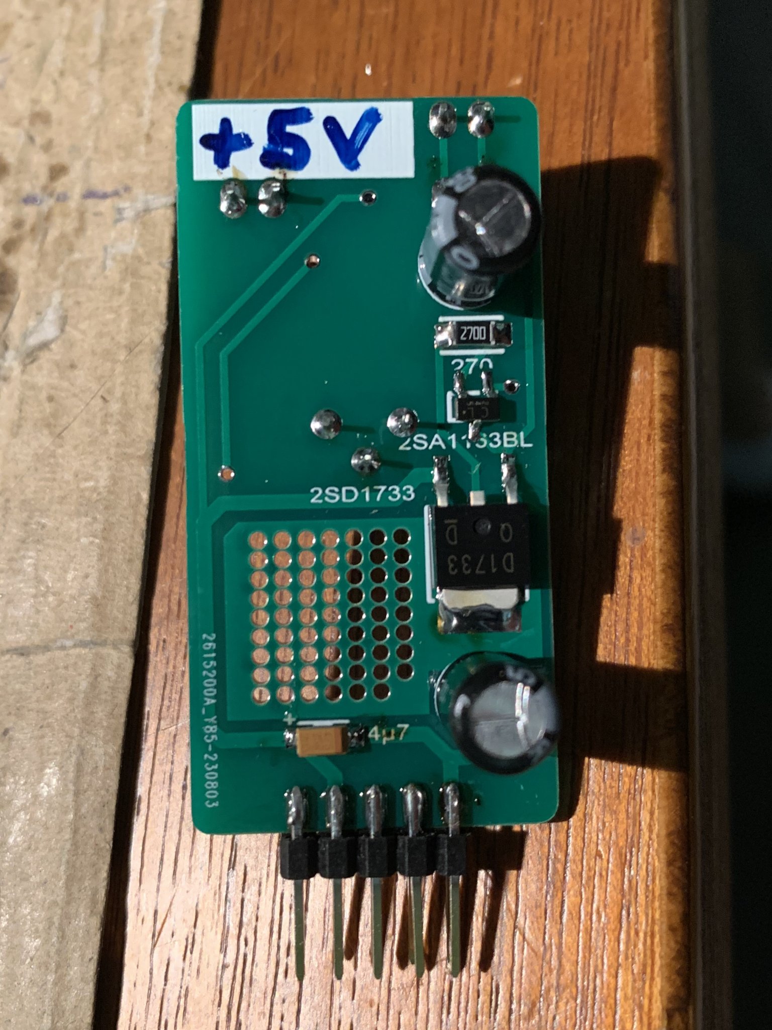

Looking for advise:
Build:
I build a +5V Jung-Didden super regulator. As I have not much space, I needed to design a new PCB using SMD components.
Differences with the original are the BJT's, I've used 2SA1163BL(CCS) + 2SD1733 (series bjt), these are quite some faster as the original's used. Opamp is a AD817.
The "big" output cap is not installed on the small regulator boards, instead, I've installed a small tantalum 4µ7 cap.
I've used the sense lines and installed the 10R + 10n, as decribed in the article (REGULATORS FOR HIGH-PERFORMANCE AUDIO).
The sense lines are running on the bottom PCB (picture 1) up to the header to insert the DAC IC, this IC has local decoupling 100n COG next to pin's).
I use this to power the +5V for a TDA1541A DAC.
Problem:
On the scope when probing between the GND and the output of the regulator, I don't notice any difference. This looks good to me.
However sometimes the regulator goes in oscillation, I was able to simulate this when touching the sense connection on the regulator PCB.
Installing a series R of about 1 R between regulator output and 100µf output cap (Nichion Fine Gold), this solves the issue it seems.
Question:
Any Idea what could be the root cause? The -5V and -15V regulator's don't have this issue.
Is installing a small series R between regulator output and output cap, a good idea?
Other, better options to solve the problem?

The low esr input/output caps is not good for J.D. regulator, you should notice that in Tina simulator in bode plot. In my case 90 mili ohm (15mohm cap + 68 mohm resistor in series with cap) produce good bode plot. Or try with an higher esr caps e.g. one with 100 miliohm esr.
Hi Savan,
For output cap, I'm fully aware of this, but even wihth 1 Ohm in series with output cap, I have oscillation.
This J.D. is supplied by +8V delivered from a LM317 with only a 10µf tantalum cap (nothing else). On the J.D. board is a 100µF pana FR.
Something strange is goiing on in combination with the TDA1541A, but what??
Remember as I mentioned in post 3236, all other regulators have identical setup, and no issues.
