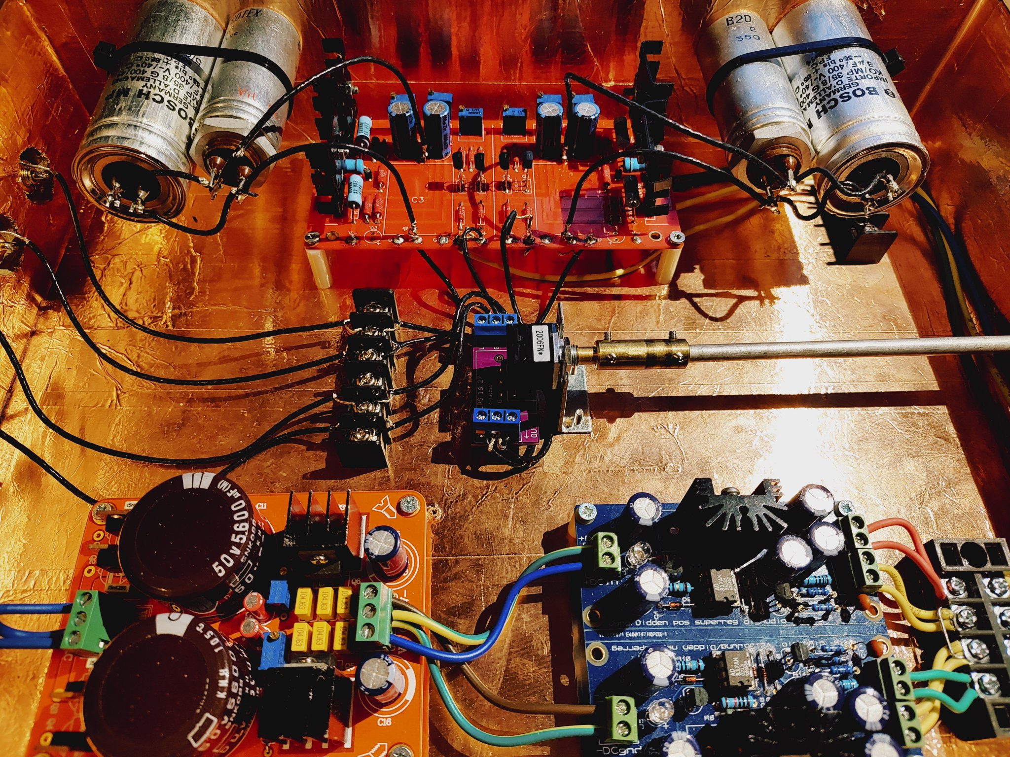

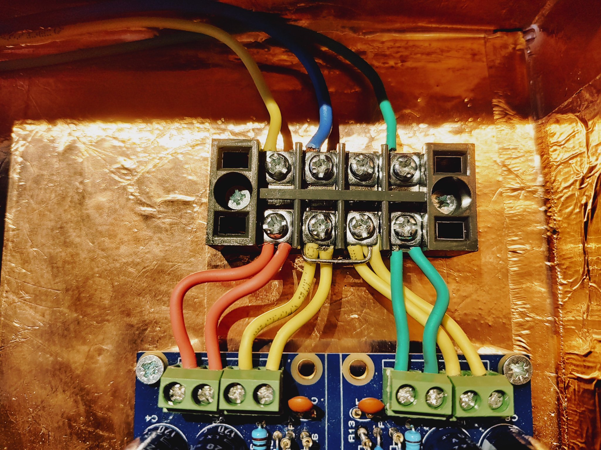

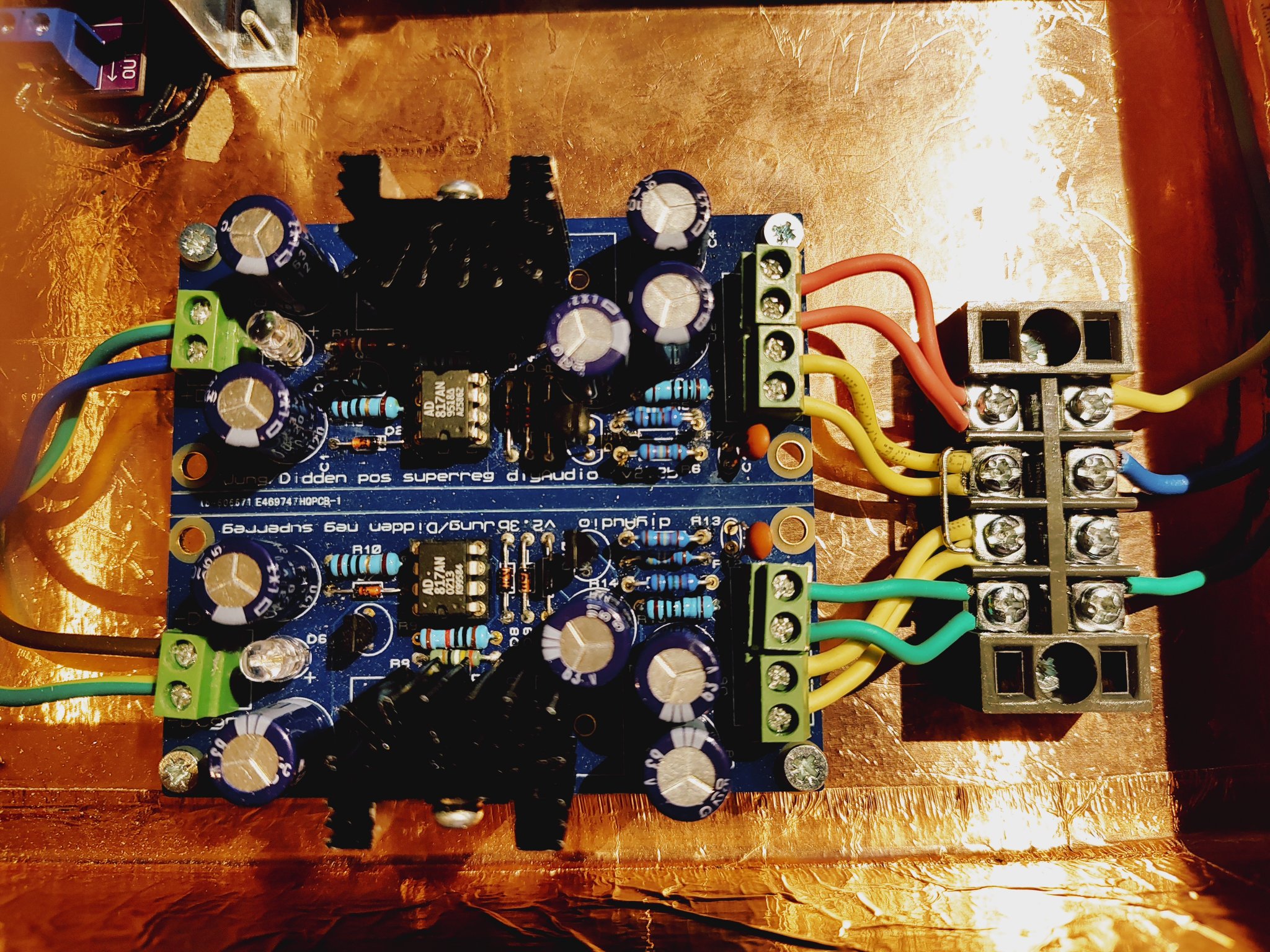

Hello good morning, I have a question.
I tried to put into practice the suggestion given to me to have 24 vdc at the output.
I just replaced R6 and R13= 1.72Kohm and R7 and R14= 705ohm without changing anything else...and hoping I understood.
Superreg.. powered with 24vdc, output from Superreg..23.9/24 VDC!!!!
Sounds perfect, but here comes the question,...why don't the two LEDs light up?? I can't figure out where I'm wrong.
PS: sorry for the color of the cables but I'm doing some tests.. yellow at V+ of BA3, blue at GROUND of BA3, green at V- of BA3, and power is external, out of the chassis.
Thanks again!!
PS1: Before being used (supereg) I used it on another BA3 and everything worked including the LEDs.😵😵
Ok, I understand, I'll try to set the input voltage at 28 vdc right away.
Thanks, I'll let you know the results.
Your resistor values are correct (if you use LM329).
But you cannot get 24V out with 24V in, there is no regulation.
Either increase Vin to 27 or 28V or lower Vout to 20 or 21V.
Jan
Okay, set 28 vdc, perfect sound good and LED!!!
Thanks a lot Jan

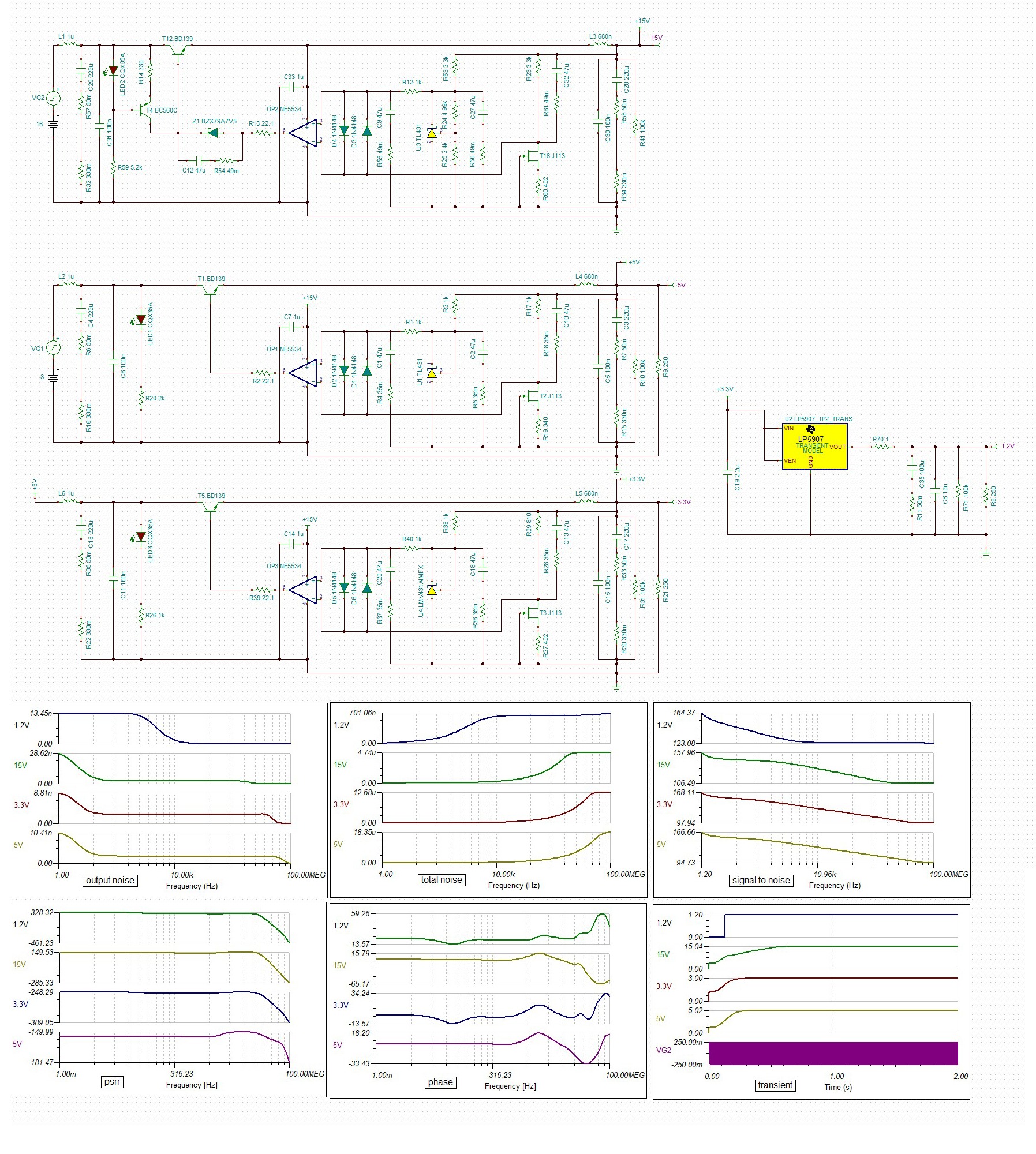

I don't know how important phase is here but I have paid special attention to phase, can't get better than this. What I have learned is low esr caps at the input and at the output gives worst phase response so I have added optimal resistor 330 ohm to in-out condensers which have esr as you can see 50m, that gaved me ok phase. Additional inductors at the input and also at the output gives me almost ideal phase. This is TinaTI simulated circuit which I'm going to try on real pcb. +15V above is supply only for opams, an small reg, and the rest is supply for digital circuity, if succed it will be main supply for my next direct digital audio amplifier 🙂

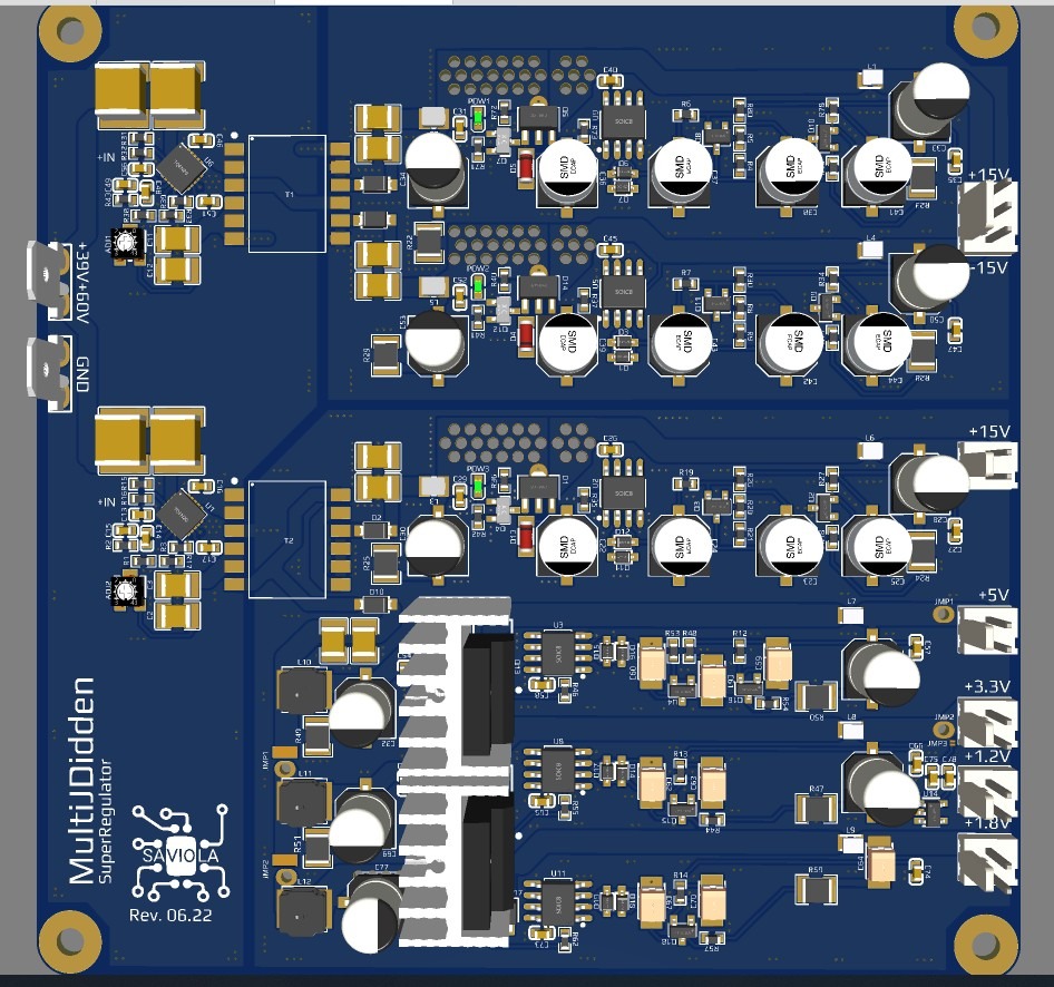

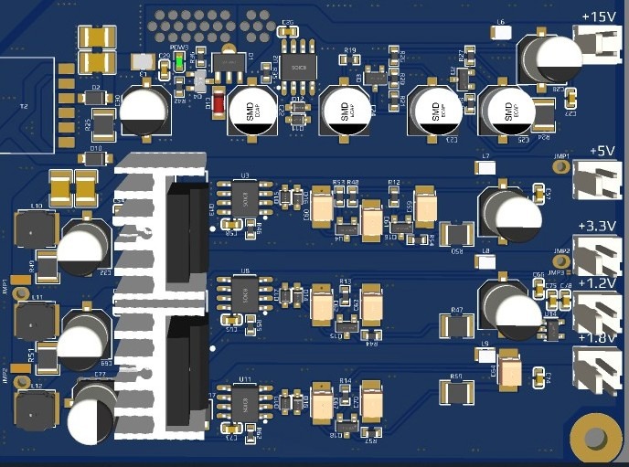

This one I have made isolated but newer built, since flybuck regulators from Maximum chosed here is for 10W maximum I will remove them and will make an test pcb soon in relation to post 2895 and will post it here when I finish pcb design. This one looked promissing but sadly for 10W only, my waste of time designing them 🙁 Dimension 110x110
Edit:
it will be probably ~70x70 like picture 2
