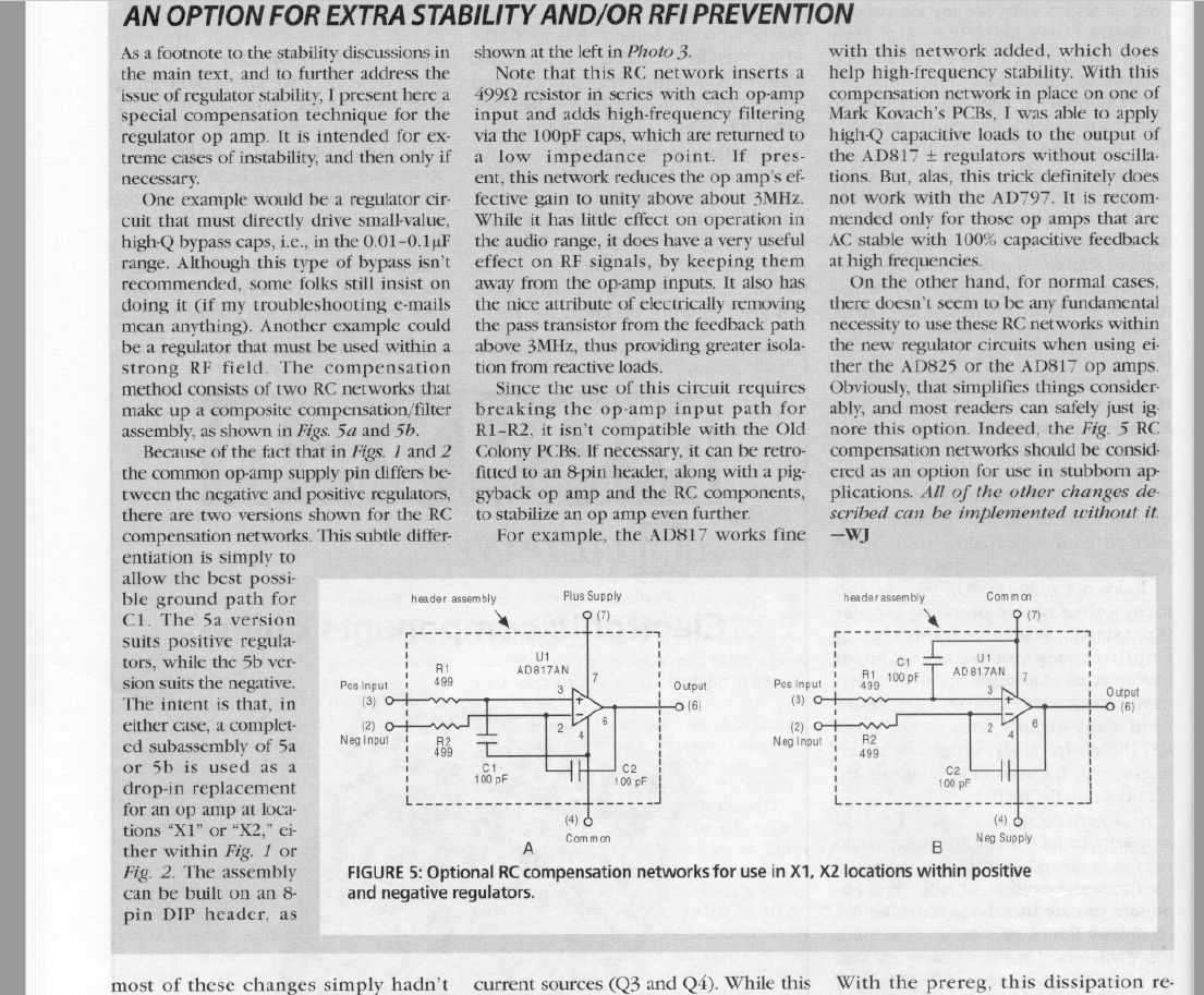

@RickRay have you tried this, it's from the original Walt Jung article Improved_PN_Regs from Audio Electronic 4/00. Maybe only C2 can help.

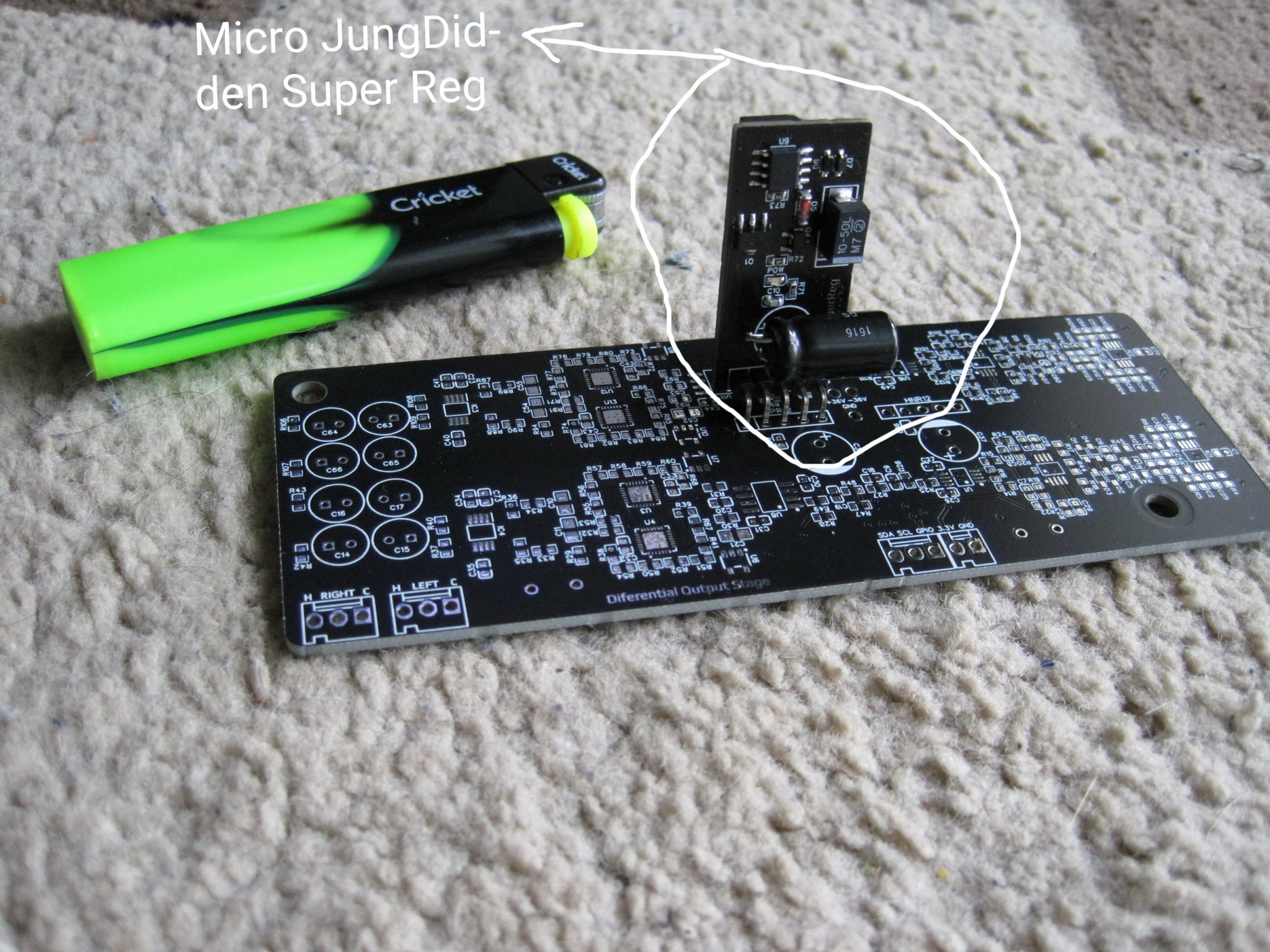

Thanks! Pcb above is replacement for audio transformators on DSC2 dac, with success, for the first time I had few volts dropuot and a bit hot regs so I needed to add predregulators to get 17V first and its ok now, stable 🙂
