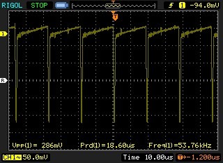

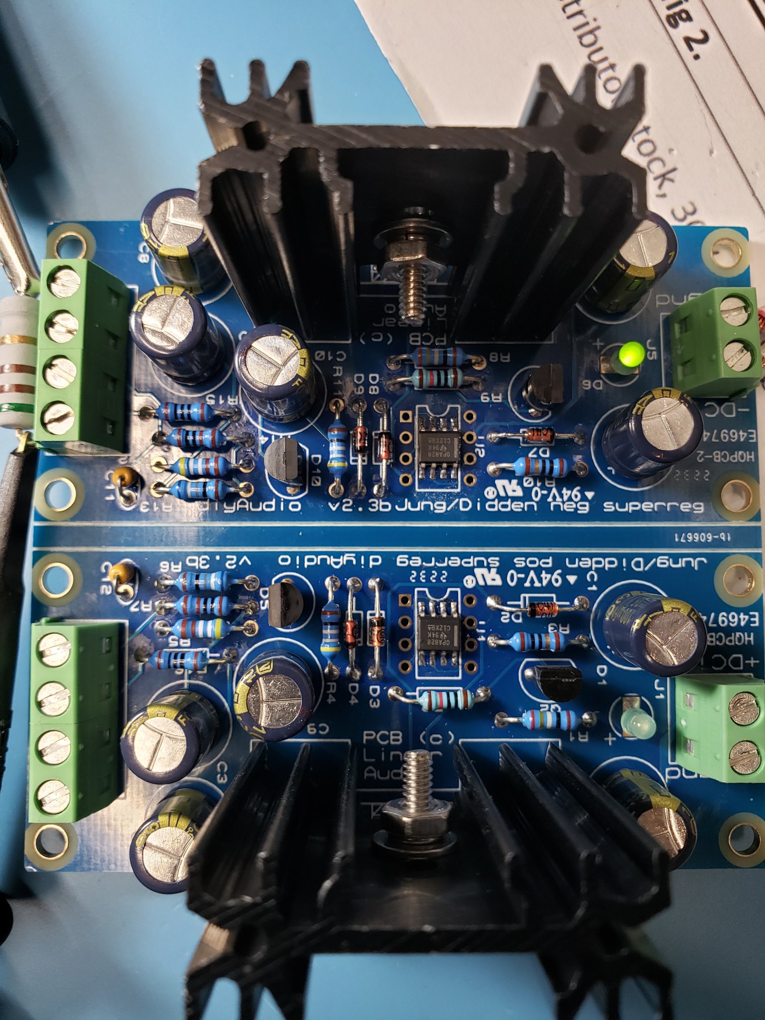

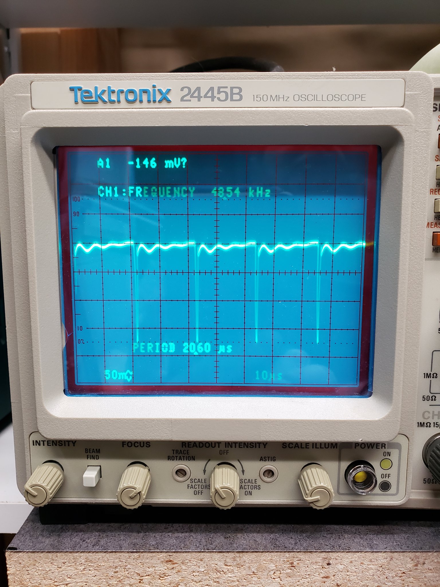

I have assembled a positive and negative super reg, both, the led's light. I am starting with issues on the negative reg. I have adjusted for 18V output, R14 1k and R13 698R. I replaced D7 with a 10V Zener and replaced D10 with a 10V reference, LM4040-10. I have placed jumpers from the sense lines to the load lines at the output terminal and have a 500R resistor loading the reg for 36mA output. The output is well regulated at 18VDC, however it reads 24mVAC on the output with the load, not super. BTW, I am providing 25V into the reg with a Rigol P832 bench power supply. I did take a look at the output with a scope and the picture is below. I used an OPA 828 for U1 and U2, I had them on hand.
Rick, a few questions: how did ypou measure the 24mVAC, between which two points? Was it with a multimeter not connected to any mains or a mains-fed voltmeter?
Same Q with the scope - between which two points?
Also please scope the input in scope ac setting, between the two input points.

Holy cow, never realized the bench meter would be less accurate. I remeasured with a Fluke 87III handheld and it reads 1.50mVAC . I measured across the output terminals. The scope is connected across the 500R load resistor, you can see the scope leads in the upper left of the picture of the board. I did take a look at the input with the scope, it looks identical but inverted. Looks like I need to recheck with an actual linear supply huh?
Not necessarily. If you measured with the bench at a different ground point, all bets are off. You might be measuring a ground-current induced noise.
That's why I said measure across the load directly, that is what the regulator, ehh, regulates ;-)
If you connect the sense lines directly to the load and measure at those points, you should effectively measure zero on the DMM.
As far as the scope is concerned, try to run it with its mains earth disconnected, temporarily of course.
Then measure across the load with a very short probe ground lead, dressed along the probe as far as possible.
