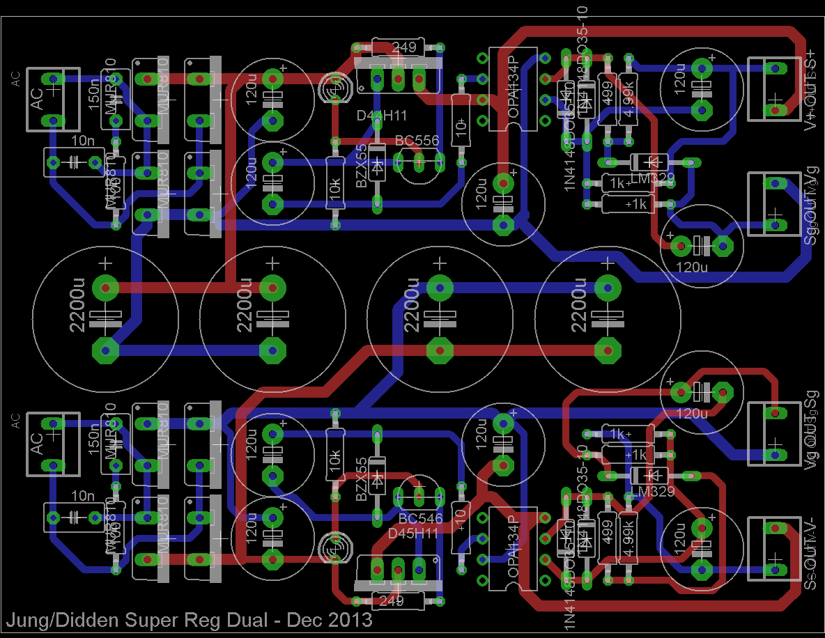

Any though of selling the board through the diy store ?I finally bit the bullet and layed out a set of superreg boards based on the original 1995 series articles, updated after Walt's 4/2000 article.
These are the successor boards to the ones Jack showed here.
All info is here: The Superregs
Let me know if there's anything I missed or got wrong.
jan
Yes, if they want it. I offered it to Mark (Variac).
Now we wait for their response . Thanks .Yes, if they want it. I offered it to Mark (Variac).

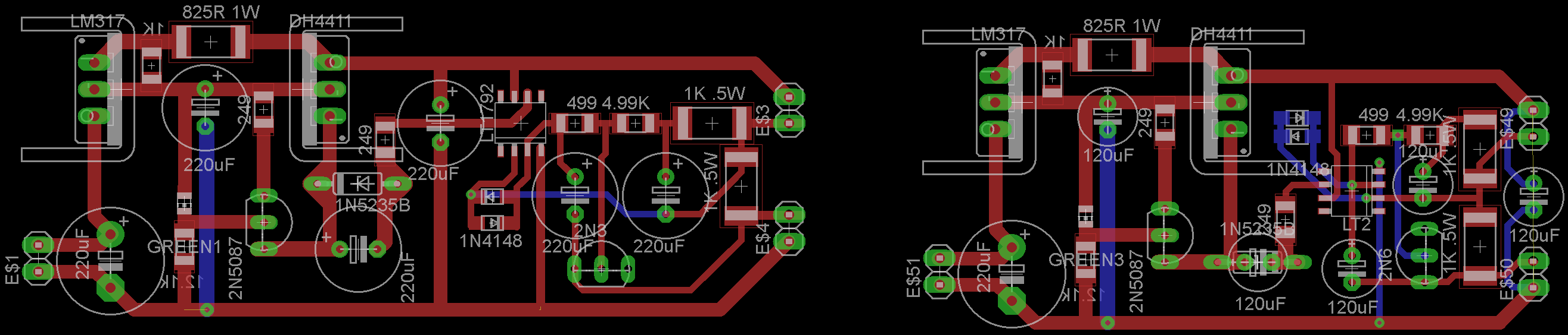

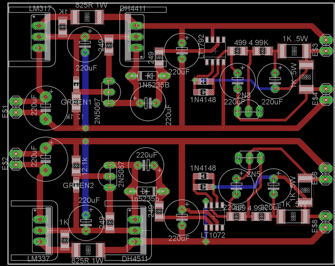

HEre is my attempt at a dual rail version using SMD. Jackinnj has made some suggestions in another thread I will attempt to implement.
I chose LT1792 based on a recommendation by EUVL and because it will allow for the possibility of larger output voltages, if needed. The caps are Panasonic FM, spec'ing slightly better than recommended replacements of FC. Of course FC can be used as I believe they are equivalent in size. I may have oversized the caps just for freedom in choice. The board is 2.5" x 3". I will work on the revision and appreciate any comments. This will be used for a DCB1 to start and then for a phono pre. It will be compared to the Salas Shunt in both cases. The phono pre is the aplication that will need larger output voltages.
moderator should probably move your post to the "Super Regulator collecting the facts" thread -- an observation -- the sense resistors shouldn't be at right angles, the error amplifier should be rotated 90 degrees so that pins 2 and 3 have the shortest possible route to the sense resistors. using capacitors larger than those specified by Walt will affect the performance of the regulator. those originally specified in the 1995 article are no longer available so use panasonic fc.
