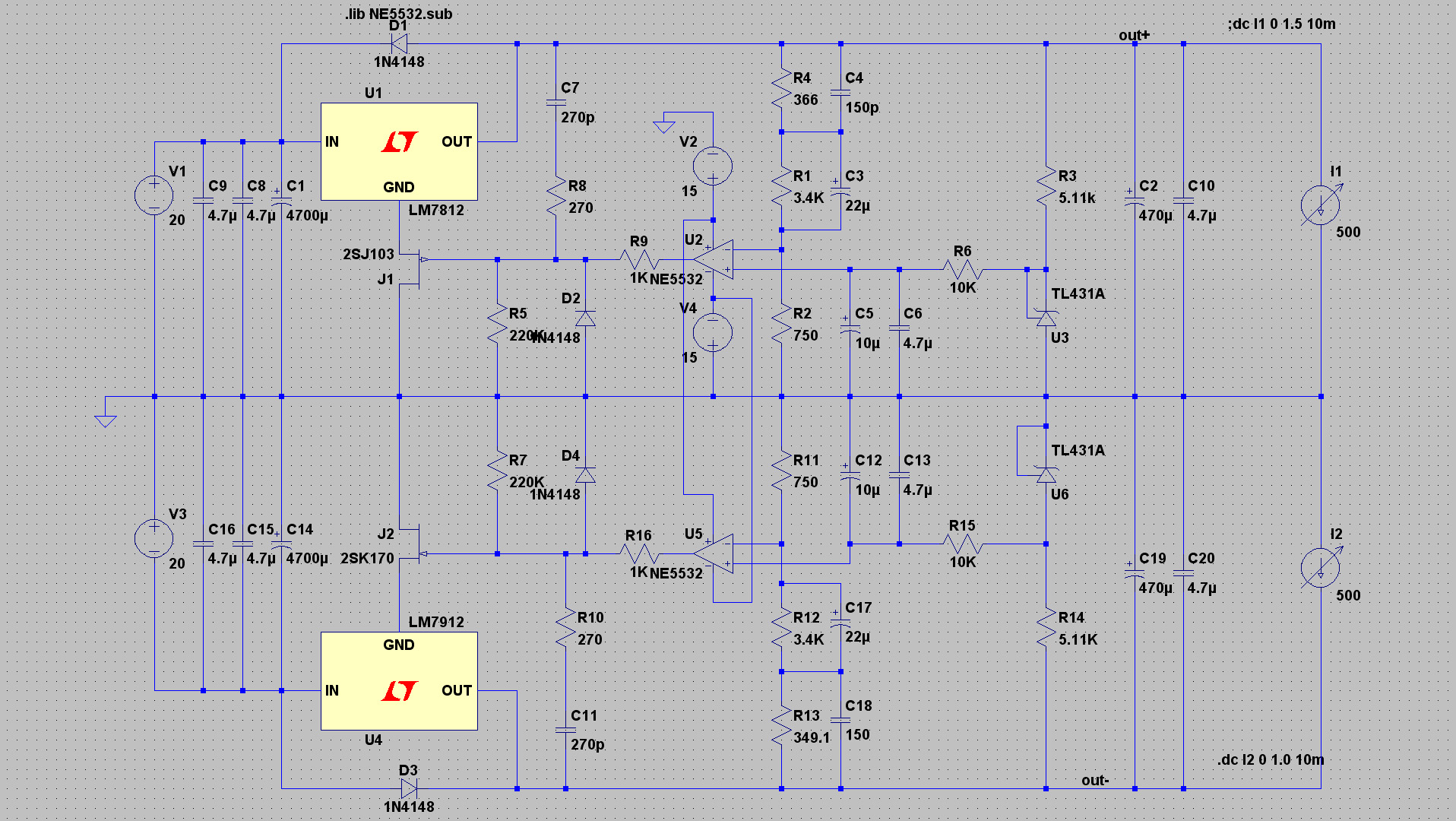

For example, simulate our Russian circuit and Jung super reg circuit in LTSpice or other simulate program and see result of simulation.
Every time I simulate it, it oscillates. I'd like to see a Bode plot from 10Hz to 10MHz. Consider some R between the collector of Q6 and ground (this has been mentioned before.)
With respect to PA's comment -- the faster the opamp, the lower the output impedance of the circuit.
..Though there's no use using a faster/slicker/more-fashionable opamp if you cannot stabilise the whole and keep it that way into the real-world load it drives (over the full range of expected load currents)...

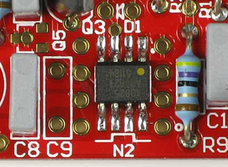

One nice thing which PA did with his boards is provide for an SMT error amplifier -- if you rotate the chip 90 degrees you can put in pads for an AD825AR. Thus you can use both SMT and through-hole. The two 1K resistors in the output sense/divider should be provisioned for 1/2 watt.
Jack, could you provide a bit more info on this? I built the SSR01 as provided in the instructions, but did not see anything (or missed it) regarding this option.
You have it in the schematics and in the complete BOM. The transistors have SOT23/TO92 footprints. See Q5 in the picture.
