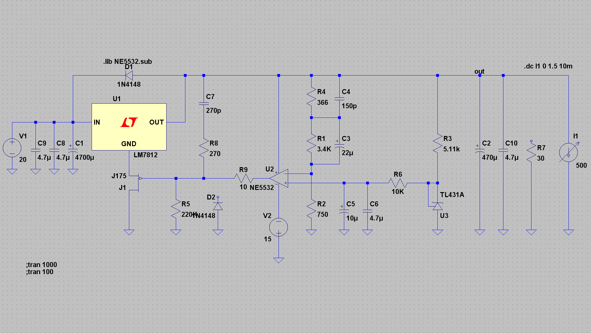

Does anyone know the internal design of the LM723 ? How about the bandwidth etc of the internal error amp ? I'd like to try Jung's super-reg but I'm wondering how to connect a current source into the output of the error amp to bias into classA, and also a diode to control flow into its output. Here is the functional diagram :
Can I use the frequency compensation pin ? The diagram appears to suggest I can but of course I don't know what the actual circuit is.
I'm planning to connect the unregulated input supply directly to pin11, and a regulated supply to pin12. Vref connects to the non-inverting input via a low-pass filter.
I'll start with unity gain with the output connecting to the inverting input via a 10K resistor.
I was wondering if I could also use the zener between pins 9 and 10 as the zener on the output of the error amp ?
Any help is greatly appreciated !

I have LT Spice but I don't know how to load code into it - sim noob. I saw a discussion about that code here :
lm723 ripple rejection ratio @100kHz
and it seems it has a very good ripple rejection and low noise, which is what i want - it'll be a pre-regulator feeding a 5V LT1763, a 2.8V LT1761 and a 5V LT1761, drawing 50mA in total (for the analogue supply of an AD1955 DAC).

ALWSR -- you should probably consider using the depletion MOSFET pre-regulator which WJ shows on his blog -- lower Zout than the Weekes version.

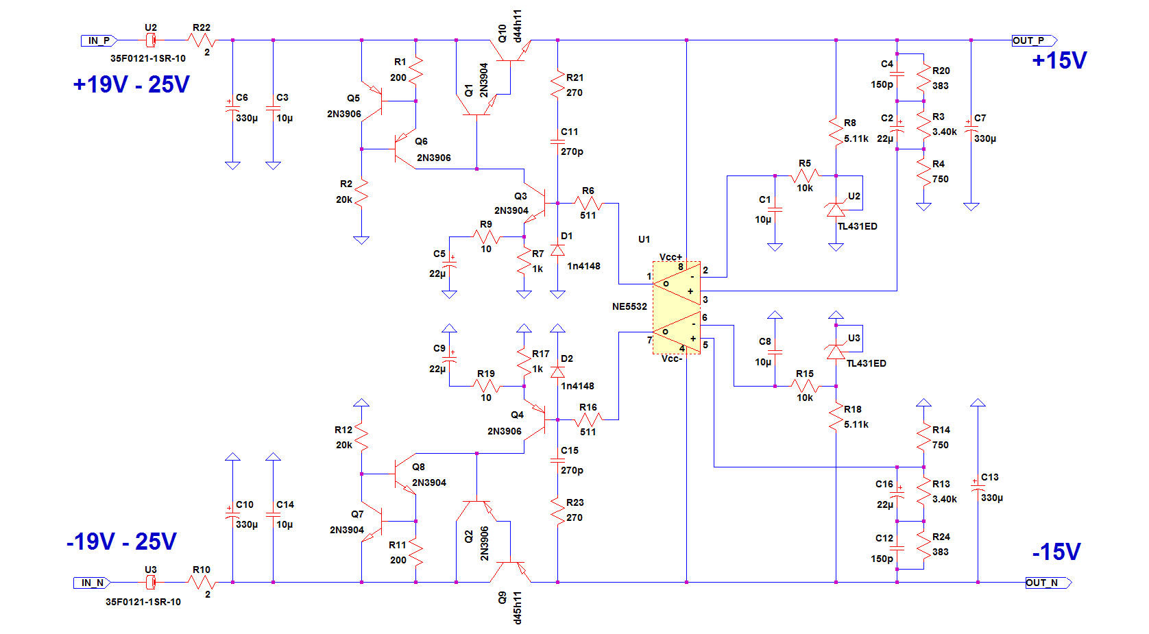

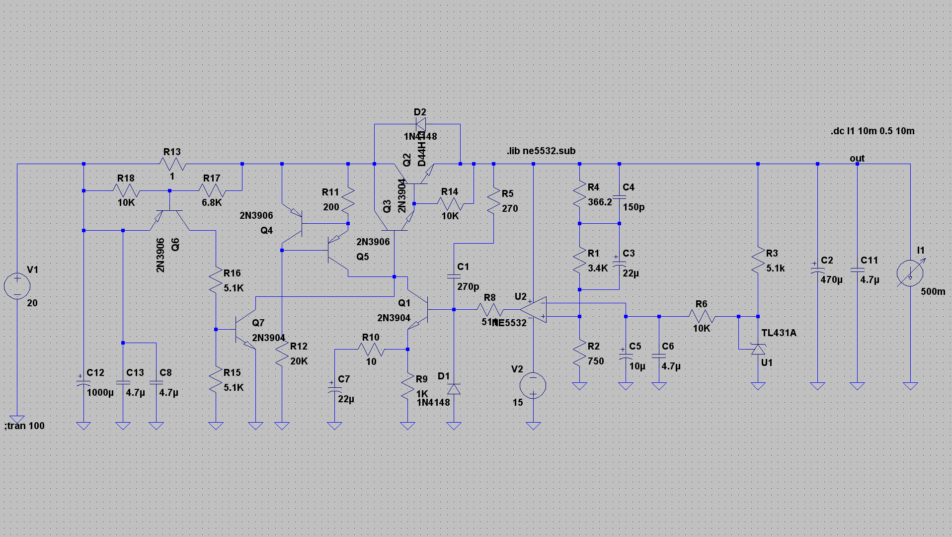

This is Russian answer to Jung super regulator, see circuit.
Output voltage is +15 Volts (positive).
Limit current is about 900mA - 1A .
Negative polarity, please, change transistors as follows.
NPN to PNP D44H11 to D45H11, 2N3904 to 2N3906
PNP to NPN D45H11 to D44H11, 2N3906 to 2N3904
Change diods to other polarity on circut.
Negative suply of OpAmp to output line of negative reg.
You may add LM317 (LM337) in input line as preregulator to this reg.
Prototype of this reg is circuit picture two.

In simulator LTSpice IV OpAmp NE5532 works better than OpAmp AD825.
Jenyok, what do you mean by 'works better'?
jan
We did this reg in two hard copy.
I mean better... So...
For example, simulate our Russian circuit and Jung super reg circuit in LTSpice or other simulate program and see result of simulation.
And...
You will see, that our Russian circut is more better then Jung reg circuit.
In our Russian circuit is smaller instability of voltage output under loading output.
In our Russian circuit pulsation of voltage output is smaller than in Jung reg circuit.
In our Russian circuit coefficient stabilizing of output voltage is more than 70000 (> 100dB), in Jung reg circuit coefficient stabilizing of output voltage is less than 70000 .
