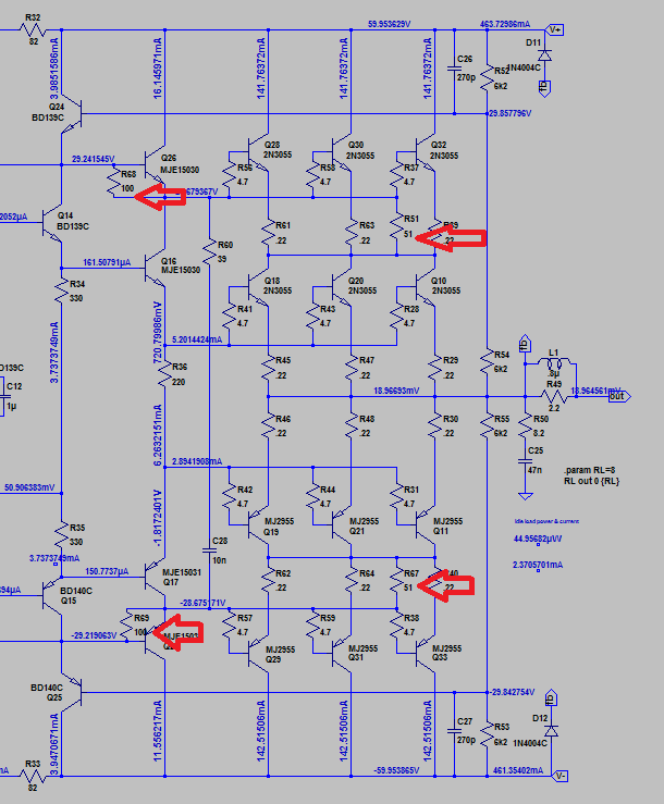

I looked over the output stage carefully and something jumps out at me as not right. The
driver transistors turn on the outputs and most often there is a resistor from base to emitter
to turn them off.
Typically 100 ohm resistors are used on output devices but a lower value turns them off
faster. The easiest way to see what should be there is to look at the Heathkit schematic
for R141 and R143 - Leach's student got it right but they are a bit low.
Another clever thing that he did was to keep the emitters on the series connected output
independent allowing him to eliminate the .22 ohm emitter resistors - nice.
The driver for the series outputs is also missing a base to emitter resistor in Leach's amp.
This would be R147 in the Heathkit amp.
Something strange in the Heathkit is R137 being 22 ohms that really biases the drivers, hot
very hot. We usually see 50 to 100 ohms there but if you can provide enough heat sink,
and you have much lower rails so it would probably work even with 22 ohms. Big devices
need high bias to get to a more optimal operating point. Also R137 turns off the main
outputs, the lower the value the faster the turn off.
You asked about the fuses in the Heathkit - those are to protect the VAS and front end,
they are only 60mA. You mentioned that the Leach protection clamp doesn't work, did
you use devices with good performance at low Vce?
Here's a schematic with resistors added, values can be adjusted as needed, arrows in
red point out the 4 additional resistors.
If it looks like I compressed your schematic, I did, since I do my relaxed work on a
laptop and I couldn't read things very well without the changes.

So you mean those are missing from leach's design then.
The easiest way to see what should be there is to look at the Heathkit schematic for R141 and R143
Yes, I see those. Missing from leach's schematic. Maybe with properly tweaked models and a few such corrections, we can get to something working properly.
Another clever thing that he did was to keep the emitters on the series connected output independent allowing him to eliminate the .22 ohm emitter resistors - nice.
Right, I see this too. Then we should do this on this design, cut out those links between the stacks and drop a bunch more unnecessary parts.
Lower part count is good, and at the same time it simplifies a layout. Plus removing some overhead is good, to reduce a bit more losses.
The driver for the series outputs is also missing a base to emitter resistor in Leach's amp. This would be R147 in the Heathkit amp.
I see. Is this basically what they mean in the datasheet for things like the VceR where they mention that RBE=100ohms?
Something strange in the Heathkit is R137 being 22 ohms that really biases the drivers, hot very hot.
Right. Seems rather low, for a high bias. Maybe overkill. This is the R36 of 220ohms in the leach schematic right? But the big difference also is that in the superamp, those are stacked, and they're not in the heathkit, so that's even worse.
Maybe there is no need to go that far, we can probably reduce that bias some.
I had added a cap there on R36, hoping to speed up the turn offs.
I arbitrarily chose 2.2u for that cap, but this likely requires tweaking, or removal...
I'd be curious to know how to get this value right.

Here's a schematic with resistors added, values can be adjusted as needed, arrows in red point out the 4 additional resistors.
But you didn't split up the stacks and remove the extra sets of .22 res.
I see you use 51ohms there, but shouldn't that relate somewhat to the value of R36?
If it looks like I compressed your schematic, I did, since I do my relaxed work on a laptop and I couldn't read things very well without the changes.
No biggie, still readable.
I've seen a lot more sims out there a lot messier and difficult to read.

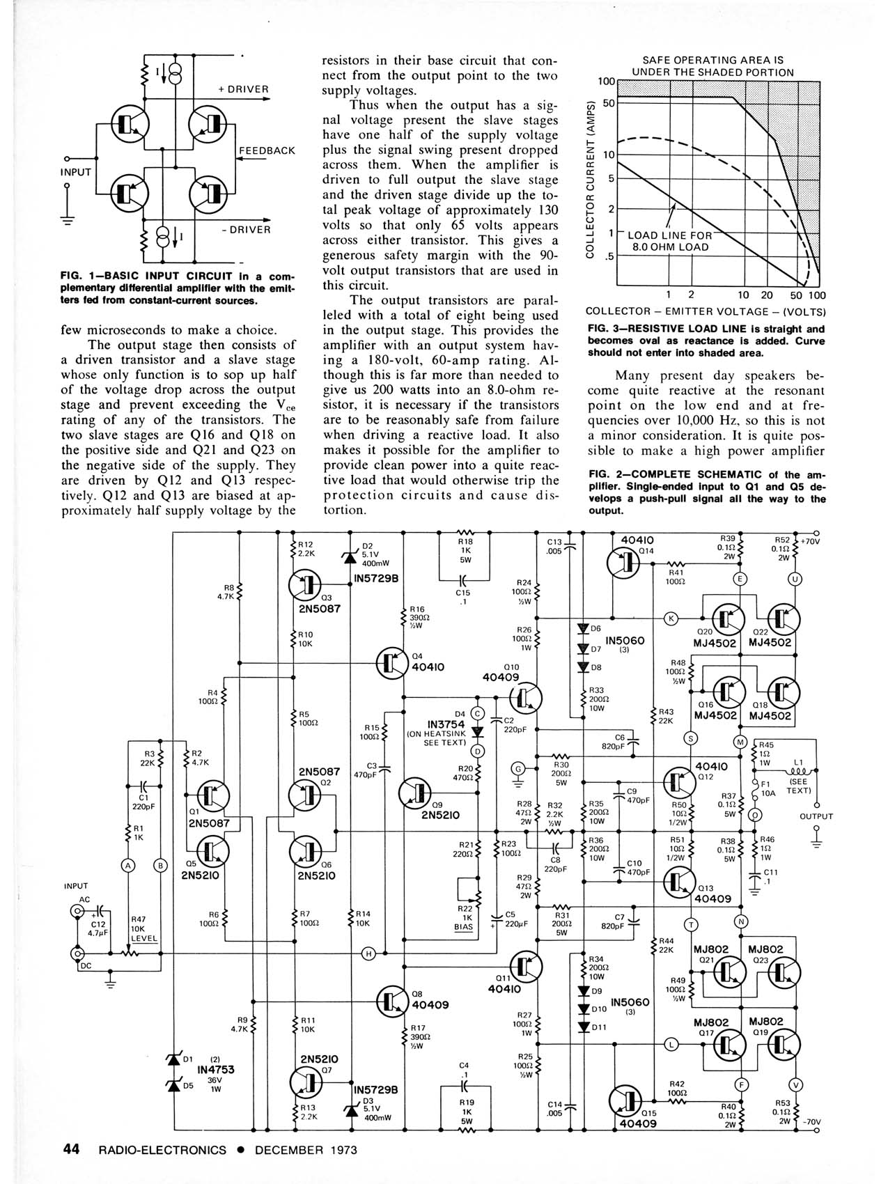

Here is the Tigersaurus schematic, it is CFP, but you can see that all the power transistors have 100 ohms from BE. The series transistors are just an EF2 so much lower divider resistors are required.
This is an interesting design. I had a couple of sims for a simpler version without stacked outputs and a single ended front end.
Would you have the whole article please? I only had that page plus the one with the pcbs on it, not the whole article.
Very simple protection. And with those beefy outputs, plenty of spare soa for the protections to act progressively and yet above legit signal.
Old devices, and yet, still manufactured by onsemi.
Besides their higher voltage, current and power handling, they're somewhat similar to the 3055s, perhaps a bit more gain, and a little faster.
A superamp version could be made with those too, and probably the 3055 based version could get those devices with hardly any changes.
Note how similar the front end is to the Bryston 3B, and the output to the Tiger .01.
Simple resistive loading, but those do have current sources, not the brystons.
Interesting stuff. That output stage with the turned around devices with their emitters towards the rails...

or above at full power or with square waves due to cross conduction failure? I wondered
how much better the newer devices are and read on here that someone ran an automated
test, probably at high/full power, that swept frequency. The MJ21193/4 blew when it got
to 200 KHz. I would stop at 20-50 KHz with newer devices.
MJ802 and 4502 look like big powerful parts but note that the constant power slope goes
to SOA limited at 50V. They are 50W parts at 50V whereas the 2n3773 for example takes
3A at 50V for 150W, MJ21193/4 are even better.
I believe that this was one of the failure modes for the smaller Tiger amps, at high power
levels with clipping, cross conduction happens, more heat then melt down.
I scratch built the Tigersaurus as a kid and it was the only Tiger that never failed, not once.
Have you seen my Tiger and Bryston simulations that show excessive reverse Vbe on the
driver transistors? If built as a Tiger .01 or Bryston style output stage a simple diode fix
seems to work in simulation.
